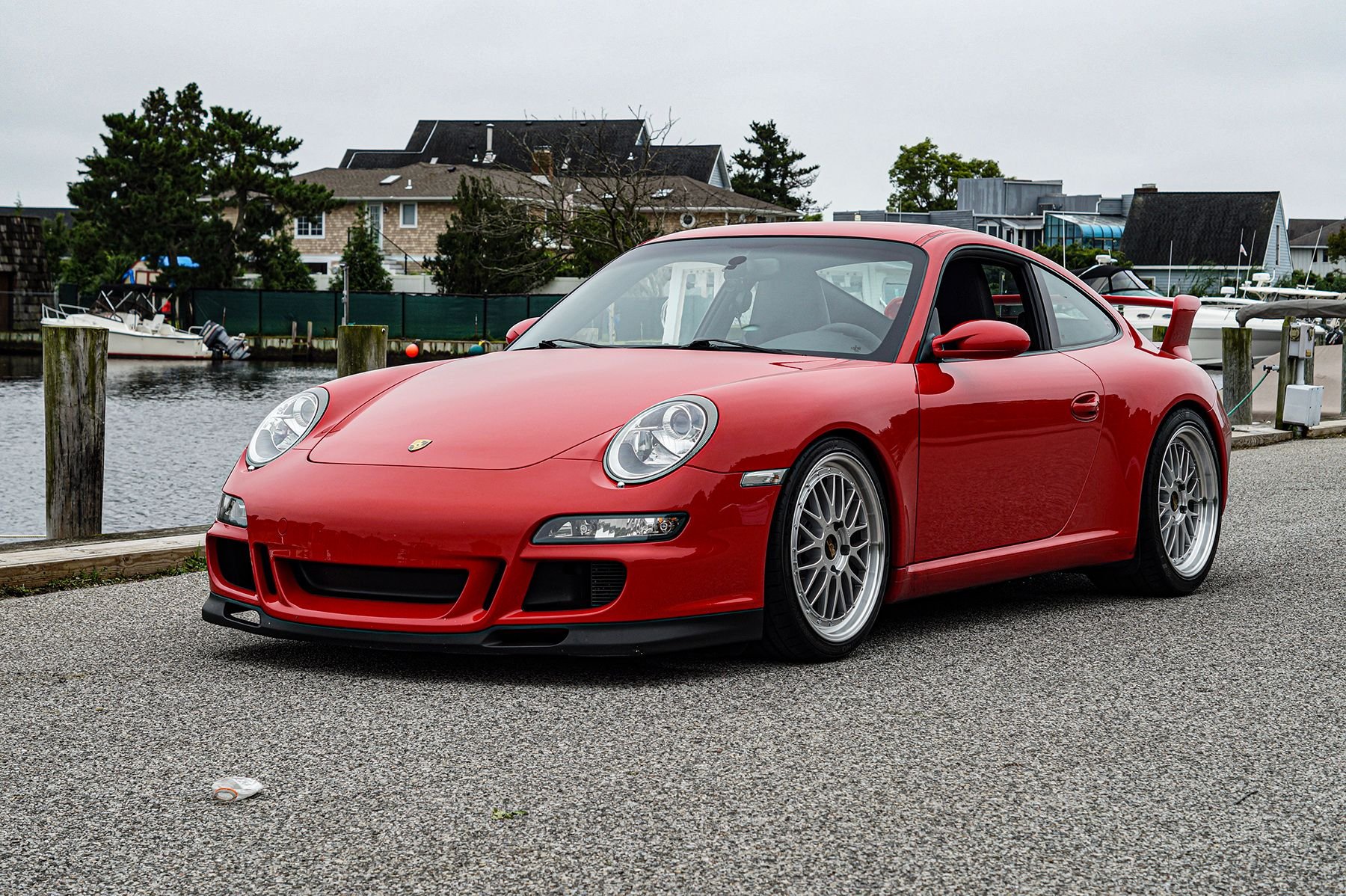

Currently on my NB I am running the following wheels:
19x8.5 Front 50MM ET
19x11 Rear 53MM ET
