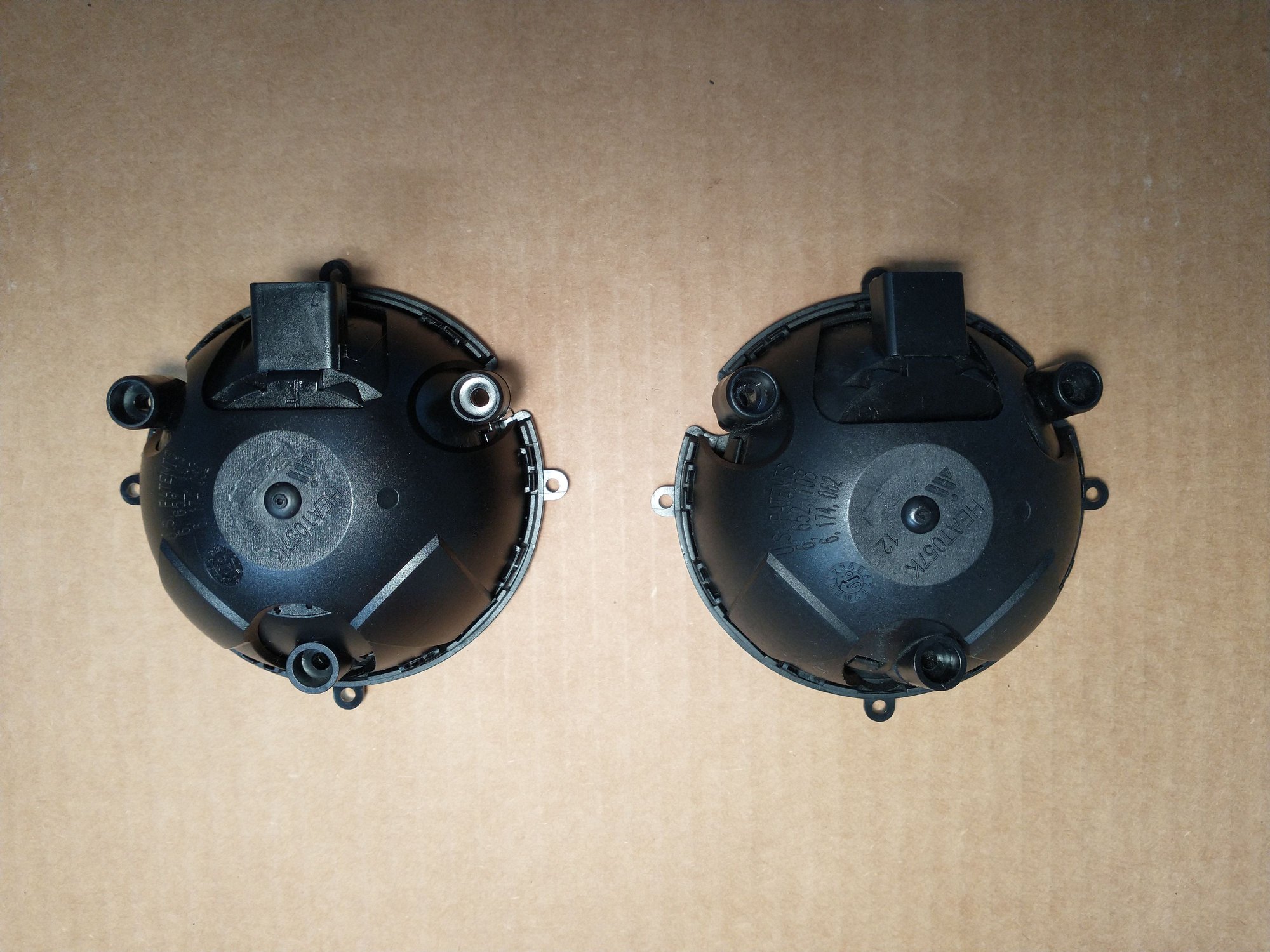

Old Oct 13, 2024 | 03:52 PM
0356kid's Avatar
0356kid
Joined: Jan 2013
Posts: 45
DC was out of stock so I purchased a new one from the dealer for about $175. Aside from the price, I tried replacing it today. Got the mirror and motor off within minutes. Went to install the new motor and noticed it’s a 3 pin connection while my old motor is 7 pin. I compared numbers on both motors and they seem the same (997-624-047-01 7E4adjuster). Either I don’t know what I’m doing or the dealer gave me the wrong motor. I did notice a number also on the back of the new motor HEAT0057K 22 and on my old motor HEAT0057K 21. Don’t know what these numbers mean though and if the 21 and 22 indicate a difference. Suggestion?

The GM mirror motor from Ebay has the 7pin connector and it’s under $30. I installed one to replace the mirror motor that failed in my 997.1.

From: DFW Texas
Porsche motor on left, Ebay motor on right

Retun it cause its the wrong connector and get the ebay one and a bunch oil or filters with the difference.
