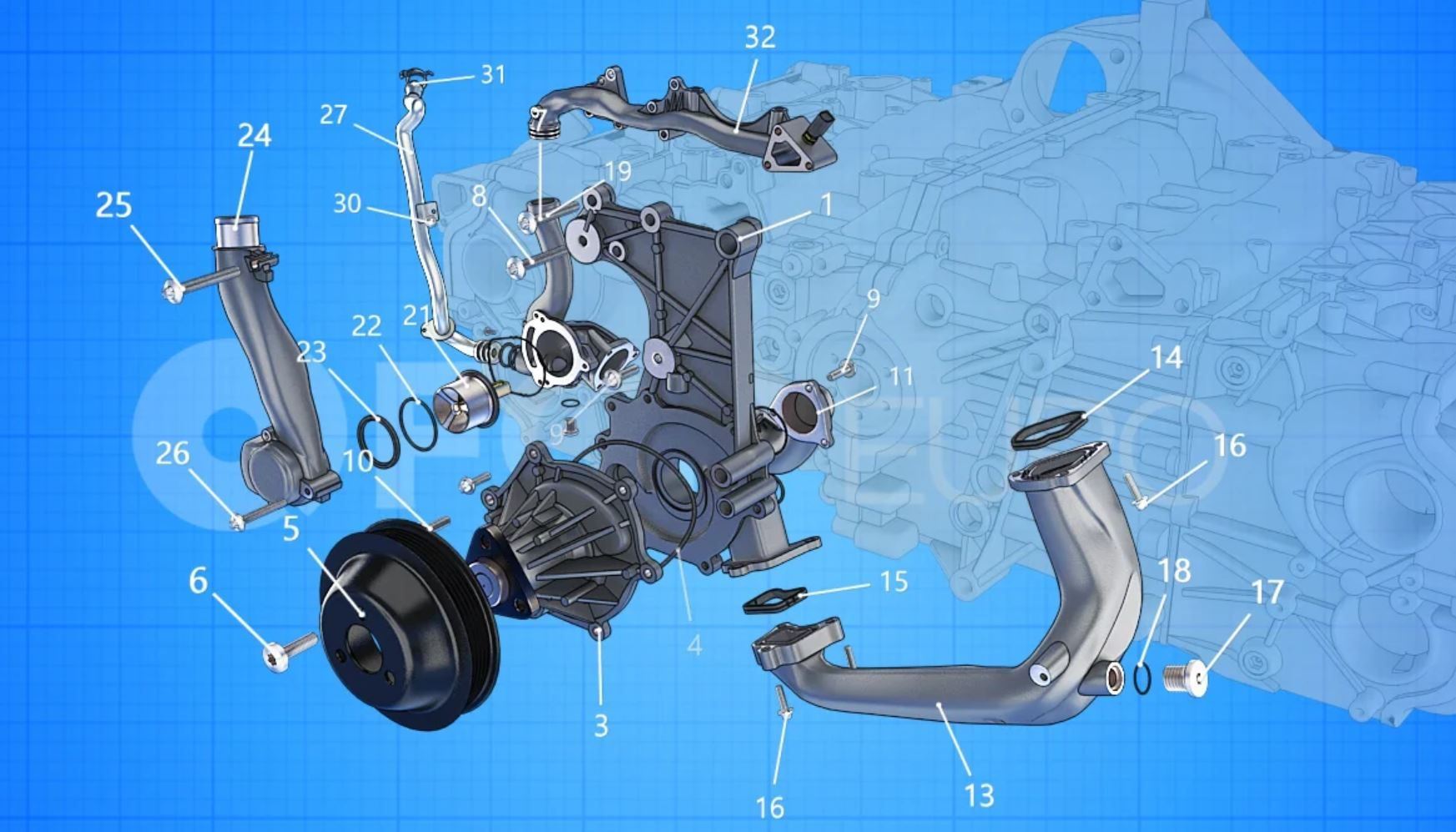

You're asking how to remove item #11 from #1 9A110603808? I believe you need to remove #1, but I don't know how to get to it.

Dr H, thank you for the diagram its actually pretty nice and really helpful. The shop manual looks like a 3 year old did theirs when compared to yours....... I dont know if that came out right!! Anyway I was afraid # 1 had to come off what a joke. I will crawl under the car tomorrow and see where this goes. Thank you Dr.
