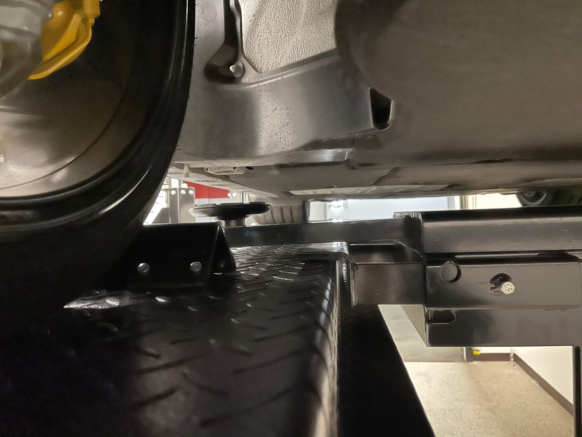

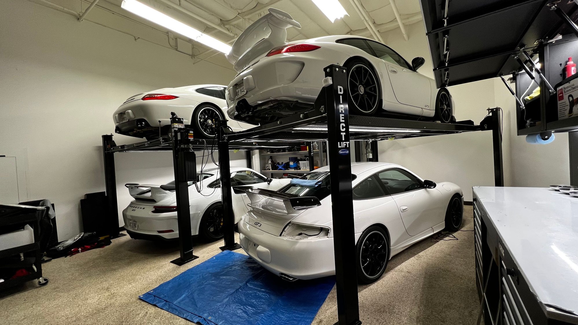

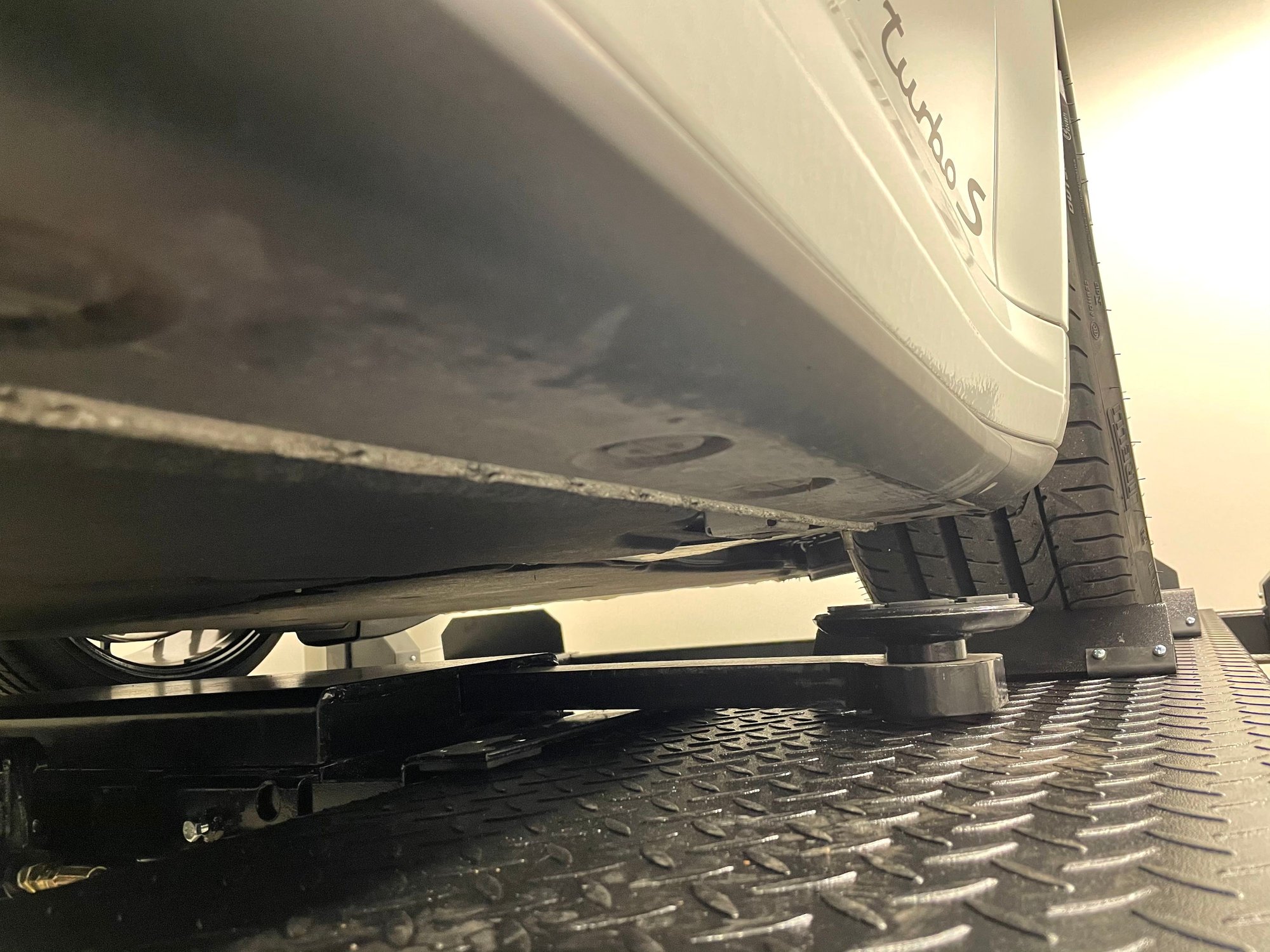

I have 2 of the Direct Lift Park Pro 8s in my storage facility.
Pros:
- manual mechanical locks; you don’t need compressed air
- direct lift sells a sliding bridge jack for maintenance — the arms are wide enough to hit the jack points on my widest vehicle (991.2 Turbo S). This is a huge plus, most other brand sliding jacks have short arms. In hindsight, I wish I had purchased 2 sliding jacks for each lift to get all wheels off the ground at once.
- relatively inexpensive and the US distributor has been easy to work with for parts, etc.
Cons:
- It’s slow to get to full height (motor is 110v) — but who cares…
