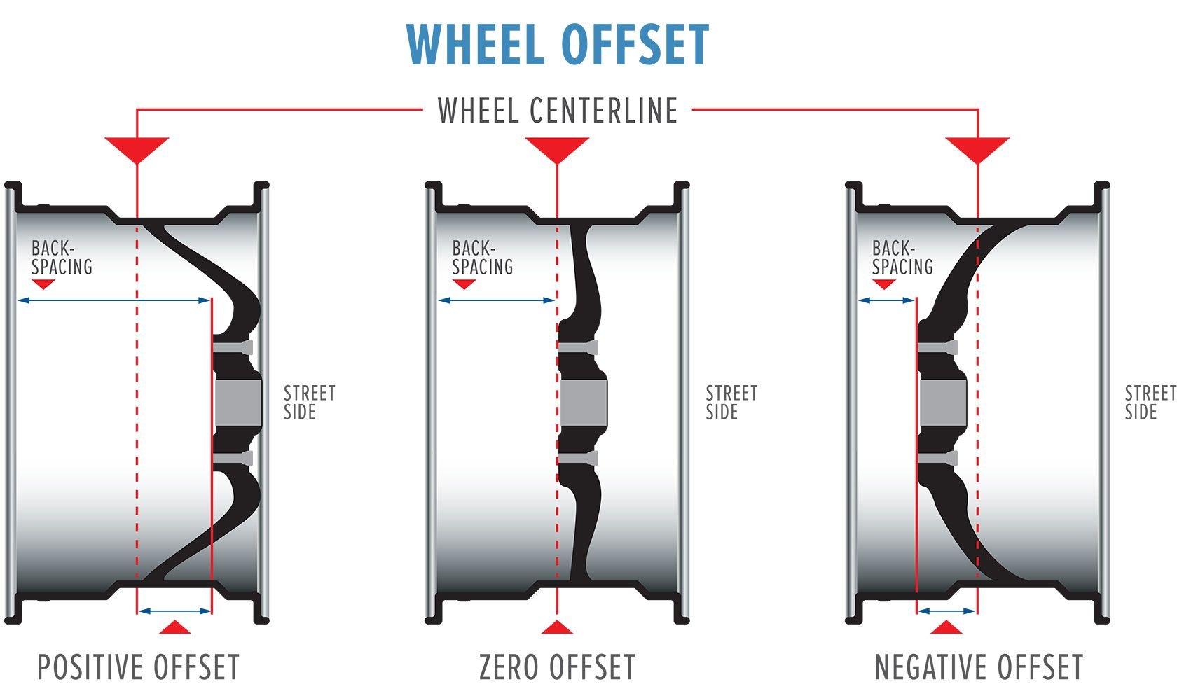

Offset refers to the distance relative to the centerline of the wheel. A positive offset means the rear face of the wheel (the surface that contacts the hub) is closer to the outer face of the wheel. A negative offset means the rear face of the wheel is farther away from the outer face. Based on this, you can estimate whether the wheels you are considering will fit or not. You just have to know what the current dimensions of your existing wheels are relative to what you are considering.
