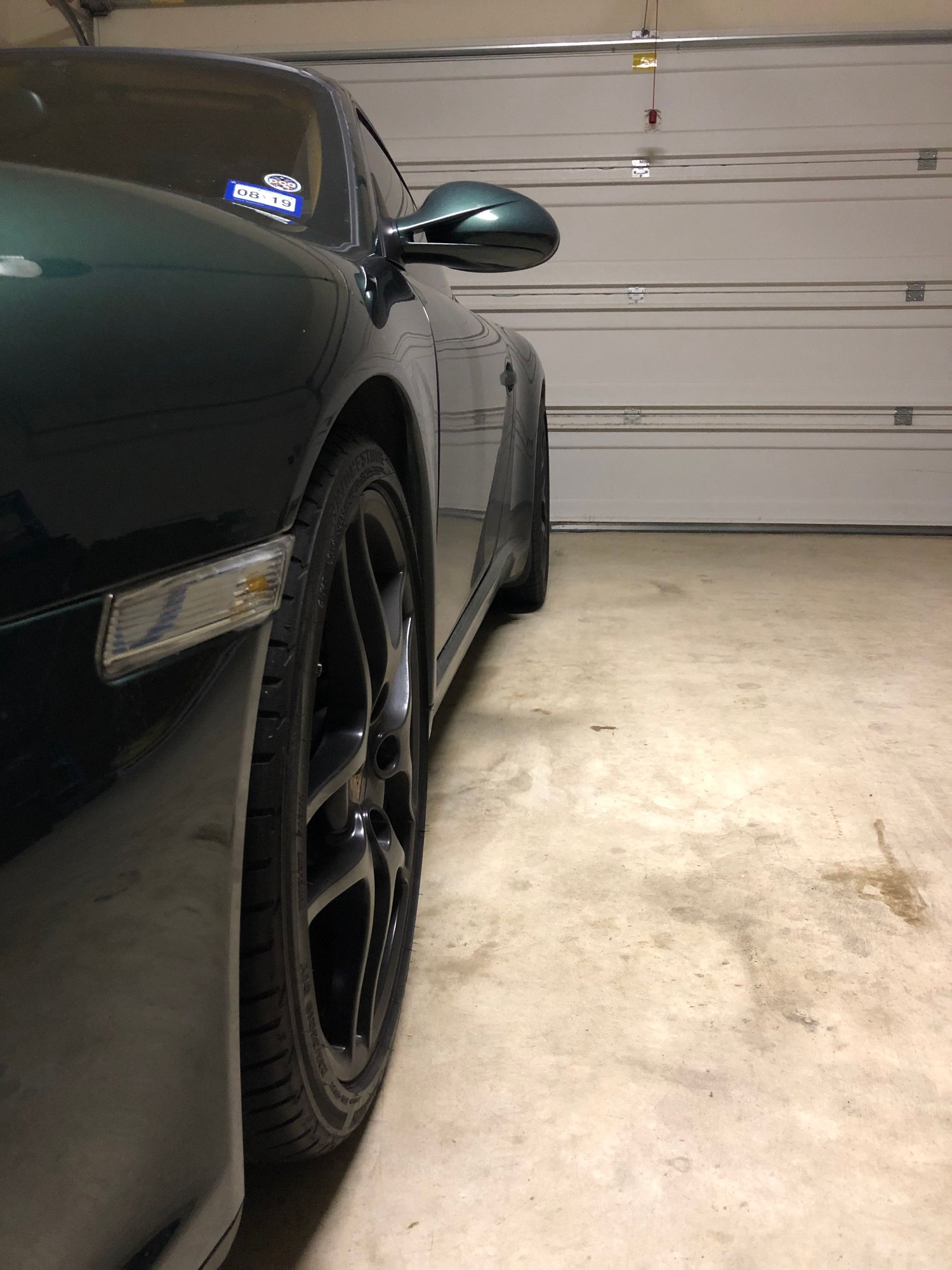

Here's some reference pics of the Carrera S II wheels with RSS spacers.
- Front - 8 x 19 ET 57 (ET 50 w/ 7mm spacer)
- Rear - 11 x 19 ET 67 (ET 52 w/ 15mm spacer)
You can go as aggressive as ET 47 up front without sticking out. ET 50 is as aggressive as you can go in the rear, though I think ET 52 is ideal.
