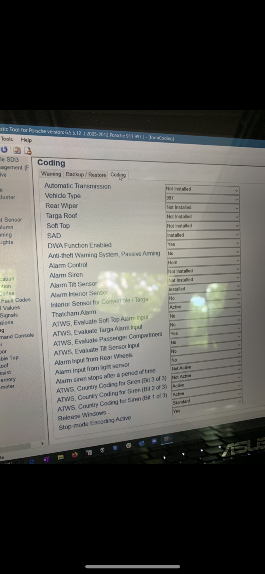

Recent heavy rainfall killed my rear control module. Managed to pick up a salvage unit for less than half the price of new, and so far it seems to be fine though I haven’t fired up the car nor driven it yet. The salvage unit came from a 987, and I’ve coded in the obvious choices for me car (standard Carrera spec spoiler). Question Is what are the defaults for the “function depends on...” fields? They are all currently ‘no’ but I would like to default them all to double check everything is functional on my car.

here you go

Thanks very much. Is there not another page of possible coding options though, especially the spoiler deployment functions? Thanks.

There are some more cut off in this picture but I didn’t capture them.

Thanks for the effort, I found another thread with some screenshots too so hopefully I'll be good to go soon. My purchase of the Durametric Pro version a few years back is proving to be a good investment!
