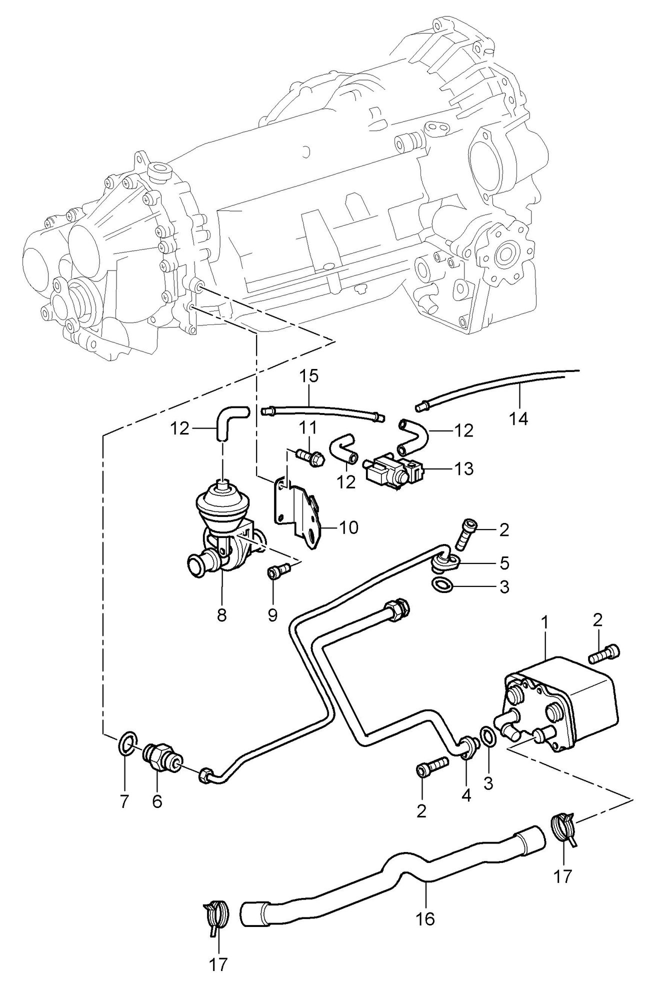

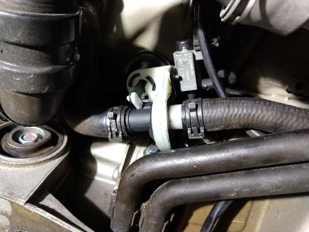

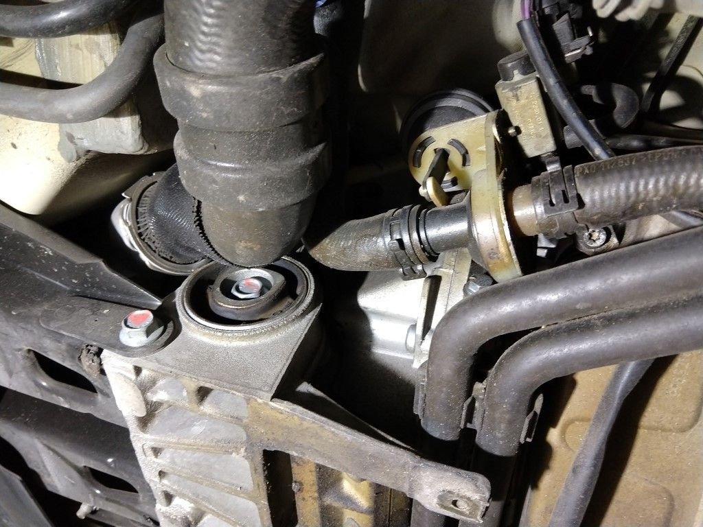

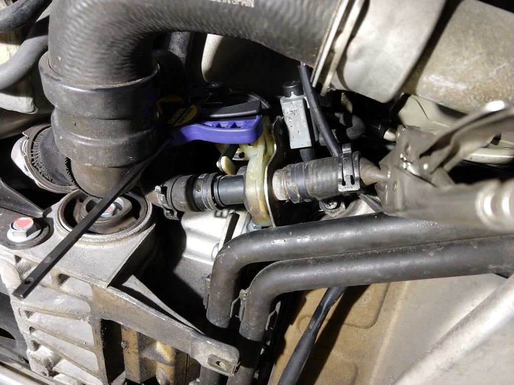

Update...I my earlier post I had the temps reversed - should have noted my water temp was showing normal but oil oil temp was slower to rise. I ordered a new Disc Valve (Item #8, Part #92857457303) and Change-Over Valve (Item #13, Part #99660512301) from FCP Euro ($60.77 total w/ tax + shipping). Finally had a break from the heat in DFW today (85 instead of 105) so I replaced both and did a 30 minute test drive with no codes. Took about two hours total including setup and take down of my Quickjack lift. Once the plastic cover below the transmission is removed both are easily accessed. Only lost about 2.5 oz of coolant which I topped off afterwards.
Old valves in place
Crimped coolant lines on Disc Valve
New valves installed
