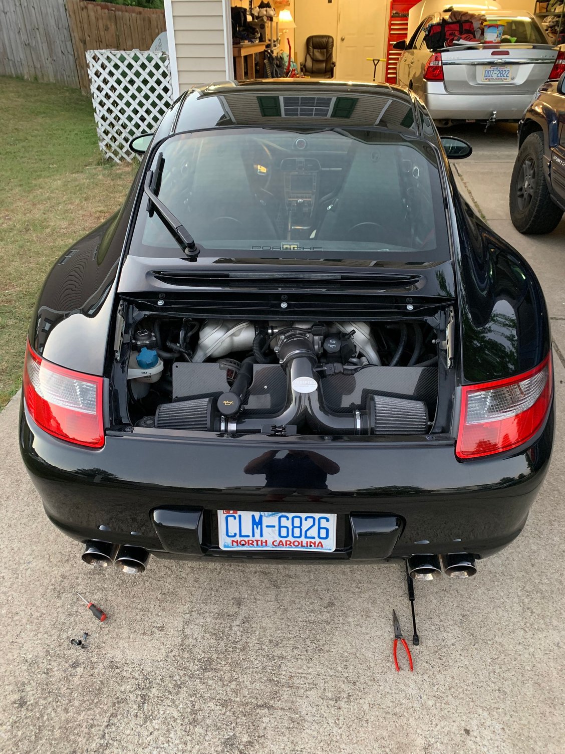

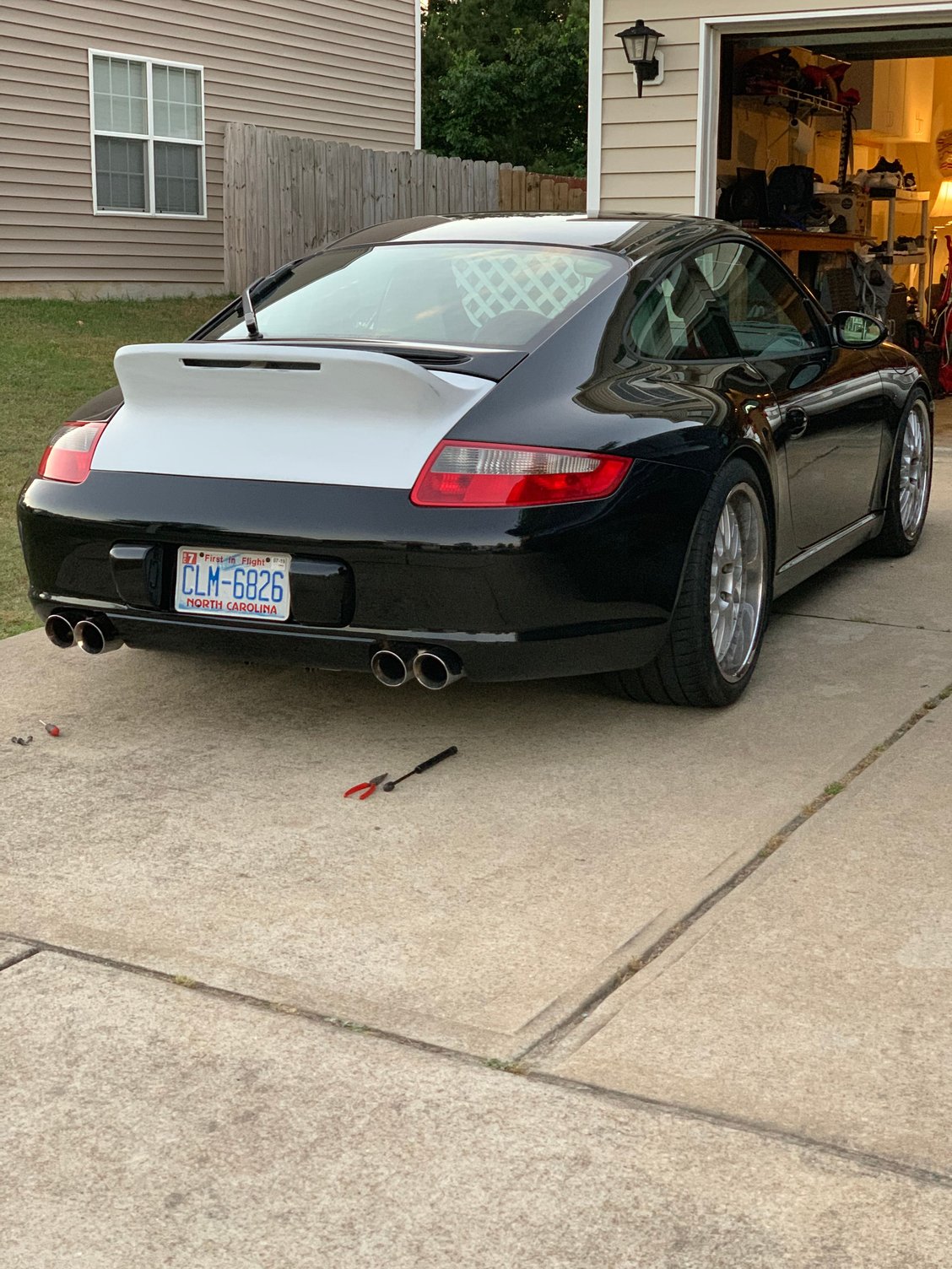

For my 997.1S all I had to do to test fit mine was remove the two screws on both hinders & unplug the wire on the right side of the car. Pro tip!!! If you bought a Getty Design follow the directions that were sent or call Mark so he can coach you to get to align up properly.
