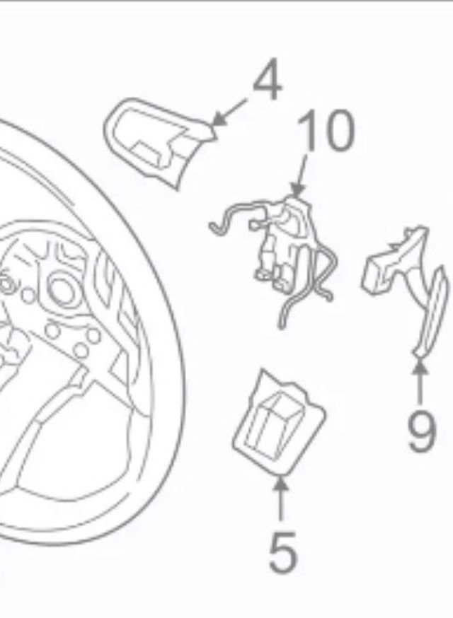

Originally Posted by rodH
Yes. A harness is required.
I wonder if that's what I'm missing. What harness are you referring to?
Old Nov 26, 2019 | 06:34 PM
rodH's Avatar
rodH
Joined: Dec 2015
Posts: 1,289
Likes: 155
From: Orange County
there is the wiring and a harness. Here is what they look like together. The diagram picture #10 is the part that we are talking about but without the wires. I think it is a $70-80 part. When I got my new airbag, it happened to come with it, but that is highly unusual.

My wheel came with the harness as pictued (at least I recall it looking the same). I'm being told by another porschephile hat I might need a new steering wheel control module to make it work and it's expensive. That being the case, I may be without a function horn, which just means I'll need to yell louder.

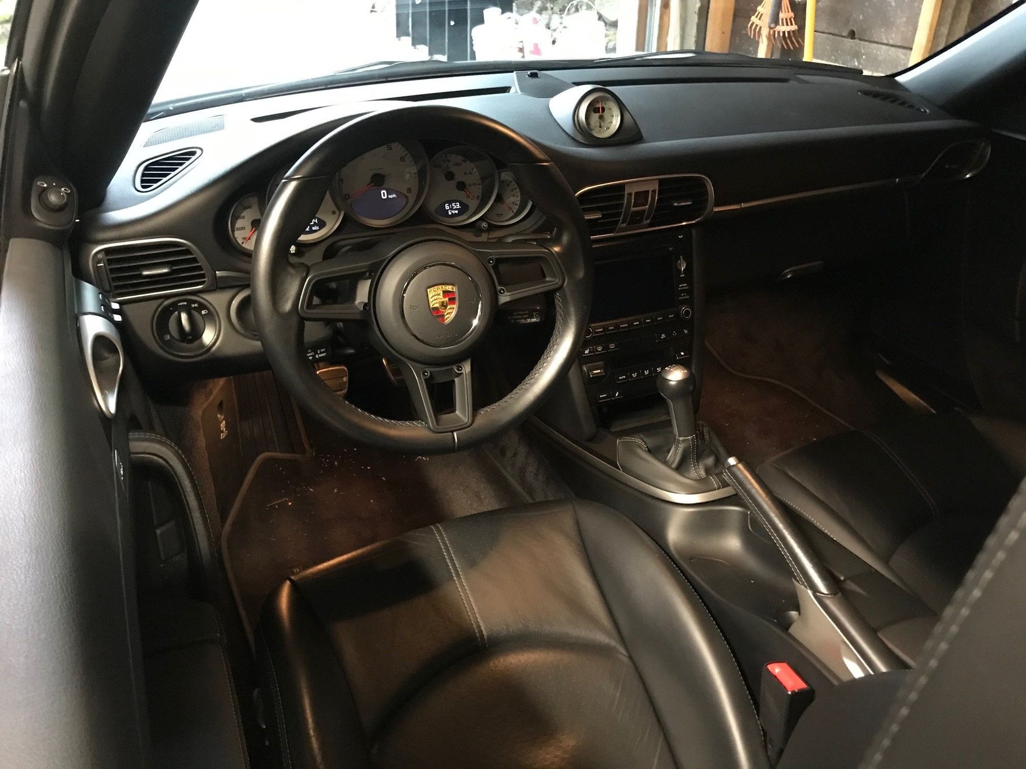

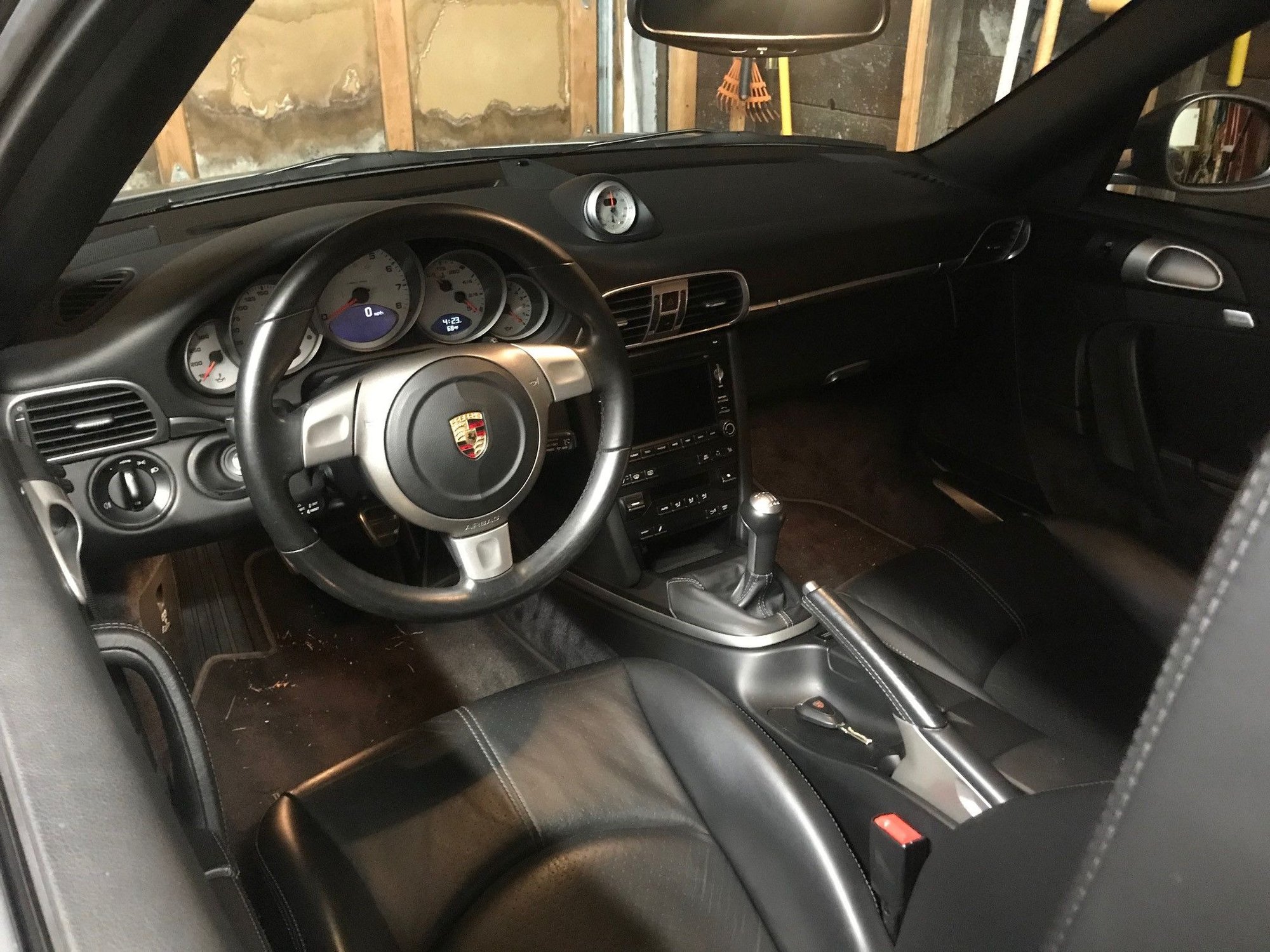

Hey all, I've got a '09 C4S and switched out the stock steering wheel for the newer look 3 split-spoke model. The new wheel was multi-function but I removed all the MF parts (controls, shifter stalks, etc.) and replaced the shroud. I'm very happy with the new look but the horn doesn't work. I had been told that all I'd need to do is update the software to tell the system that a multi-function wheel had been installed and it would work. More specifically, using PIWIS or a durametric, there is a MF steering wheel installed/not installed option under the gateway module and all I'd need to do is change it to installed. I was at the dealership this week and they took a look, reporting back that there wasn't an MF option that appeared under the gateway module for my car. Any steering wheel / software experts out there with ideas on where to look next?
Thanks for any help!
Original wheel
Updated wheel
