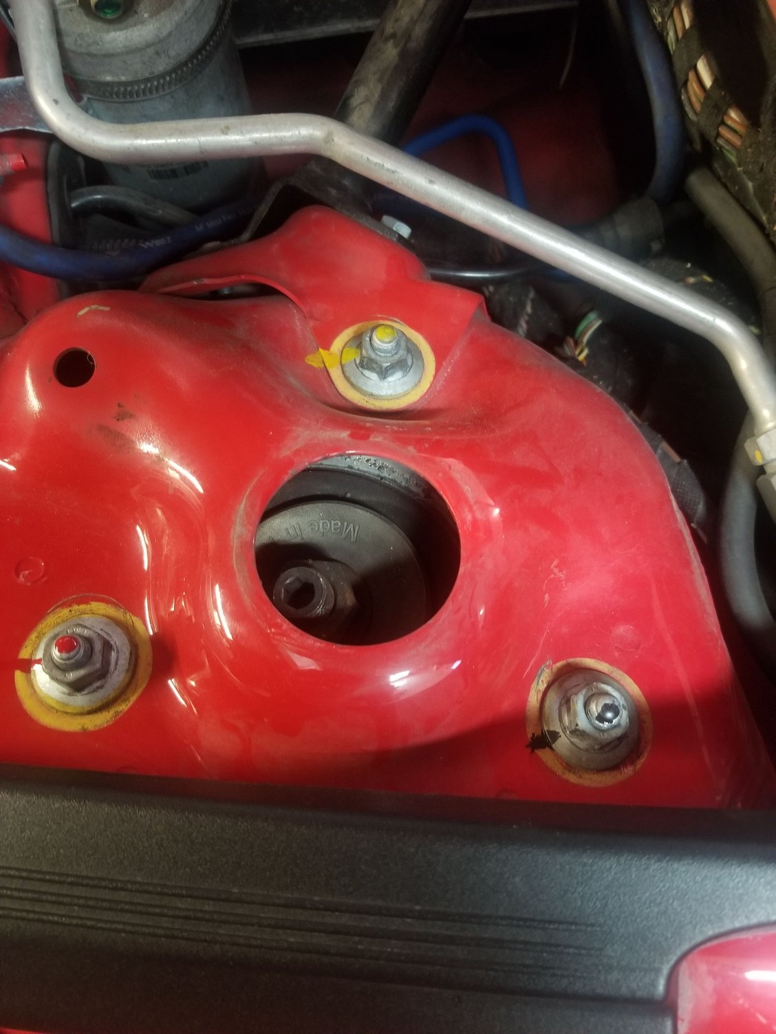

Well, as I am anxiously and nervously embarking on this adventure, it wasn't very long (which is a good thing I guess) until I encountered my first problem.
The strut mount bolt is not centered in the whole and I can't slide a nut on it to dismount. Even an open box wrench won't fit because the whole is too small to even turn the nut.
Now what??? Take the whole assembly off by freeing the 3 bolts that hold the strut mount plate??? If so, how will I be able to free the top bolt ???

Remove the whole assembly and use a spring compressor. You can unto those 3 top nuts.

Take out the whole assembly by removing the three bolts. Then you use a hex to hold the the shaft from spinning and use a wrench to loosen the nut (while spring compressor is holding the spring compressed )
