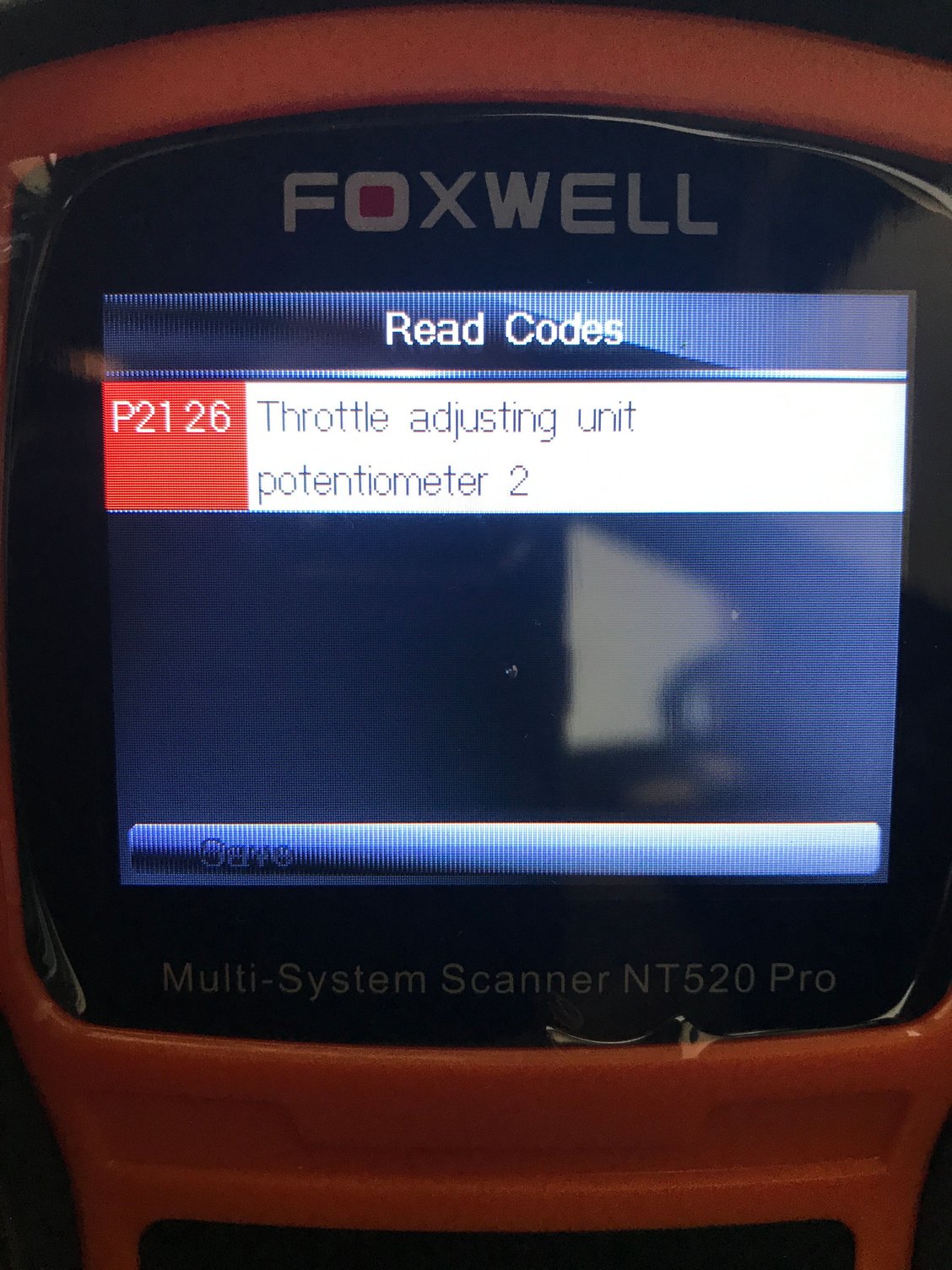

So the throttle body came in . I ended up purchasing a foxwell nt520 with preinstalled Porsche software . It has the ability to do a TBA (throttle body alignment ) and clear the pending P2126 Throttle/ pedal position sensor, "E" circuit range code .
I'll wait to install the TB till I receive the nt520 . Just want to play around with it a little before starting it up with the new TBand clear everything .

Ya . I just couldn't drop the 800 for the dura metric . But I can use the foxwell on other vehicles as well . Can't beat it for 160 bucks .
So the foxwewll nt520 came in and I got right on it ...Pulled the same code you had present ,, p1226 valve adjusting unit - potentiometer. So the nt520 did its job .
Yes that's the information Ive gathered and also that you will hear a click as its resetting with the key.. Im thinking of getting pro active and change out the pedal potentiometer as well

Well I installed the new throttle body today , and did my first oil change on this car since i purchased it in January . So everything went well and the p1226 error code cleared ! hopefully thats the end of it . I saved myself some good cash doing it myself . The TB cost me just under 180 bucks with a lifetime warranty , cant beat that .
