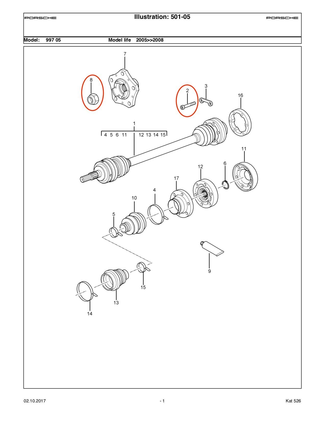

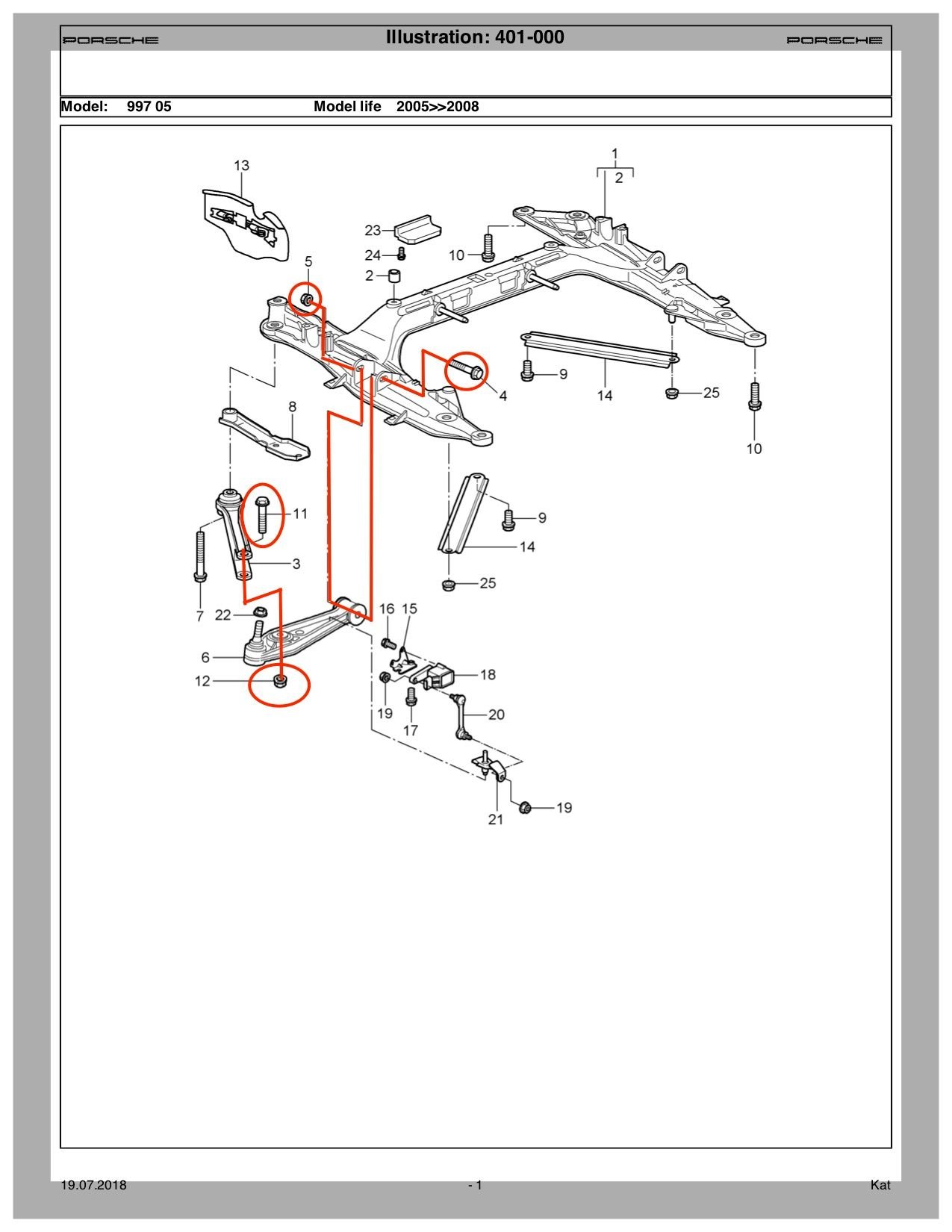

Looking for some torque help here - see attached. Thank you in advance

Front suspension
Wishbone to frame (4): 89 lb-ft
Tuning fork to wishbone (11): 118 lb-ft

Thank you! Do you know the other one? I think I found that big castle nut
I'm sorry, I don't. I didn't have to remove those other ones for the switch to coilovers.

normally all are same as the bolt size torque, look up bolt torque chart
