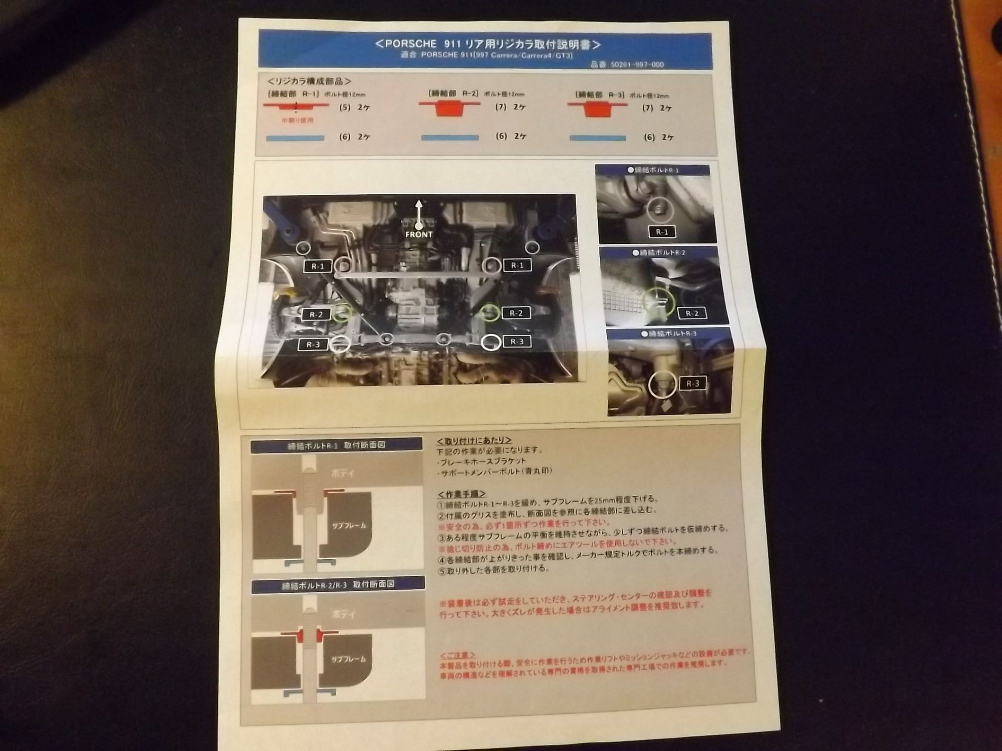

Hello Everyone,

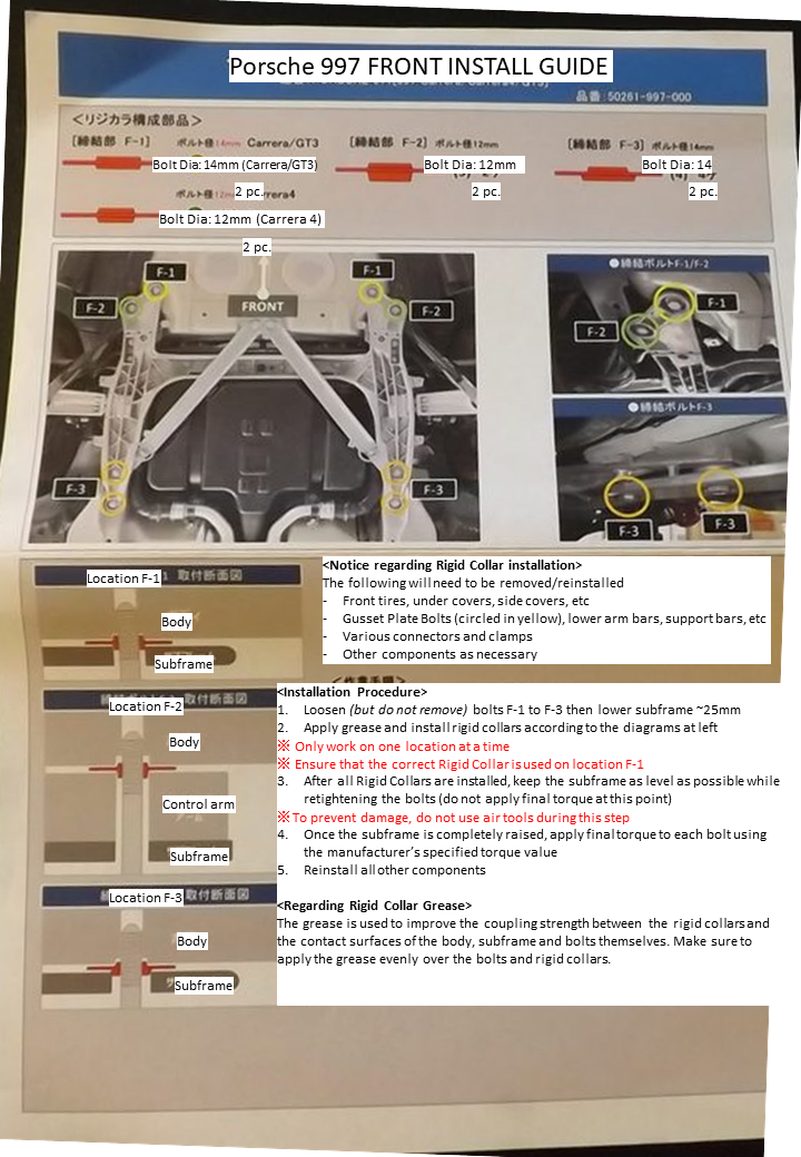

I've been sitting on a box of Spoon Rigid Collars I purchased on a whim on ebay. I am going to put them in sometime before the 14th. For anyone who decides to purchase them they may or may not be surprised to find the instructions in Japanese. A fantastic board member named "bc" on the Car Lounge translated the instructions and has given permission to share with the community here. I hope it'll be useful for anyone considering the parts. I'll update with my impressions after they go in.
bc says: "grease coast all contact surfaces between rigid collars and chassis"

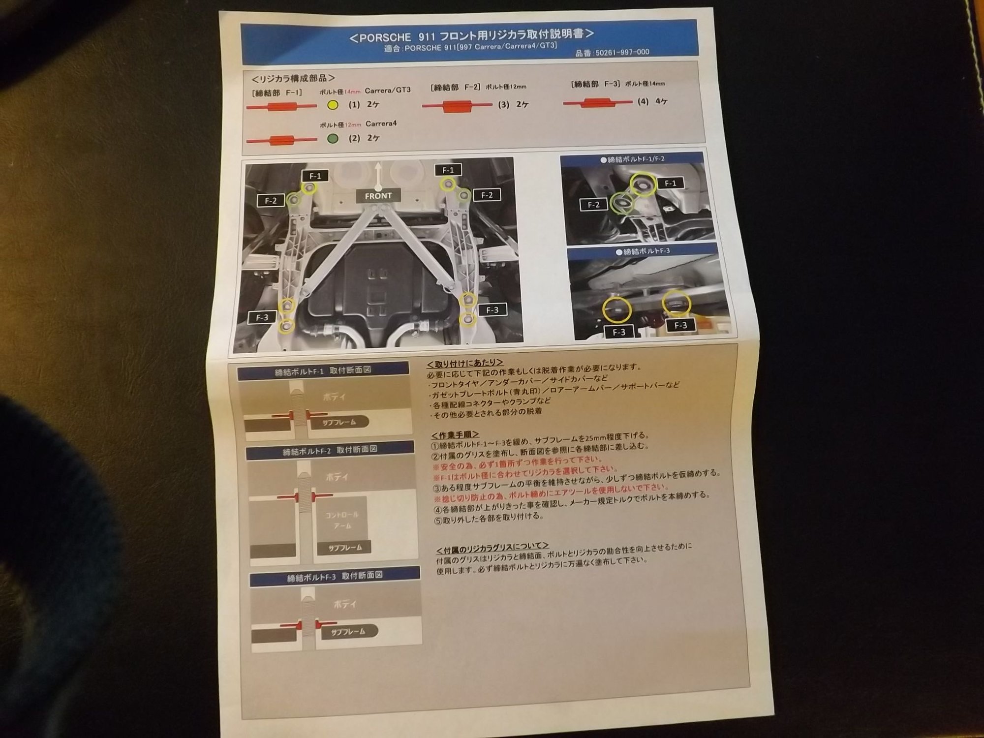

I have not experienced any subframe chatter or movement that I'm aware of and my alignment is still good after a weekend at the track. We aren't fixing anything broken here. This was a spur of the moment ebay purchase. Call it a lost opportunity with the S2000 righted with the 911. The install is easily DIY and the kit was around $280 or so, which is relatively economical as far as Porsche parts go so what should anyone expect from them... It'll make for a fun Saturday project with friends in the garage, money well spent as far as I am concerned. I posted the pictures and instructions for posterity for the community should anyone else decide to go this route and not understand the supplied instructions.
