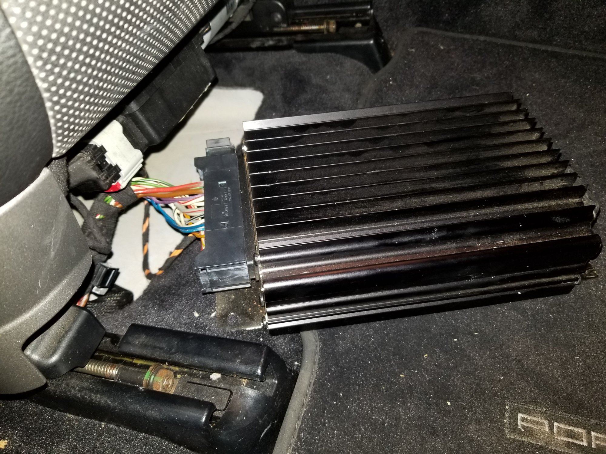

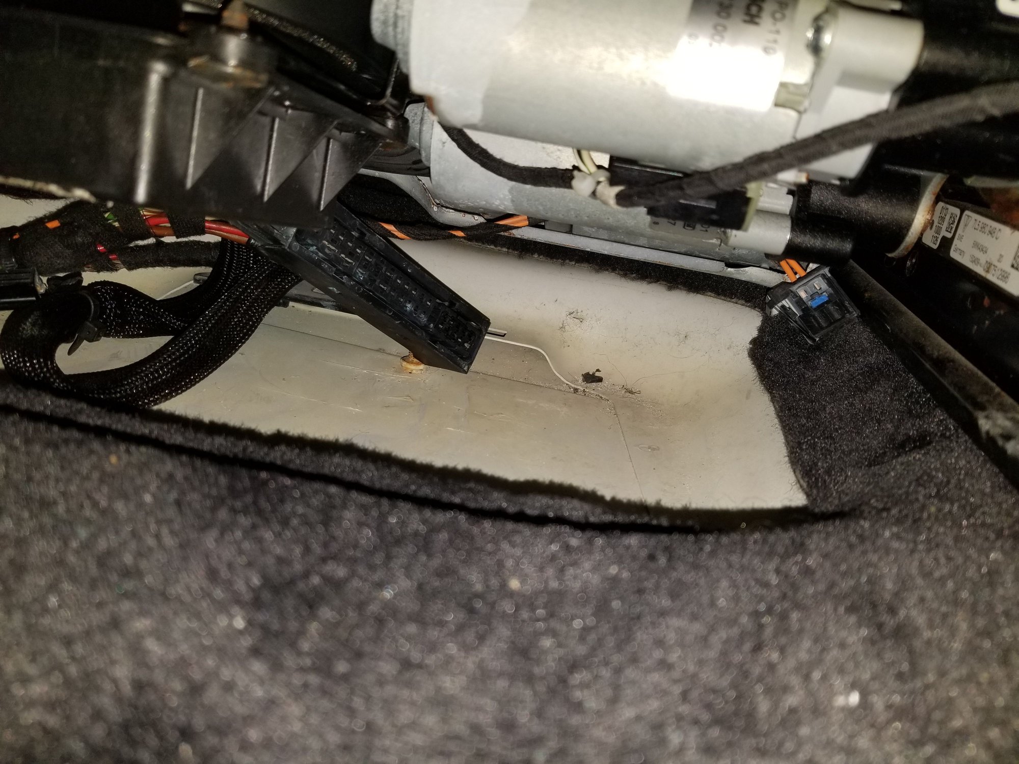

I think I found out why there is no sound.
Now I need to figure out how I can proceed. Manual says something is to be uploaded from the PWIS before replacing. Can I just get another amp from a recycler and install it?

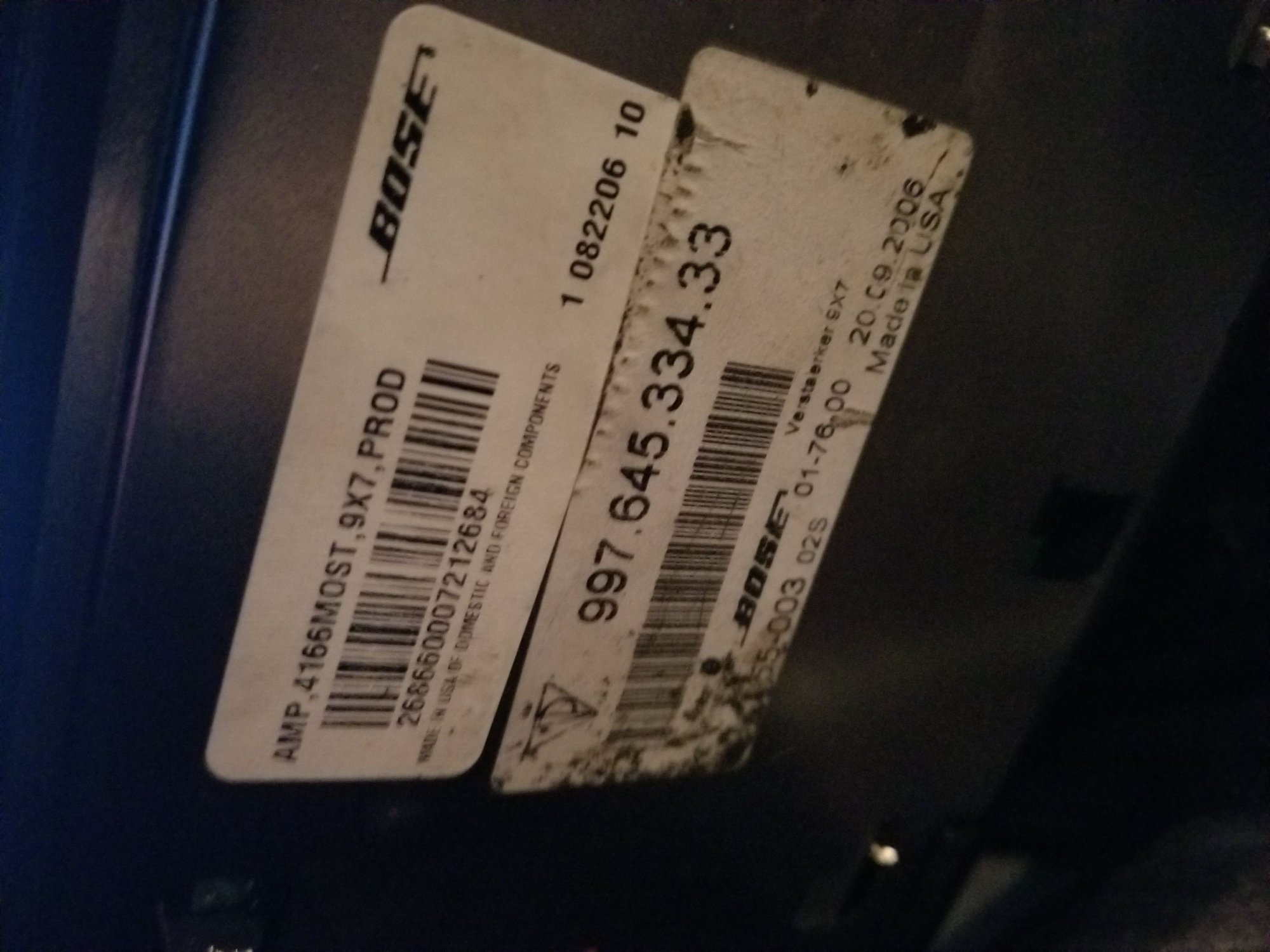

Now I'm looking for more help. I received an amp which I was told was compatible with my 997.2 but I am not sure. Can someone shoot me a picture of a Bose amp setup under their passenger seat. The amp I received is not on the list on the PET (997 645 441 01 or 997 645 442 00) for 2009-2012 997s. The main harness and a smaller harness connect but the amp has three connections and my car only has two connectors. Additionally, I am not sure of the orientation of the amp under the seat. The mounting holes don't match and when I place it in loosely it seems that the seat hits it when I move the seat all the way down and forward.

Checked and found the amp that was sent is for a 2005-2008 997. They didn't give me the part number before I bought it but said it was for a 2009 997. Now I have to return it and start over. Frustrating, but I knew I should expect some of this.
