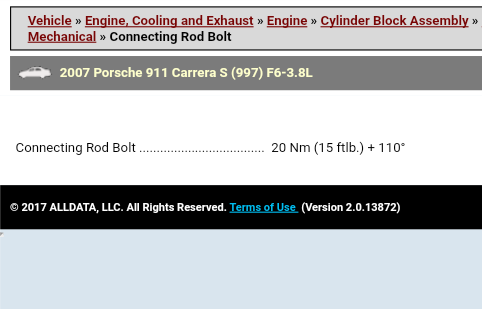

Can anyone tell me the rod bolt torque setting for OEM Porsche rod bolts on a 3.8 M97?

Old Dec 17, 2017 | 10:11 AM
Ptech1's Avatar
Ptech1
Joined: May 2012
Posts: 347
Likes: 83
