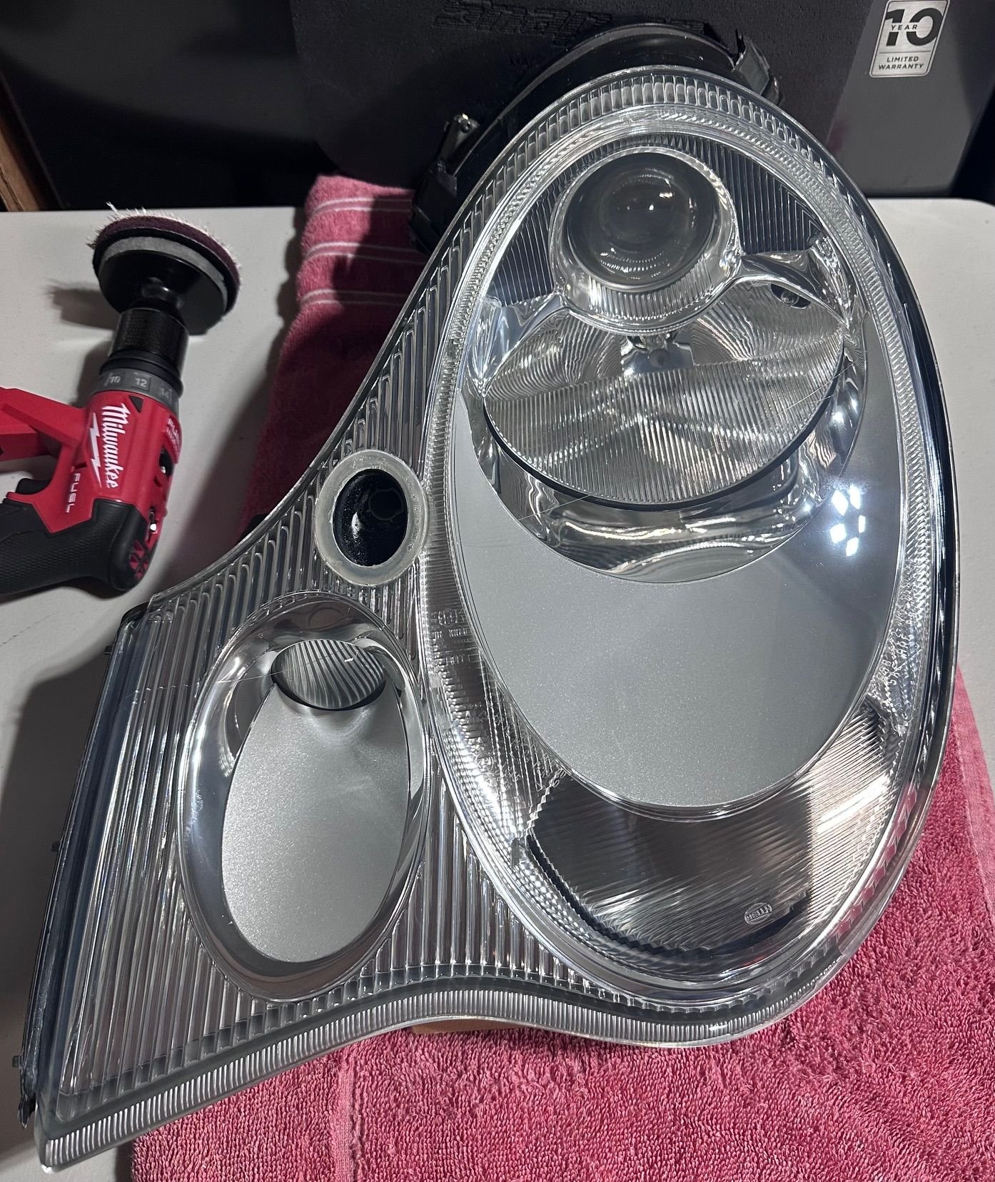

Thanks for the link! just restored my headlights but these were all dry rotted and crumbled. Didn't think this existed.
If anyone is interested in the step:
Sand-
500 grit
800 grit
1500 grit wet
sprayed 2 coats of spraymax 2k
Sand-
1000 grit wet
1500 grit wet
3000 grit wet
Polish-
Meguiars 105 with MF pad
Meguiars 205 with MF pad
Glaze
Wax
