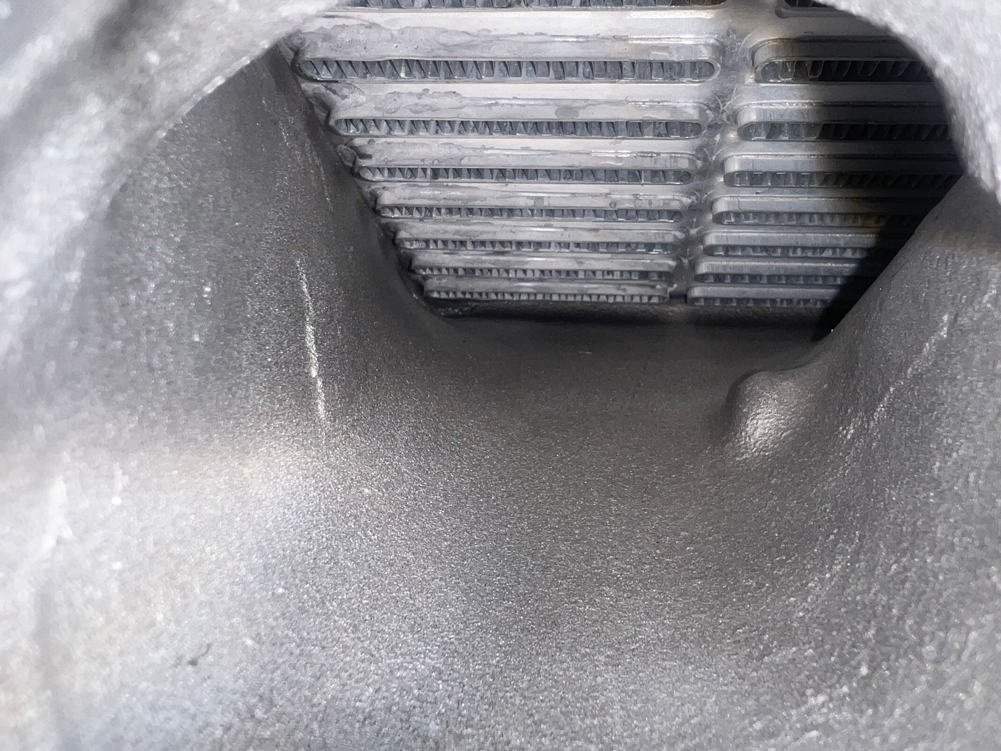

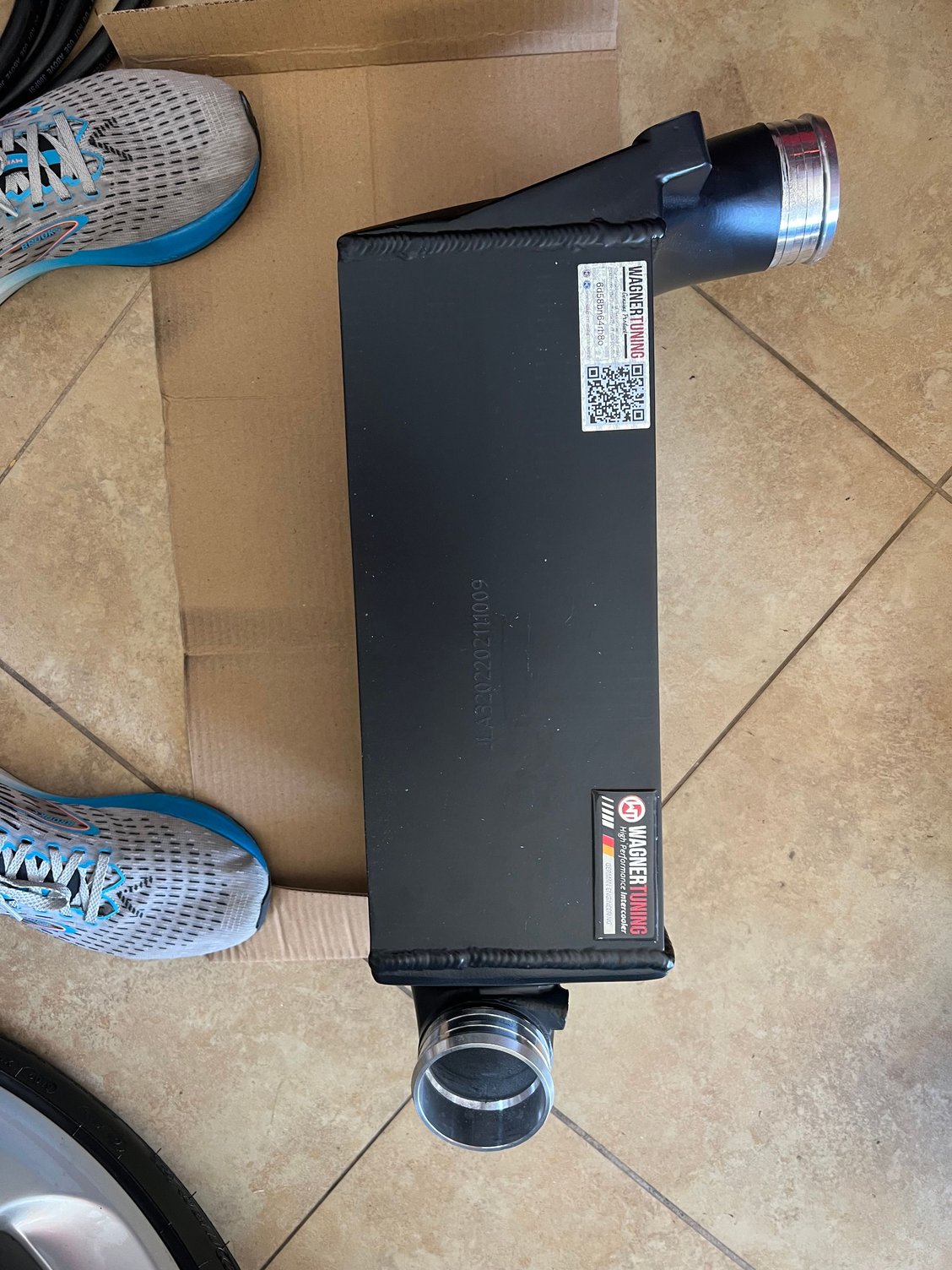

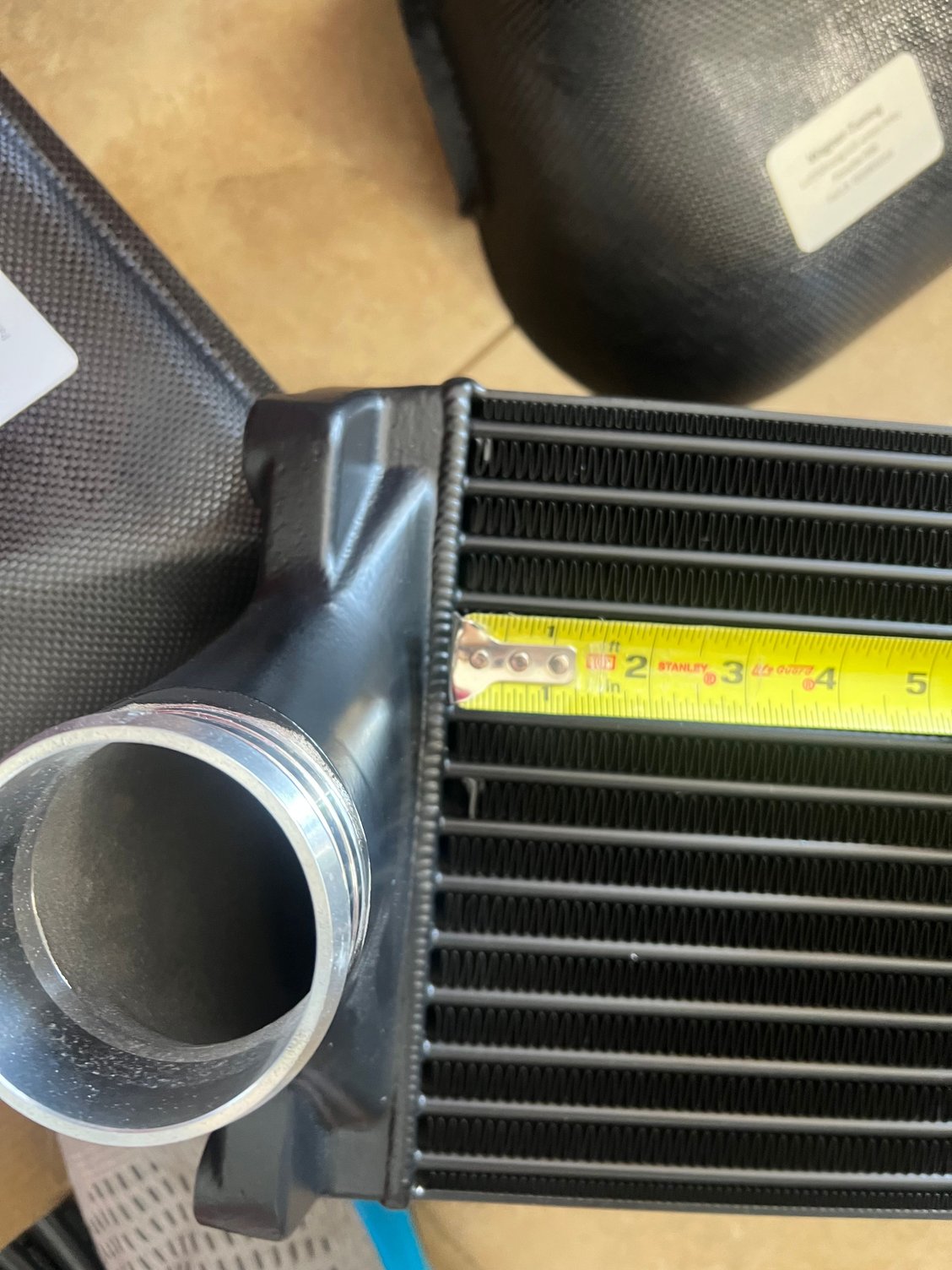

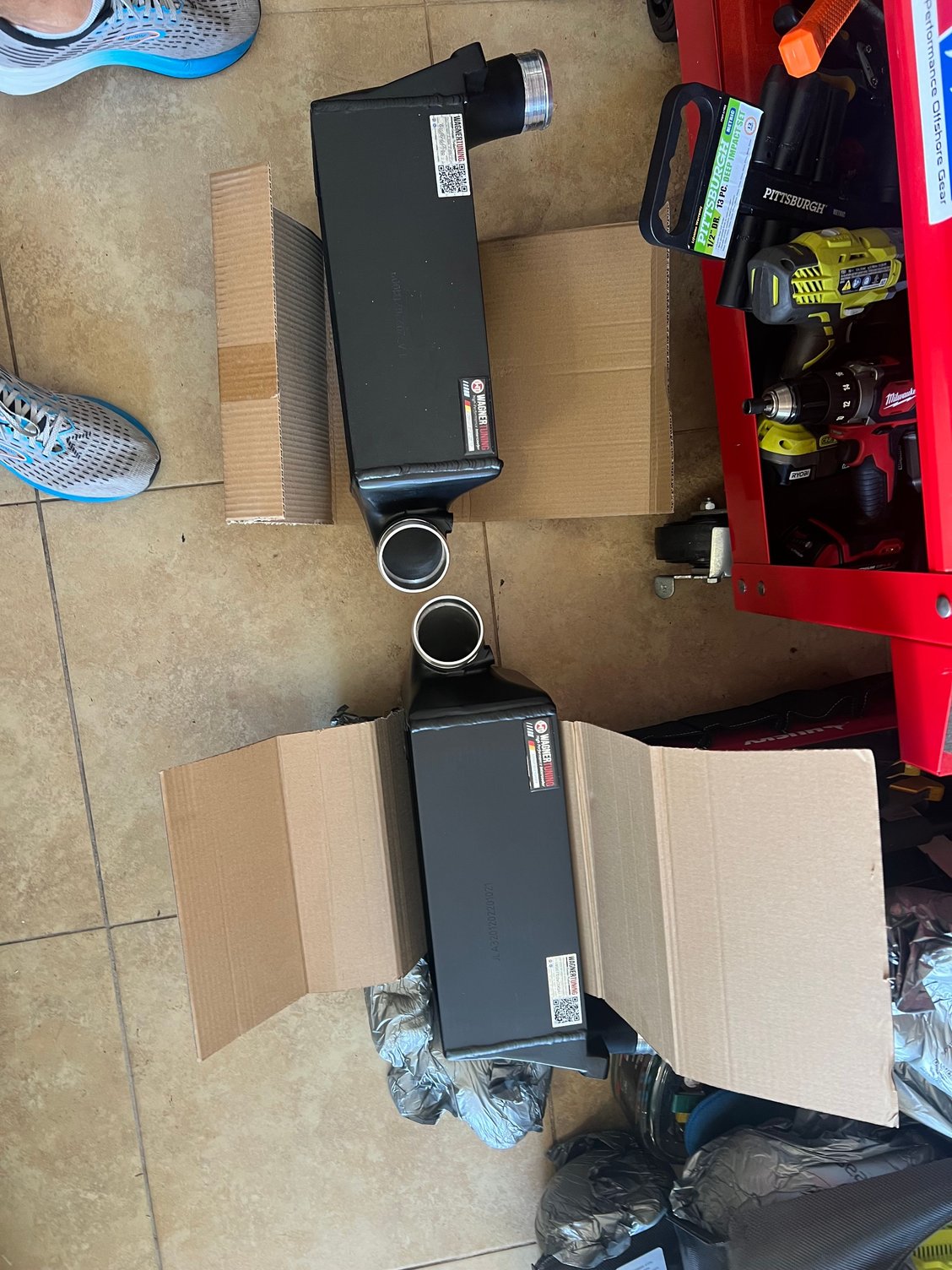

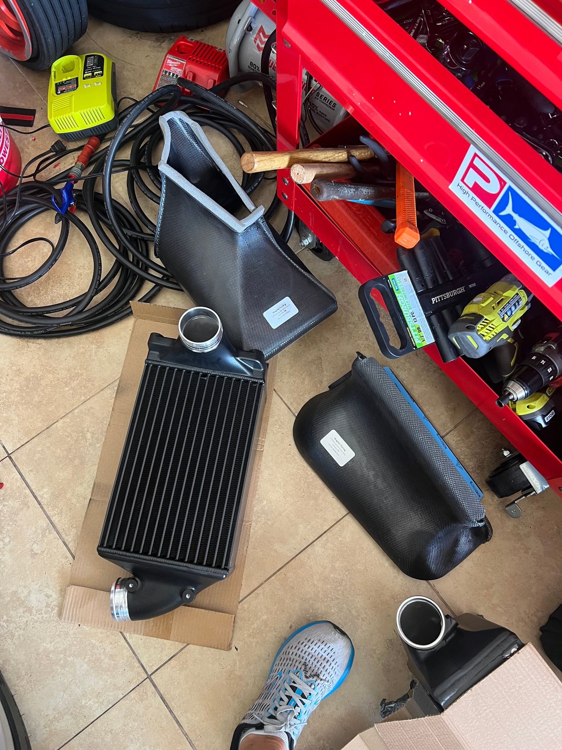

Post weight of the intercooler and a side by side picture of core compared to OEM.

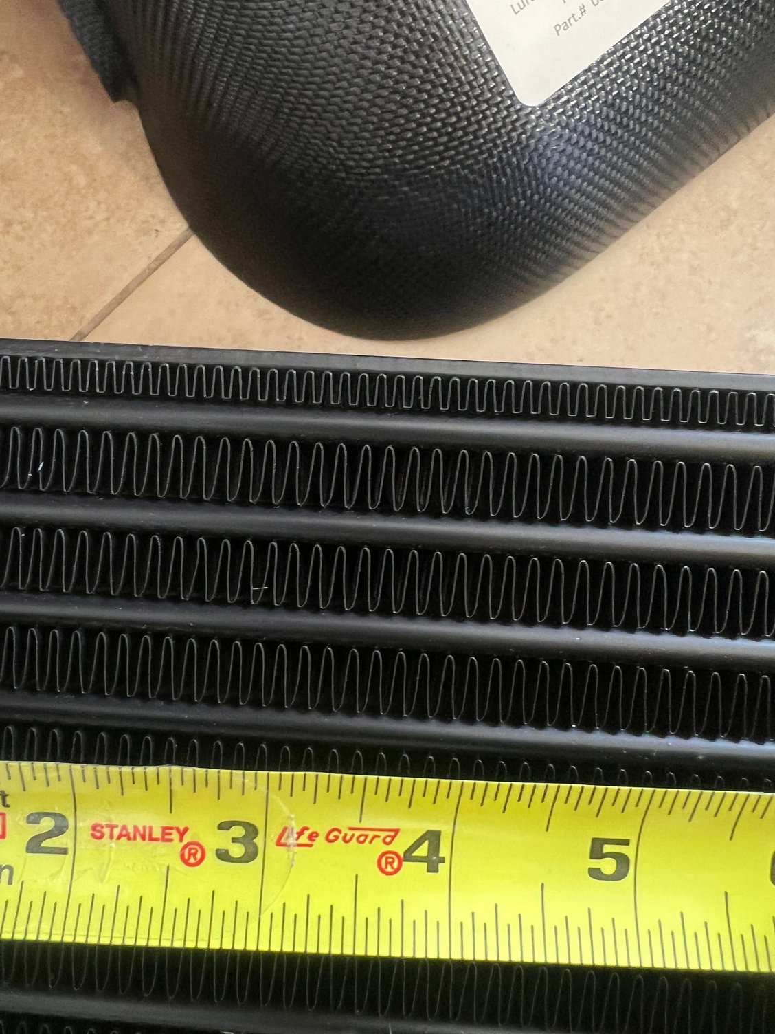

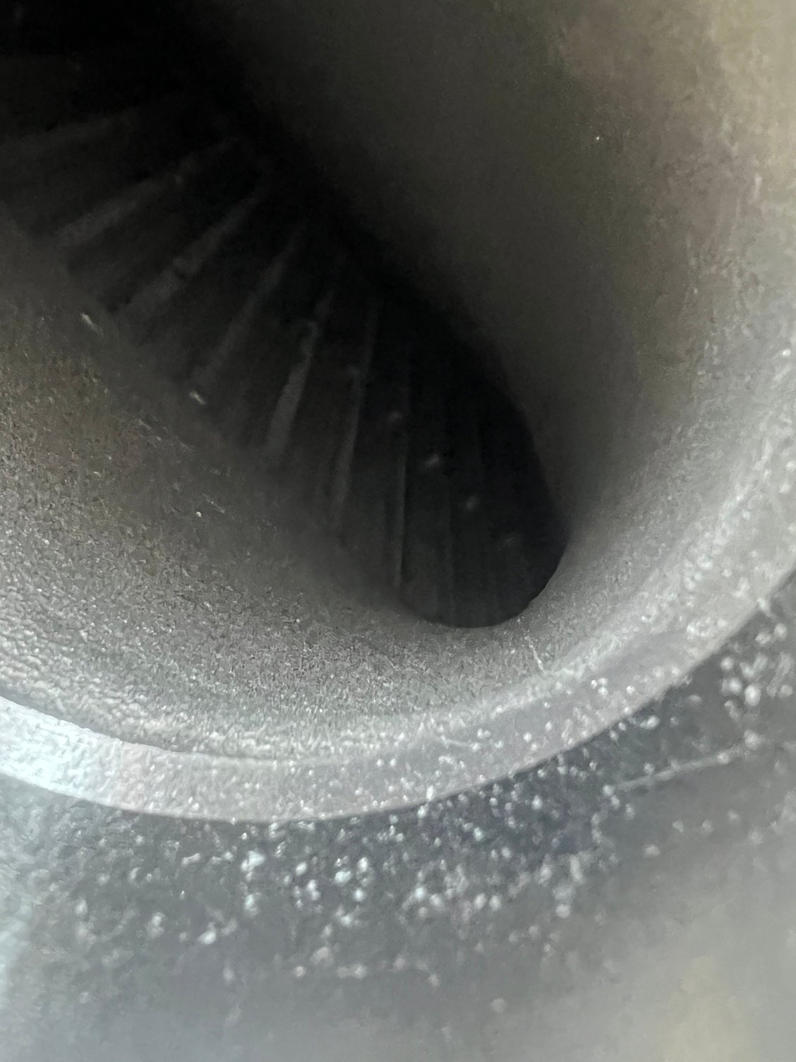

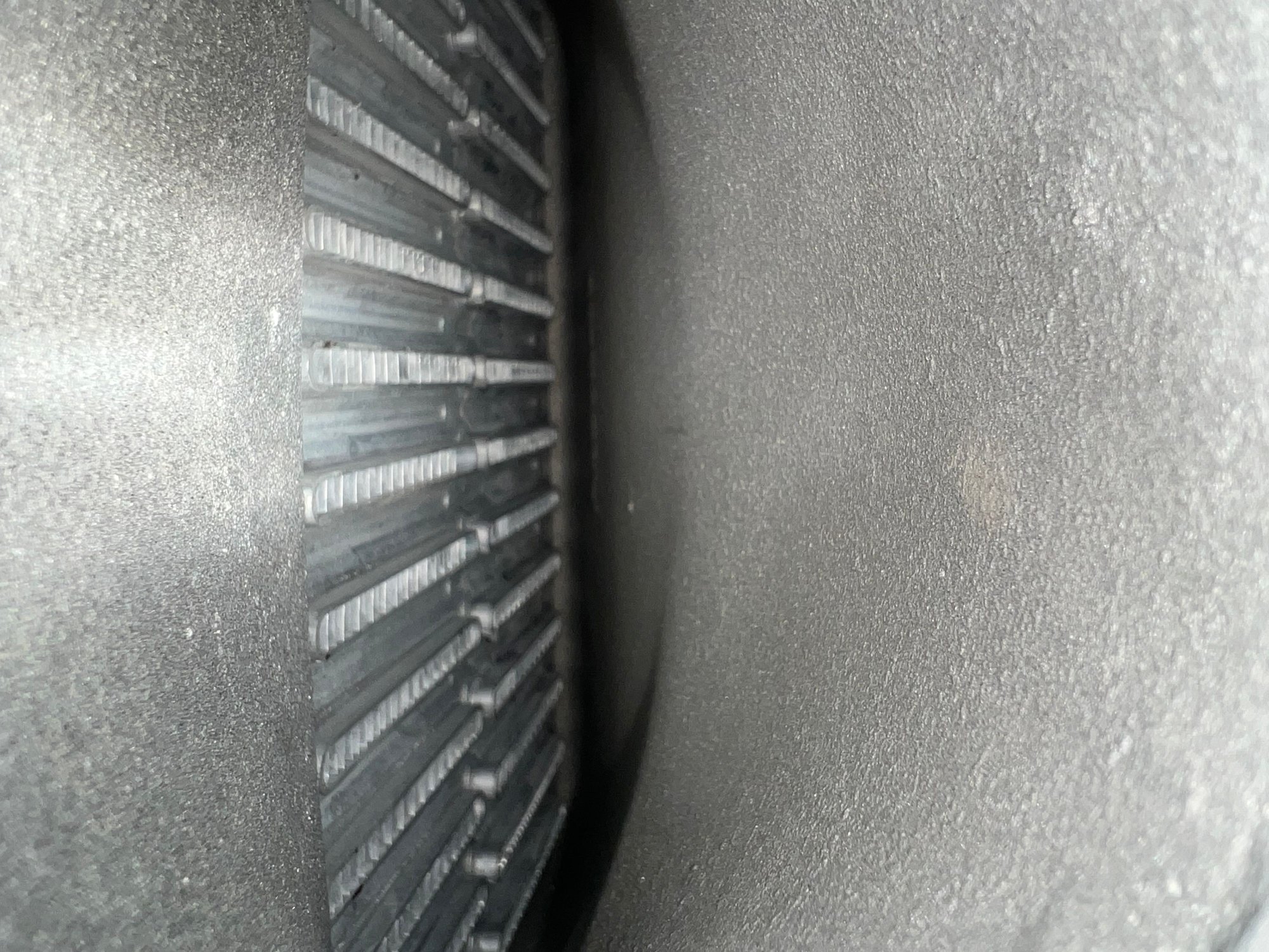

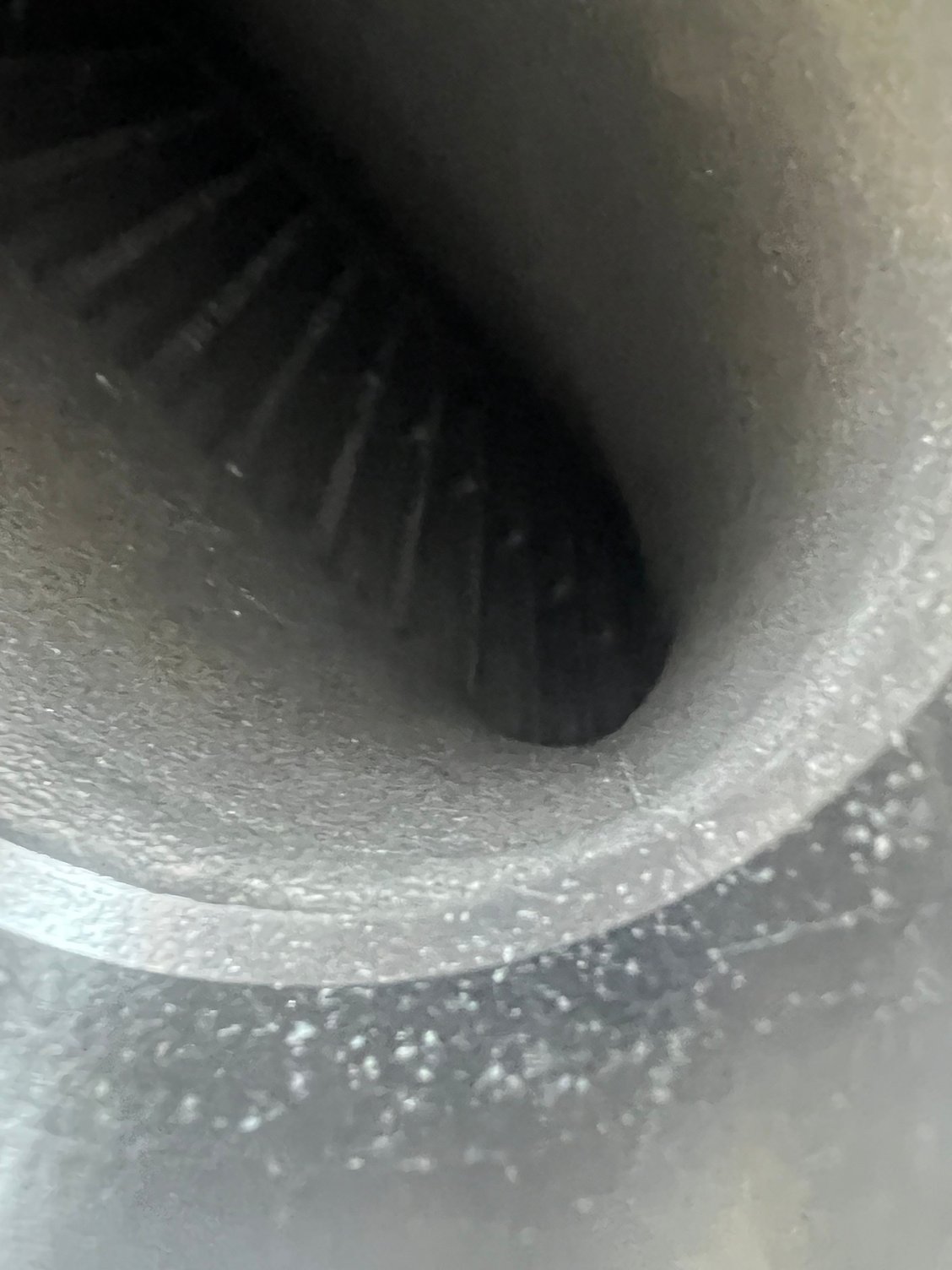

Post a closeup of the core fins.

Weight on these matches the specs. ~ 6.7 kg aka 14ish pounds on my home scale so likely not super accurate but close enough. Some pics for John :

Weight and measurements match the website. 14.7 lbs each , 12.9 inches x 8.74 x 5.7 These things are big but fit perfectly and I’m looking forward to the tune and turbos coming.
