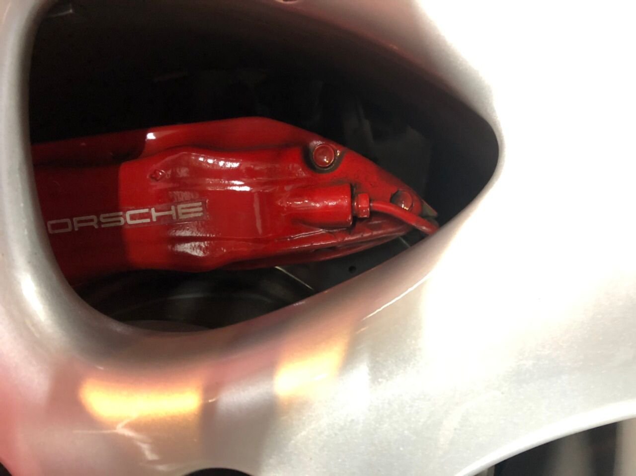

I don’t have a video. I will say that a 4 or 6 piston caliper will be more of a challenge than the 2 piston calipers on my old SC. The difficulty for me has always been how to pressure the pistons out once the calipers are removed. I’ve never tried to pressure out 4 pistons. If they all don’t pop out at the same time (highly likely), you have to seal that hole while you repressure the caliper. I slightly pressed the piston back in then used a c-clamp to hold it in place.
With that said I did repaint the calipers on my 993 without removing them. I used paper and tape to completely isolate the caliper. It’s not perfect but I wasn’t seeking perfection. If you zoom in you can see where I also taped over and reused the Porsche logo.

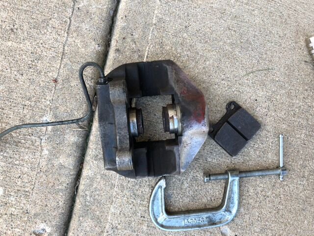

I forgot I had photos of the pistons from my SC. One shows the gummy buildup that I had to polish away. It can cause the piston to stick. The other shows the c-clamp I used to hold the freed piston in place while I removed the other. The old brake pad lying there is what I tried to use by placing it between the two pistons to keep it from coming out completely. I’ve never tried this exercise with 4 of 6 pistons.

You can just stick a piece of wood about the same width as the brake disk in there before you pressurize. All the pistons should pop out partway, hit the relatively soft wood to prevent damage. Remove the wood piece and pull them out the rest of the way by hand.

Correct. I’ve used wood as well. Couldn’t find the right thickness this time so I used the old pad. One thing however is the pistons don’t always pop out at the same time and the same amount. It depends if one has a higher surface friction due to corrosion or buildup. Best feeling in the world is when they do come out at the same time.

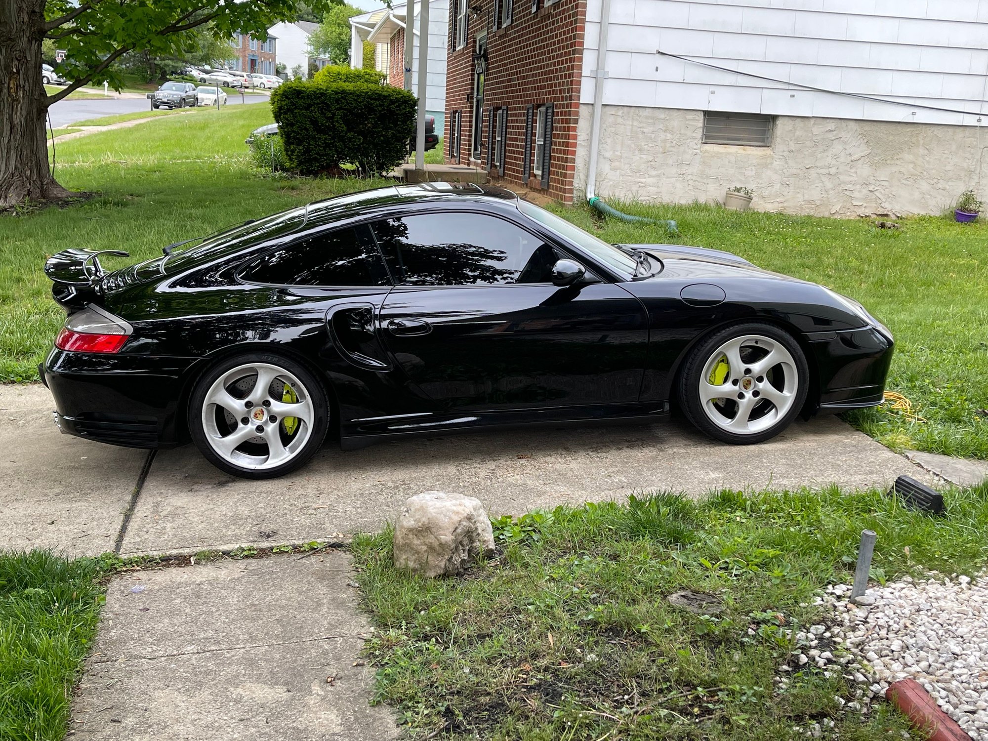

Well did them this weekend what you think adding the decals as soon as they come in.

Looks great! Really like the color. I wonder how the paint will last.

Now I want to do mine in Acid Green!. Did you do them yourself? Where did you get the paint from?

Ye Sir did them myself I used HYPERGREEN BRAKE CALIPER PAINT METAL STEEL ENGINE. found it on ebay and comes from Germany covers really well better than G2 and Duplicolor.
