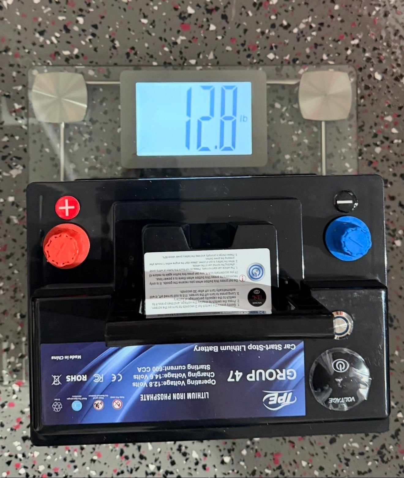

I'll just note that my no-name Amazon LiFePO4 battery has been excellent and it costs maybe 1/3-1/4 of what the antigravity does. The only thing it doesn't have is the key fob which I have zero interest in. 30Ah so it will last a solid month or two without any intervention if you aren't driving it. $200 or so and you can drop 40lbs.

Thanks so much for the reply's guys. I am going to give anti gravity a try for their little remote start stuff. If it doesnt work it was an expensive experiment. I actually bought one of the battery's yall recommended for another car and will try it, amazing that its same weight as anti gravity for 1/5th the cost.

I think I'd rather have $800 in my pocket than another 10Ah but that's just me.
Same commodity cells different box.

Not the cells that I’d be worried about. Not worth risking a potential fire over a poor BMS design to save a few bucks. Maybe the Amazon battery is just fine but so many people have antigravity without issue that it’s worth the peace of mind to me.

LiFePO4 doesn't really have these problems and a BMS is about as simple as it gets. Even your standard lead-acid batteries can start fires. Drawing a line between spending more money and getting a safer product is pretty tenuous here imo.
