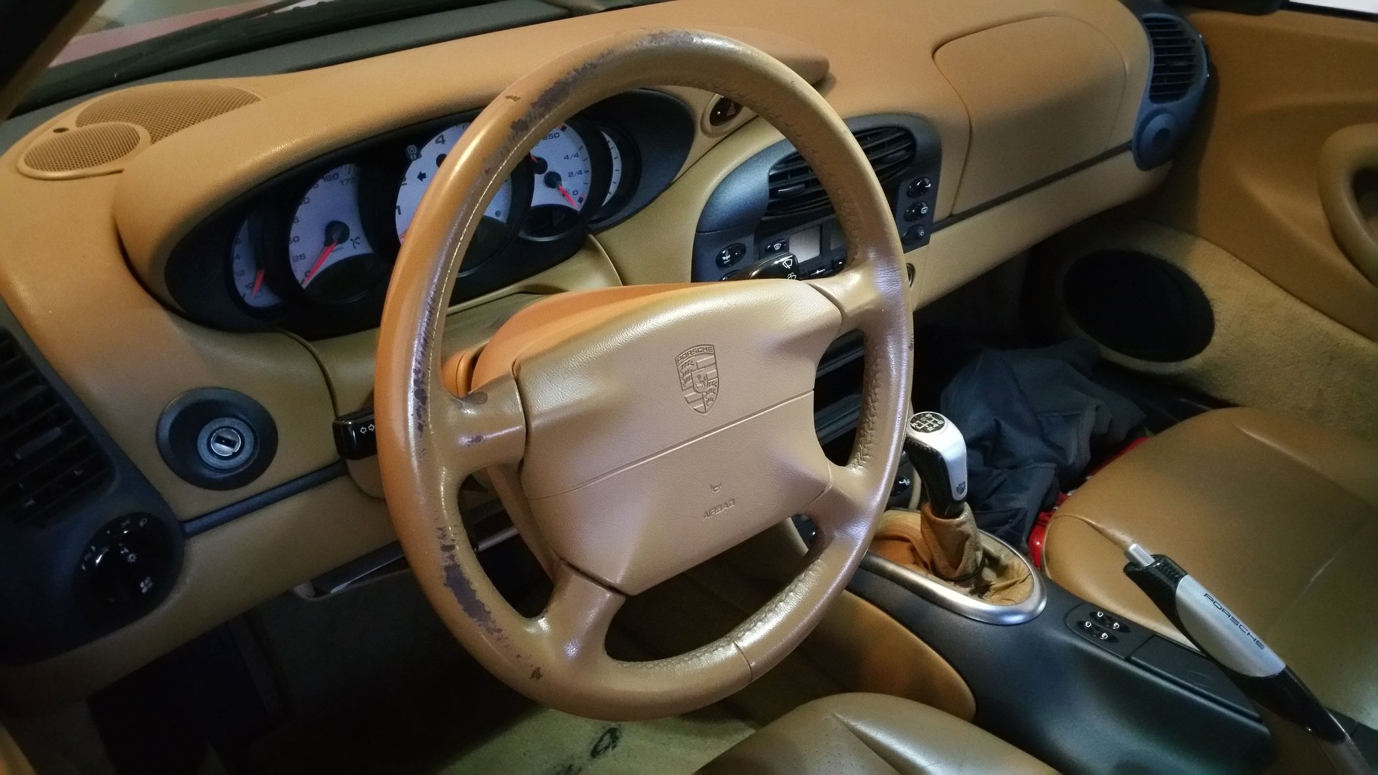

Looking to replace my 4 spoke wheel with a T96 3 Spoke, but I am having a hard time finding a used wheel and airbag in Savannah Beige. Found tons of black wheels with airbag on ebay for great prices.
Is it possible to repaint the wheel and bag from black to beige without any bleed through or to be a quality job?

to do it right, you need to take it apart so you can get the whole wheel out, strip it with acetone, paint with SEM matched to your color. It is at paint supply stores, they match
Thats what a interior pro would do

http://www.leatherworldtech.com/product-p/lvrck.htm This is the stuff you want. No need to strip anything. It comes out really nice. If you don't want to do that, I've got a refinished 4 spoke wheel with airbag in Savanna Beige - looks brand new...PM me if you're interested/want to see photo's
