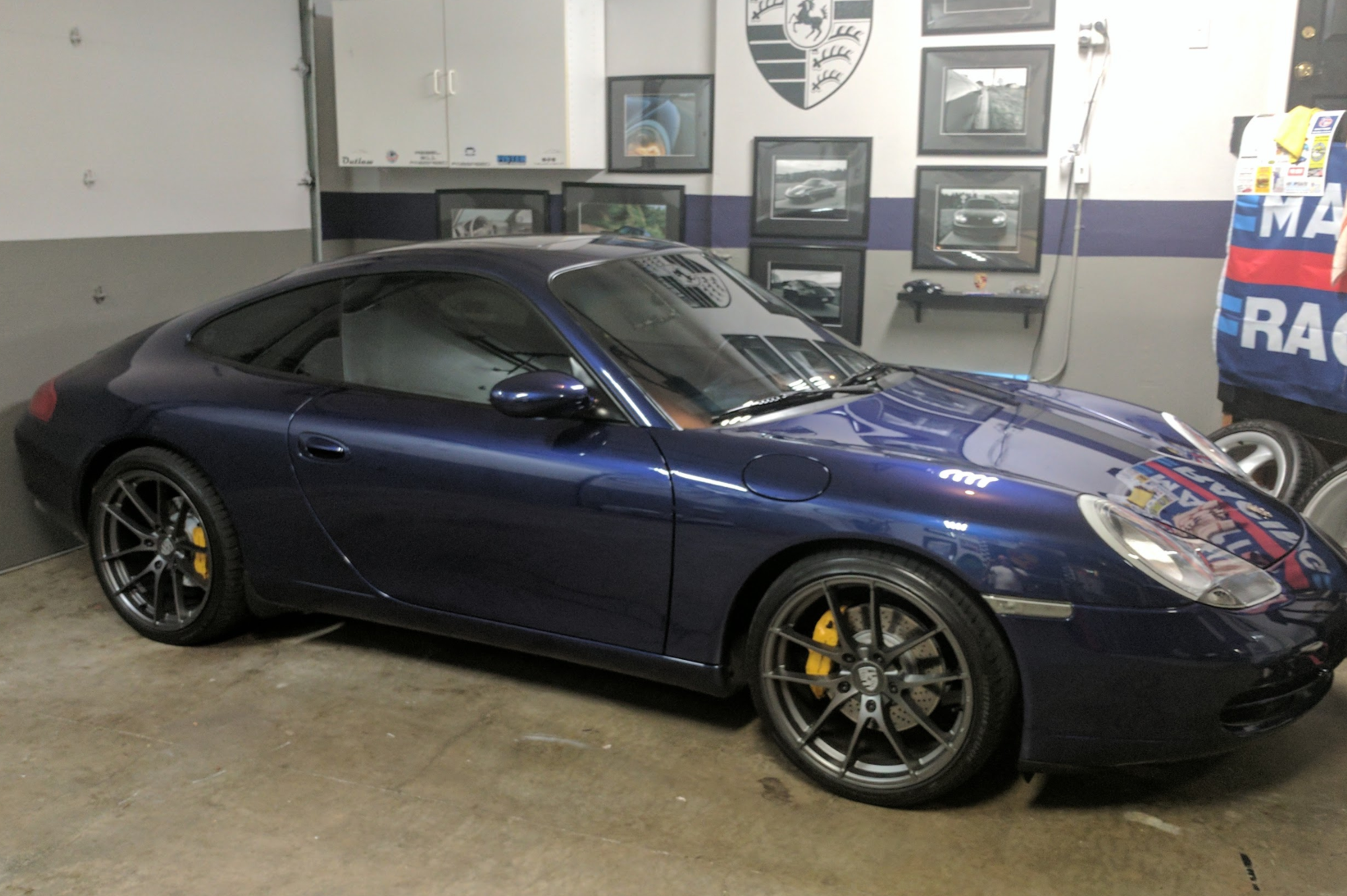

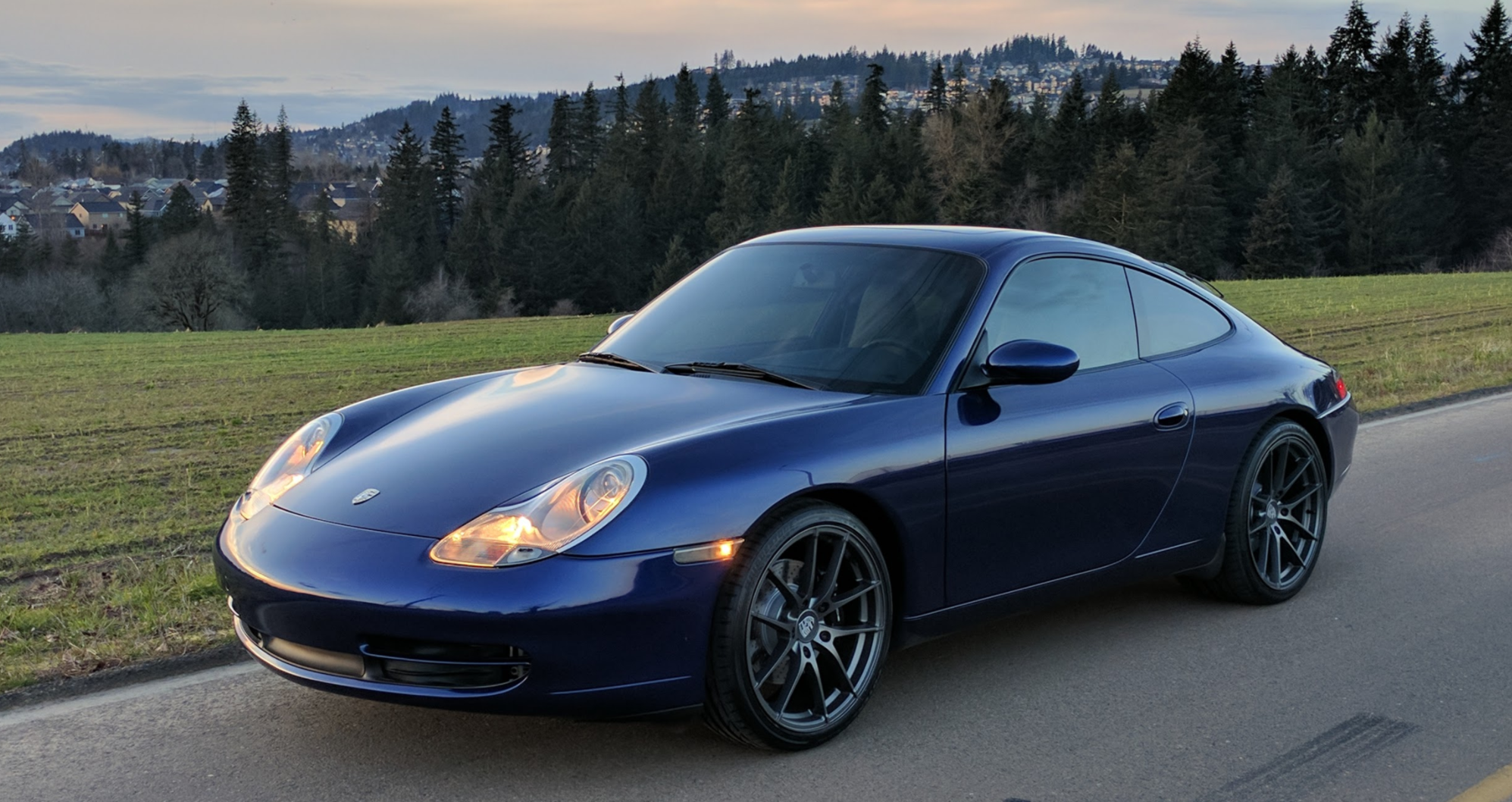

I have a 2000 C2 and have Front: 235/35/19 with the Rear: 295/30/19. My father has the same wheels with the same offset on his 2003 C2. Neither of us need spacers. The offset is the key factor.
Wheels were purchased from Wheel Dynamics and are the AT4s.
Front: 19x8.5 ET. 52
Rear: 19x11 ET. 67
