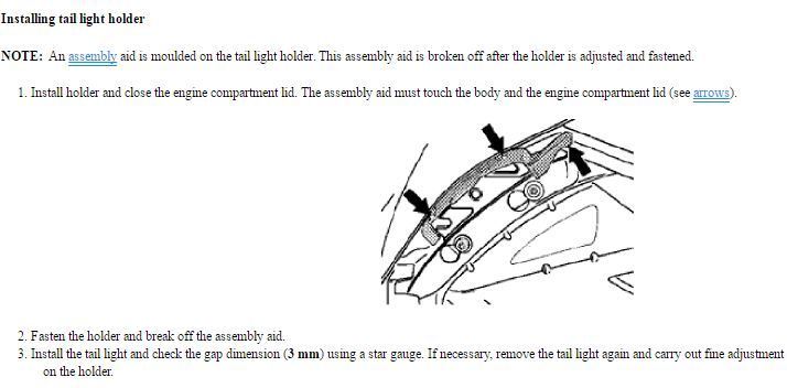

Anyone have any tips for getting the rear tail lights aligned? (2004 C2).
I know to move around the black plastic holders that are held in place by 2 torx screws.
The manual makes mention of an alignment tool that is moulded onto new holders that then gets broken off, I haven't been able to find an images of this.
The factory manual also mentions a 3mm gap but is that above the light or below or both?
From images i've seen the light starts flush to the bumper and as it goes around to join the rear lid a gap starts to build?
Should have followed the saying "if it ain't broke don't fix it" but I tried to re-align them, broke a holder and made them worse! gah

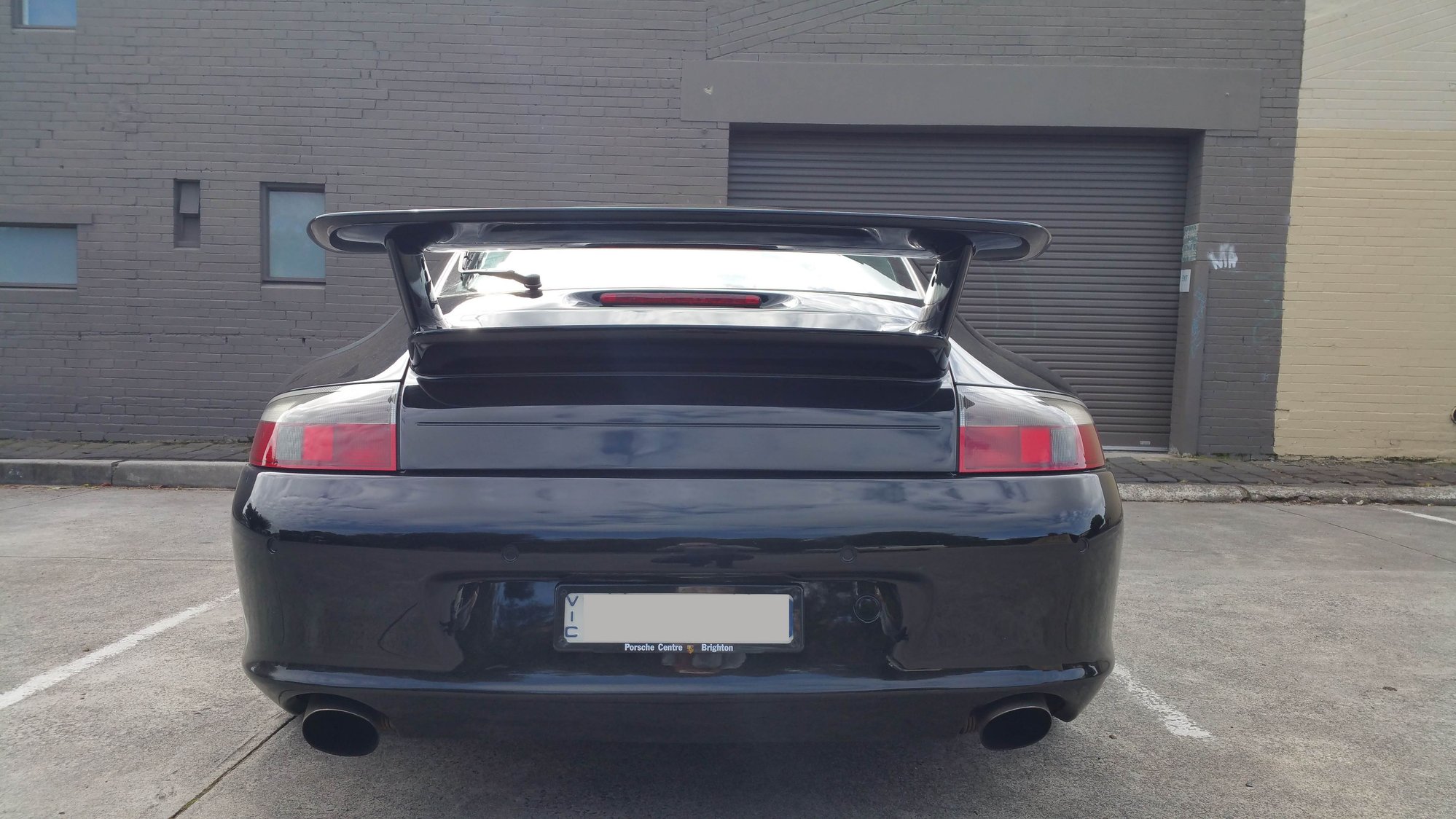

Pic below, looks like the bottom gap is too big?
Assuming it starts off flush and then a gap builds to 3mm where the tail light meets the decklid?

To me the gap looks a little big? Maybe just a minute adjustment.
Anyway couldn't really find any documentation on it even if mine are okay.
Actually that's the alignment before I messed with them. They look worse now... Haha

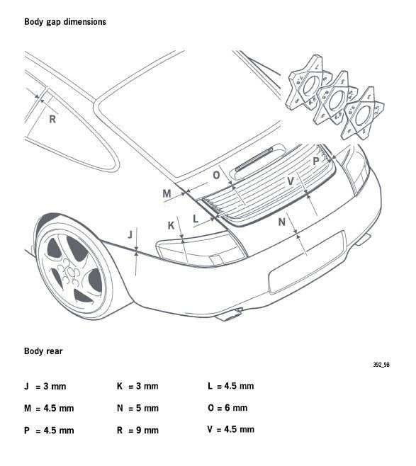

Yep shouldn't have touched them! I broke one of the holders in the process too!
For those as OCD as me:
Enjoy!

Light gaps look OK...if anything the hood gap looks too much.

I couldn't find any gap checkers so I used my vernier callipers instead. Not the best to use but got the job done. Have to wait on the new bracket to arrive from Germany ugh.
I'll have to look into the decklid.
