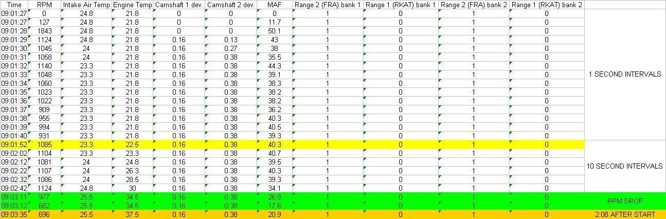

Based on what you wrote the first thing that comes to mind is the coolant temperature sensor is supplying the wrong -- too hot -- temperature and the fueling is lean.
I couldn't tell from the audio but if you hear spit back in the intake that's a sign the engine is too lean. (Backfires in the exhaust is a sign the engine is too rich.)
If you want to confirm this -- or eliminate this -- you need to capture intake and coolant temperature at cold engine start.

Engine temp looks flat line. My experience is at cold start and idle coolant temperature should increase 1 to 2 degs F. every second.
I am assuming engine and coolant temperature are the same thing? Durametric, i only see the engine temperature. I will repeat the test again tonight and follow the temps a little further and see what happens. Thanks.
There are "engine compartment temperature" and "engine temperature" available in Durametric. Engine temp = coolant temp.
How much time for the log shown above? I assume only a few seconds worth? was the ambient at around 30C?

Here is another cold start with data spanning two minutes from the start. Yelow row is 25 seconds into it which is the first time engine temperature has gone up about 0.7C. Can those RKAT/FRA values really be that dead on? Based on Macasters theory that engine temp should go up 1 deg every second this may indicate that that coolant temp. sensor may indeed be waving bye bye.
This chart i made after a long run with engine at temperature in my garage.
Any input appreciated, thanks!

The numbers still look fine to me assuming the measured temp was close to the ambient temp at start up. If the temp sensor was bad, it should be significantly off. At warm up it reports 96C, which is right also.
