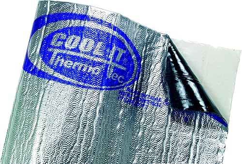

Several varieties of adhesive heat shield available on Amazon.
Amazon.com: Thermo-Tec 13575 12 Amazon.com: Thermo-Tec 13575 12" X 24" Adhesive Backed Heat Barrier: Automotive
Amazon.com: Thermo-Tec 14620 60 Amazon.com: Thermo-Tec 14620 60" X 36" Heat and Sound Suppressor: Automotive

Thanks. I just ordered the Thermo-Tec on Amazon. I'll let you know how the installation goes.
