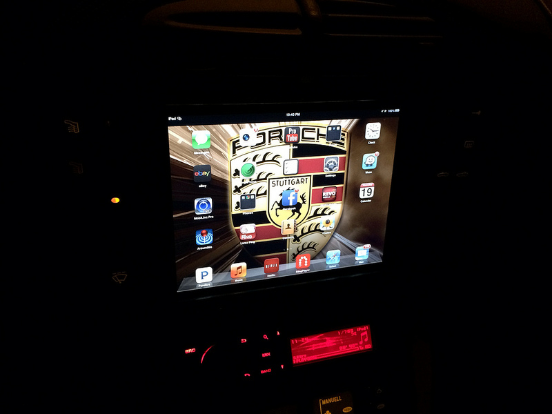

Thanks to PFBZ and some others on 6speed I just finished mine a couple of weeks ago and loving it!
It really is amazing all of the items I can do, of course play all my music, Netflix for the kids, can even watch live TV using my slingbox, Nav, email, texting, of course all this while NOT driving!

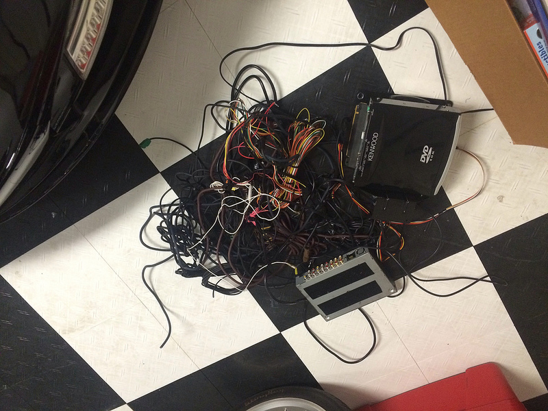

Check out the pile of wires pilled out from my old system that had TV, DVD, Nav, hard drive for music.
