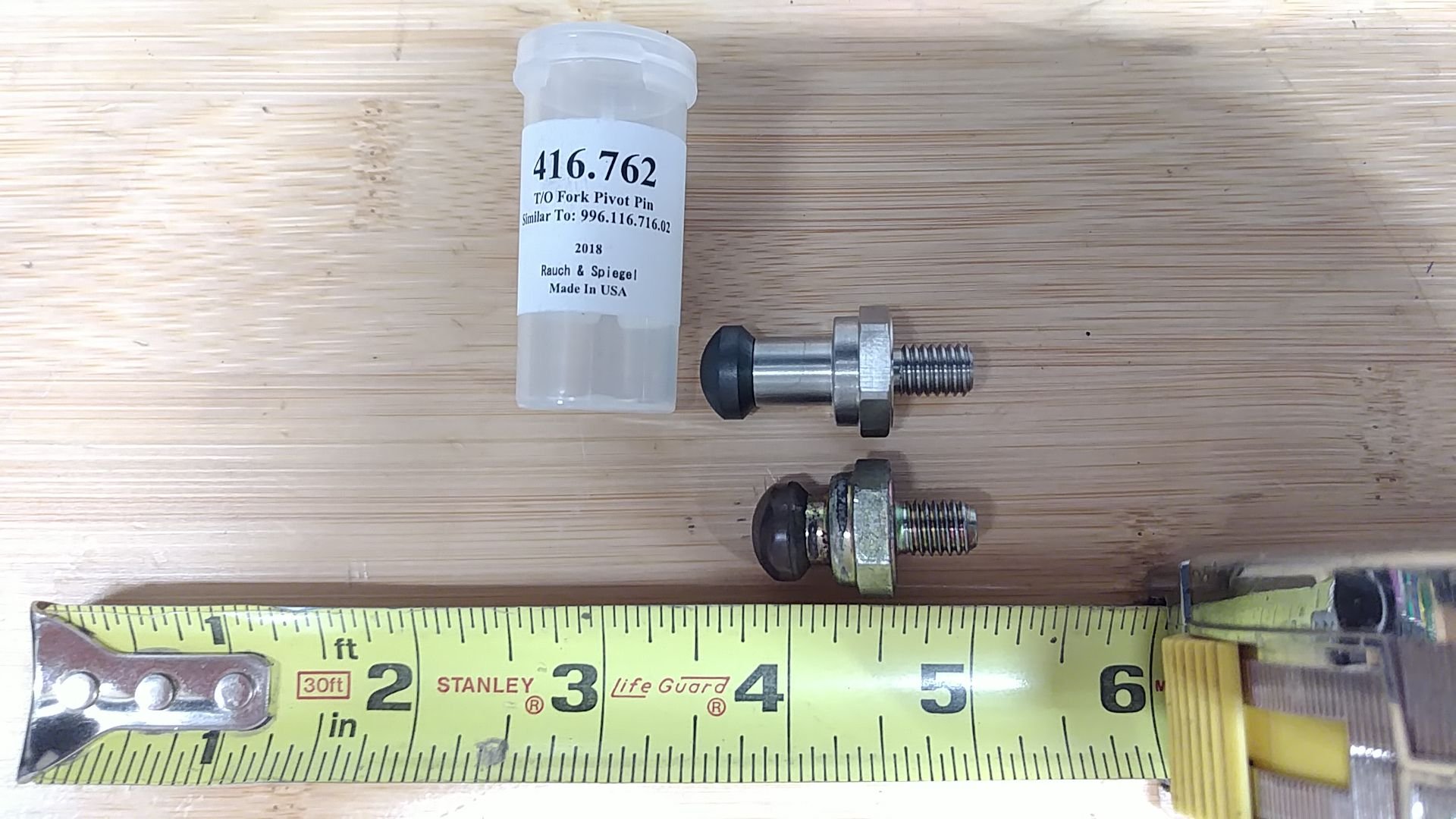

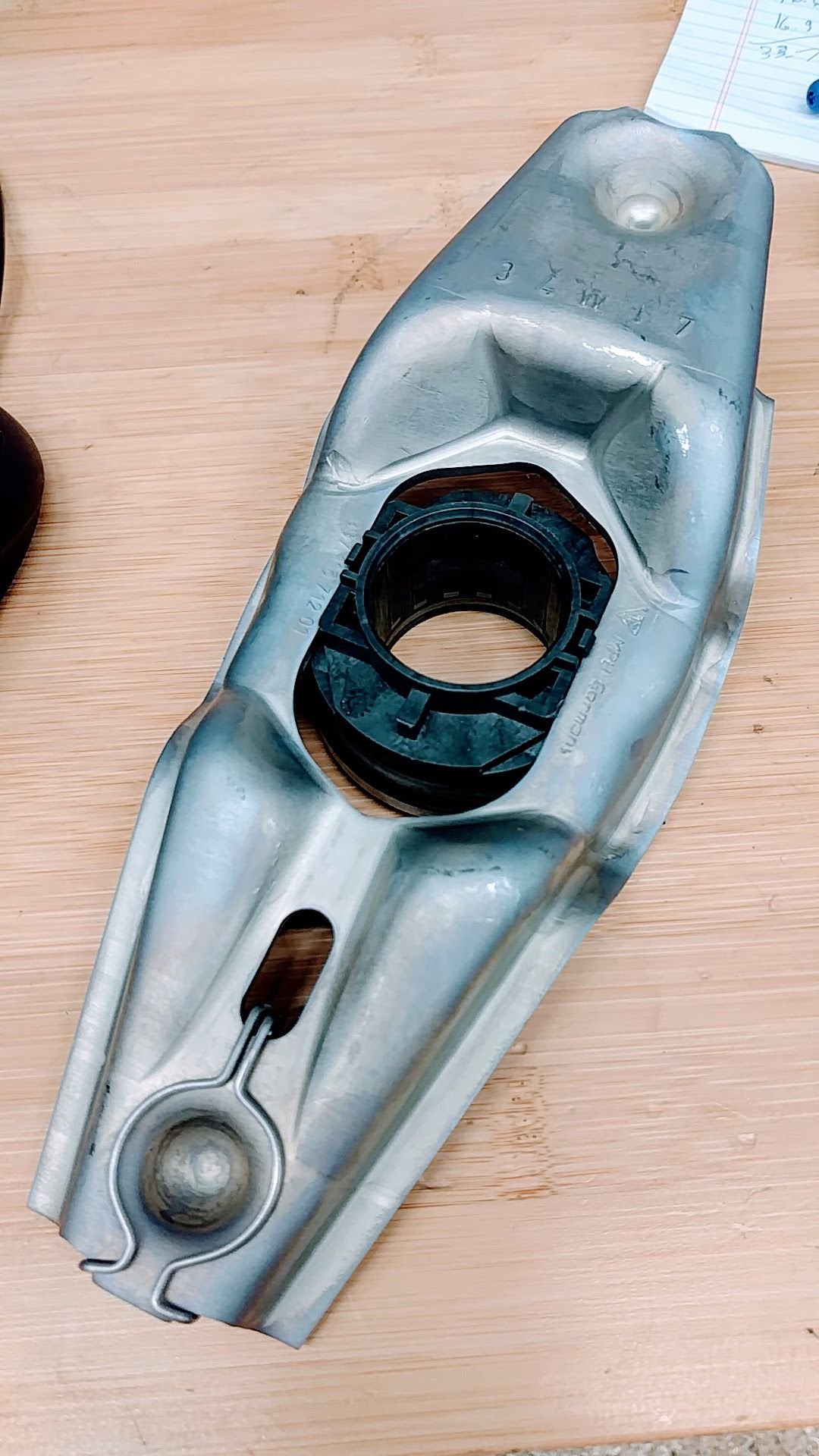

Question
I'm working on this today and have a question for a 2000 C2. Is the retaining clip needed (part 9P1.141.164 attached)? I don't think so, given the longer pivot pin (Rauch & Spiegel) and NOT using the plastic piece. Can someone verify? Thanks!
clip
upgraded 997 fork
997 upgraded fork
Rauch & Spiegel top, old 996 OEM below
Rauch & Spiegel pivot pin installed
Old Sep 8, 2019 | 02:55 PM
Ahsai's Avatar
Ahsai
Joined: May 2005
Posts: 7,326
Likes: 77
You need the clip. You're missing the black rubber "washer" between clip and the fork in your pic.

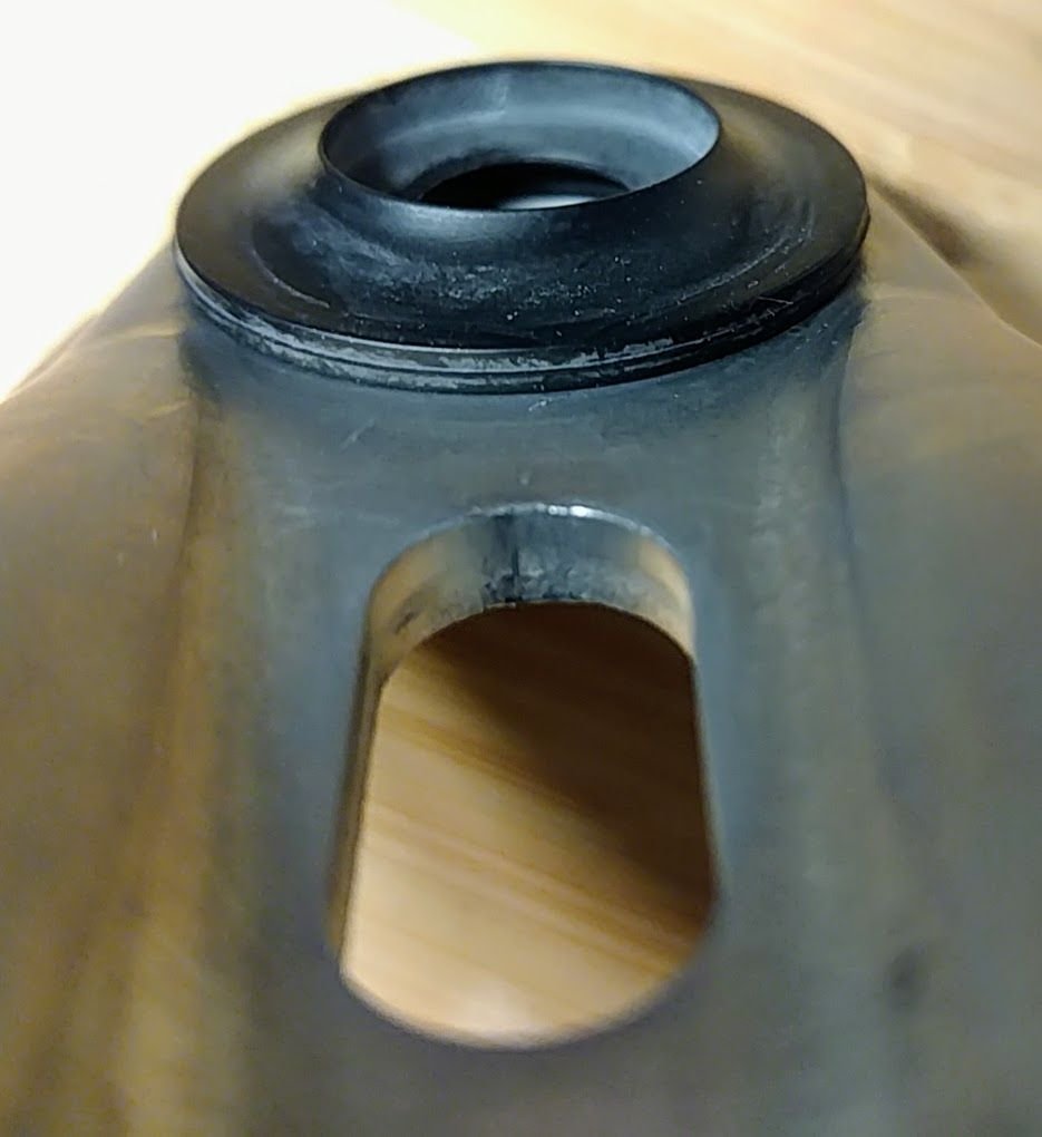

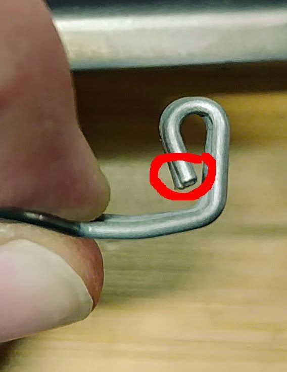

Thanks Duncan! I checked the box of parts again and there it was! Follow-up question. How secure against the fork should the clip be? It's not "snapping" into place. Should I cut off the clip ends circled in red, in the photo below? The thickness of the fork doesn't allow the clip to full snap in. I'm a bit worried the clip could work free.
sealing ring
clip not "snapping" in
fork thickness, compare with clip end
cut ends to accommodate fork thickness?
Old Sep 8, 2019 | 08:21 PM
Ahsai's Avatar
Ahsai
Joined: May 2005
Posts: 7,326
Likes: 77
I know how you feel about that clip being loose. It could have been designed better. I just left it like that but if you find a way to make it more secured, I don't see why you shouldn't do it.
Old Sep 9, 2019 | 09:56 PM
Doug996InKC's Avatar
Doug996InKC
Joined: Sep 2008
Posts: 390
Likes: 41
From: Overland Park/Kansas City
It's not pretty, but definitely more secure. The first few attempts I burned through the clip ends which left me with just a bit left over to tack. Now waiting on Amazon to deliver white lithium grease, and I'll get this buttoned up.
