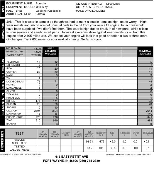

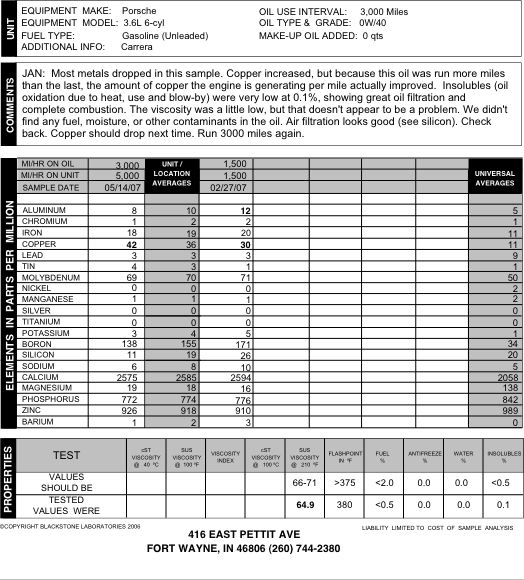

just got my second report from blackstone. i had my engine replaced about 6K miles ago. i did oil change at 1500 miles and at 4500 miles since that. i sent both oil samples to blackstone lab for analysis. got my first report a while back and got my 2nd report just now. both are attached. if you never done a report with them, you should. not affiliated, just a happy customer (with knowledge that his engine is doing well).
i am a little worried about "viscosity was a little low" in the 2nd report. something i should address? and if so -- how?
1st report after 1500 on new engine:
2nd report after 4500 on new engine:

I didn't think folks from this board knew anything about blackstone labs. They are very helpful. I wonder if they could detect minute traces of coolant contamination to forewarn us of an engine failure?

I used Blackstone Labs for my oil analysis. Inexpensive at only $17/test.
Haven't done it for the 996 yet.

I've used them in the past as well. Washington, they can detect coolant and forewarn of exactly the problem you mentioned.
