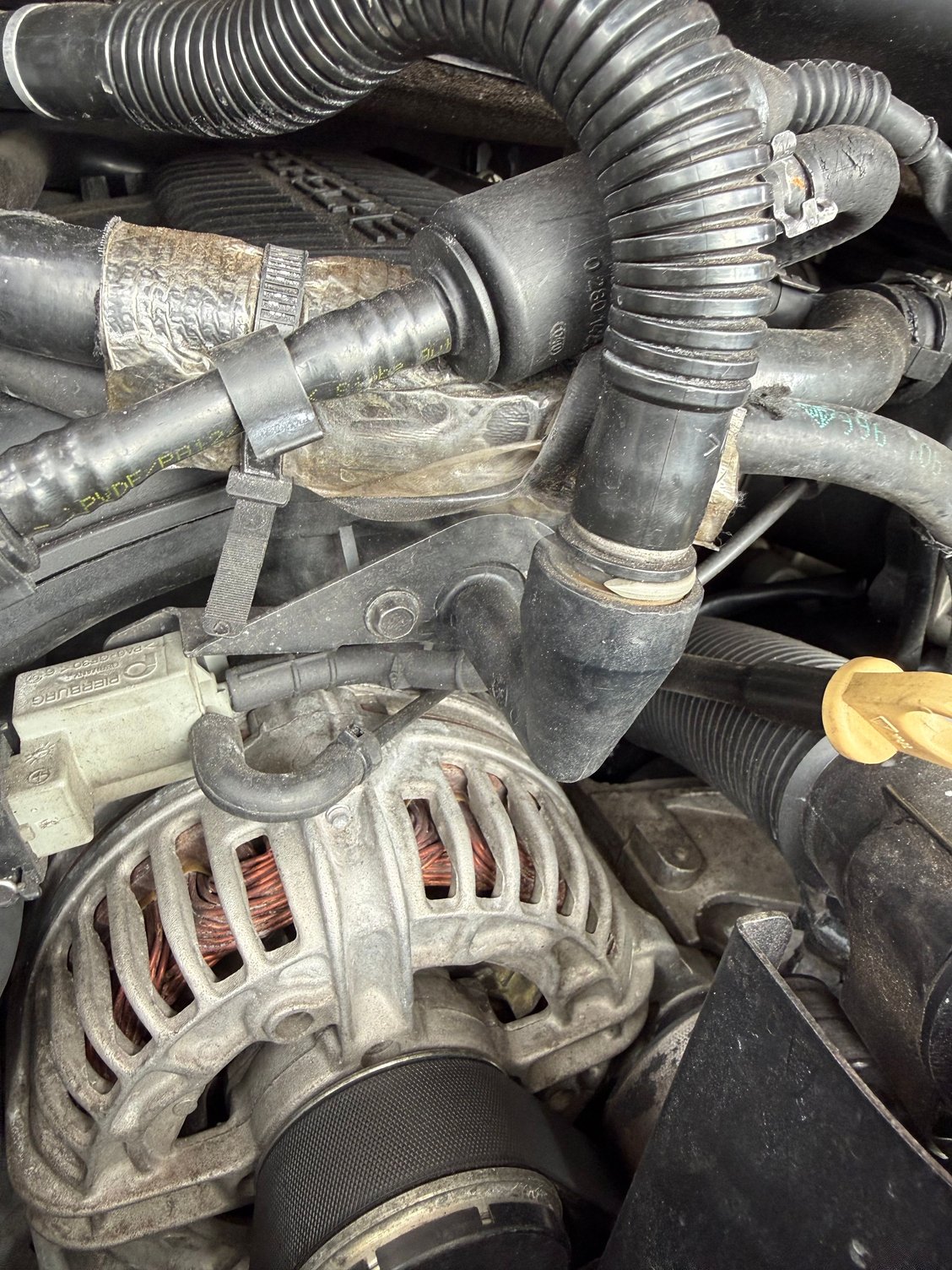

Good afternoon. Can someone help me identify this part that is leaking during my smoke test this afternoon. It’s some sort of plastic fitting shaped in a 90°.

Brake booster vacuum elbow.

http://www.autoatlanta.com/porsche-p...section=107-10
Parts 3, 22, 23
There is an early version of this set up too. U may have to do some searching as this leak has been discussed before.

Thank you, that diagram is super clear but my fitting that goes onto part number 3 is straight coming from a corrugated hose not a 90° elbow?

After another search I found where some people had just taped that fitting? I’m guessing that is effective but looks like I also have to replace the O-ring at the inside of the elbow cause I had smoke coming from there as well, that’s why I just figured Id replace the whole thing and be done with it, 54.00 from pelican.

They are notorious for leaking, had the same issue. Replaced the o ring (which immediately cracked into bits) and all is fine ever since.
