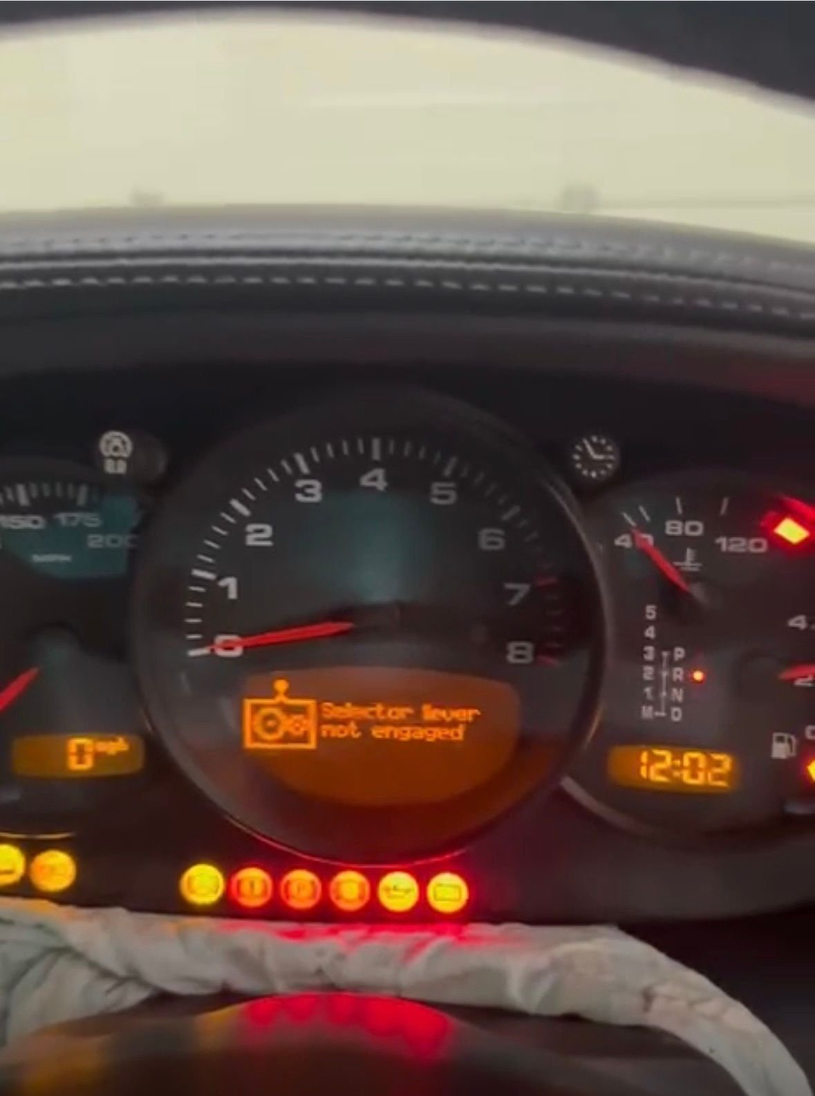

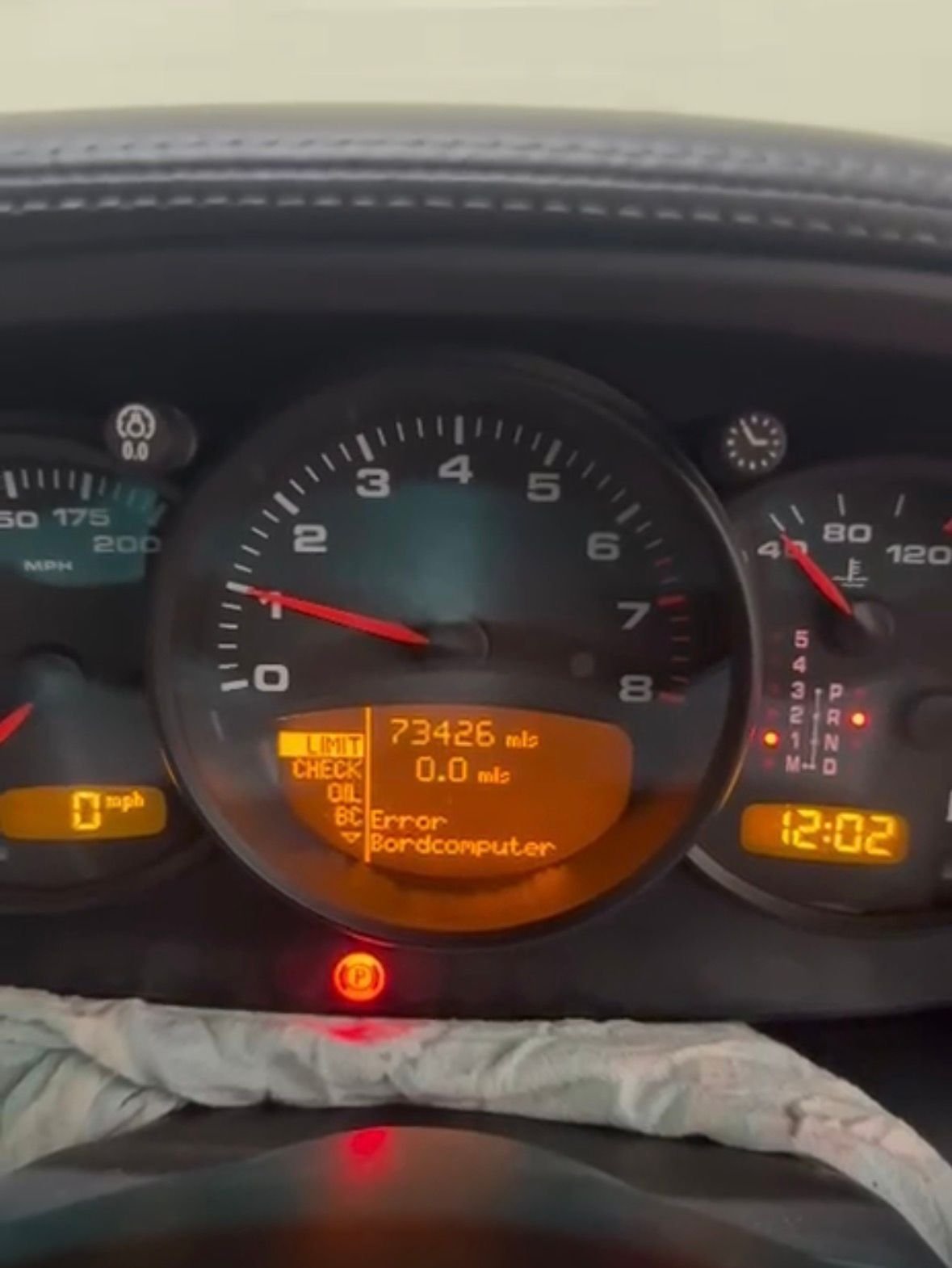

I have a 2001 996 Turbo Tiptronic that’s recently had the engine and gearbox removed to fix a leak between the gearbox and transfer case. Since everything was refitted, the instrument cluster has been showing some very strange faults, and both the specialist and I are a bit stuck.
When turning the ignition on, the display shows “Error Bordcomputer”, followed by “Selector lever not engaged.”
Once the car is started, it returns to “Error Bordcomputer”. The reverse light flashes while in P, and when moving the selector to D it shows both first and reverse at the same time.
Despite this, the car drives normally and shifts through all gears without issue.
The clocks were swapped with a set from a 996.2 Tiptronic, and those worked perfectly with no faults.
Has anyone come across this before or got any ideas what might be causing it?

*Note ,there are no fault codes on the car and the live data is showing the correct position of the gear lever, but the instrument cluster is not*
Before engine started.
After engine started

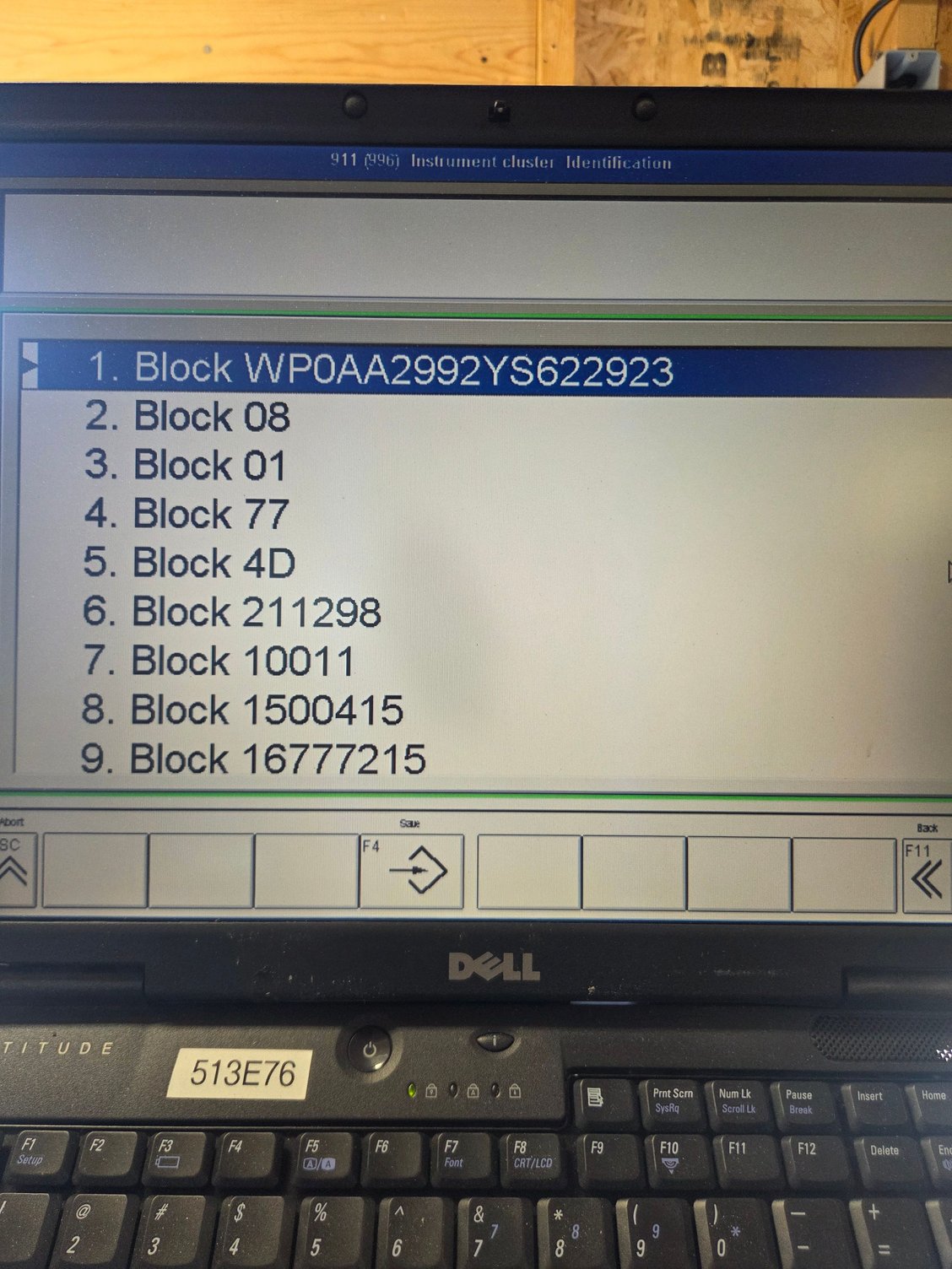

Maybe with clocks you mean the instrument cluster, or did you actually fiddled with the instrument cluster?
It may be a reprogramming issue. This is a good article to follow but you need PIWIS and the codes.
https://www.pelicanparts.com/techart...h2HkUYM4Q50Y4q

I still think the OP should focus on the cluster/clock. While the OP says the cluster/clock was working prior to the leak repair, I wonder if the systems were working with RAM until there was a reset and then reverted to ROM. Hence the recent wonkiness.
I'd confirm compatibility between the clusters and then confirm the programming. btw, the Pelican article points out that clusters are USA or ROW but the Porsche manual says there are other choices such as UK, Japan, etc. I pulled up my coding and there seems to be about 10 different codes (more than shown in the photo) No idea what most of them are but I suspect they all do something. The only way I know to change them is to extract the coding from the original cluster and then over-write the new one (I don't think that'll update the mileage.)
