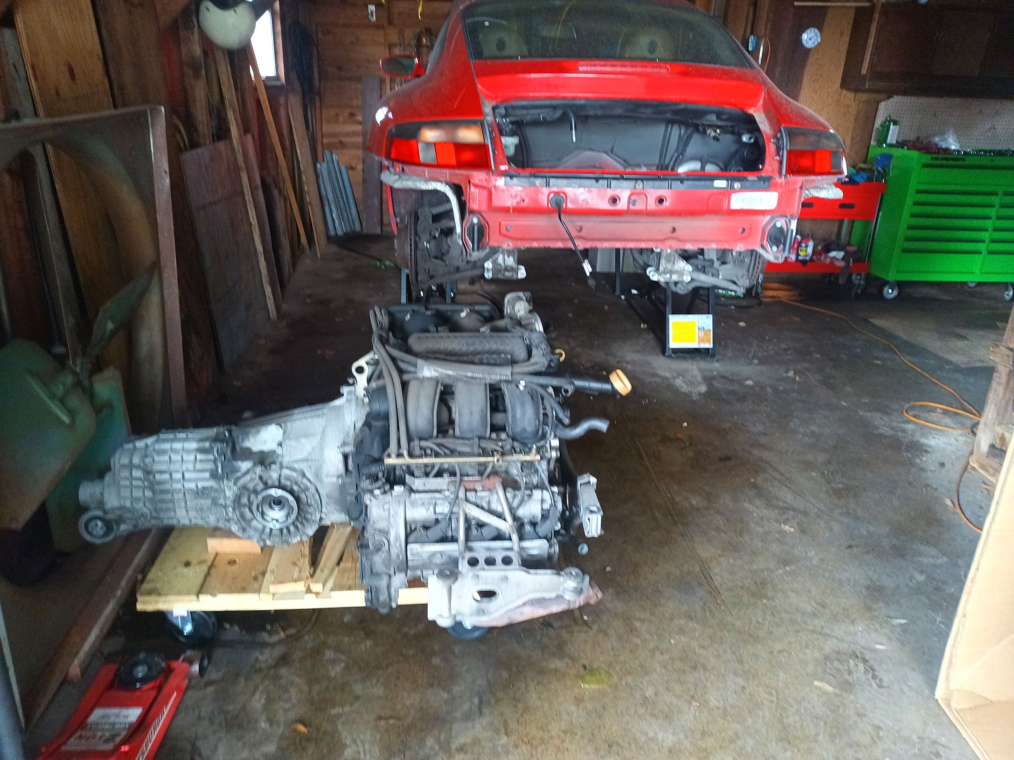

Sorry I didn't see this earlier. There is some cutting involved, CPE says the piece that gets trimmed can be purchased new from Porsche and be replaced to factory condition, I never verified that. I have some blurry pictures showing the piece before and after trimming.
