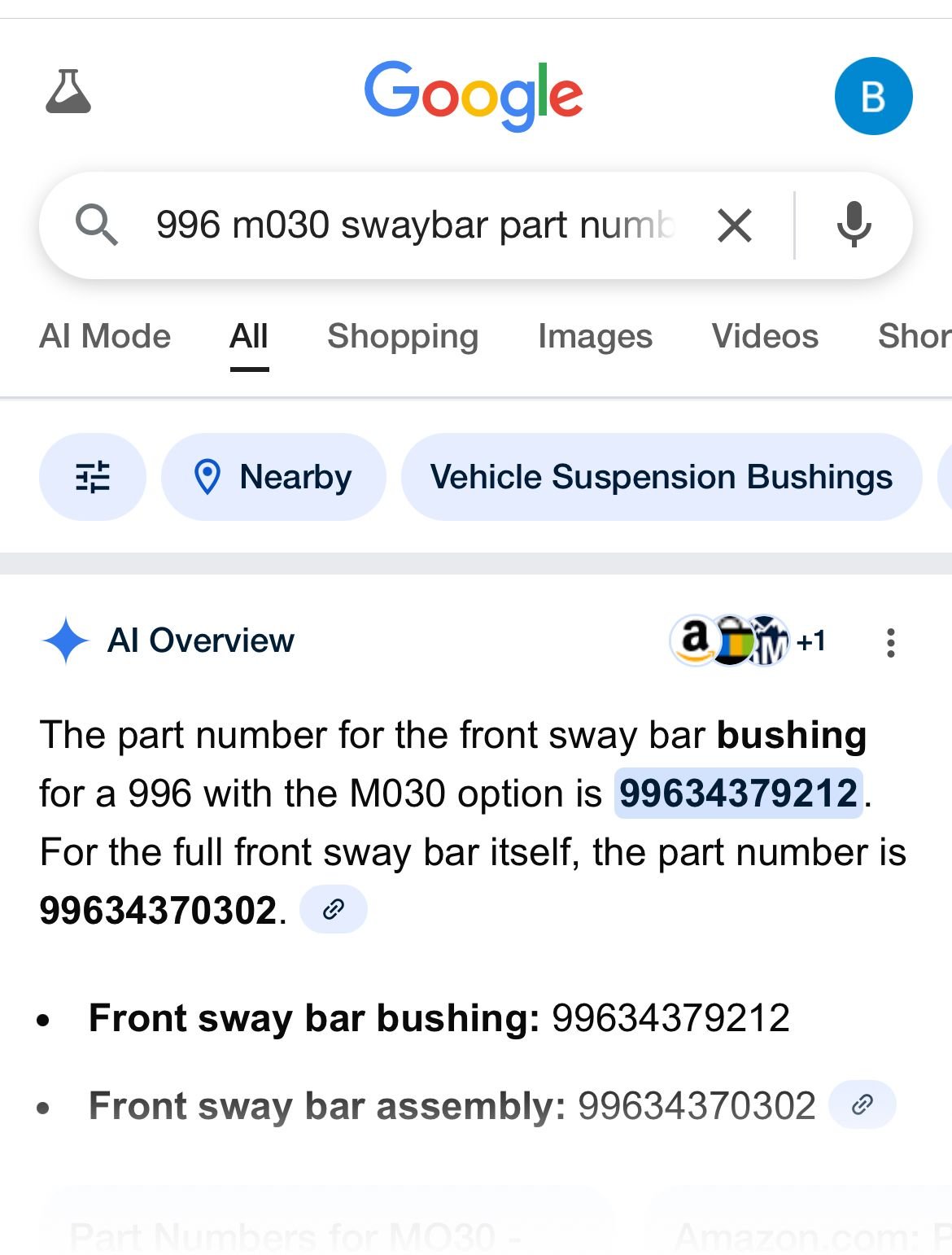

This is what I save from the kit that's on my '99 C2. IIRC, what they're referring to as 'additional spring' are the bump stops.
