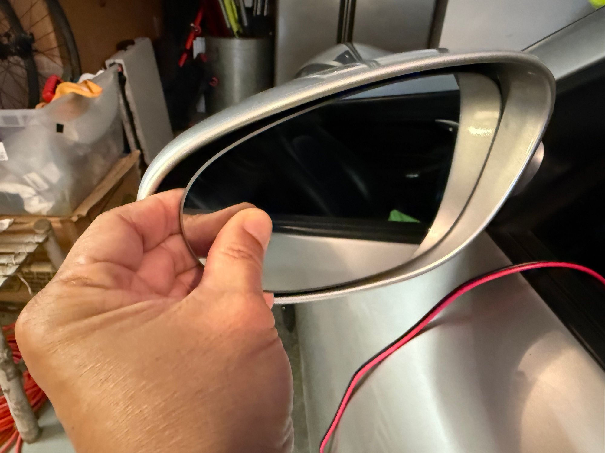

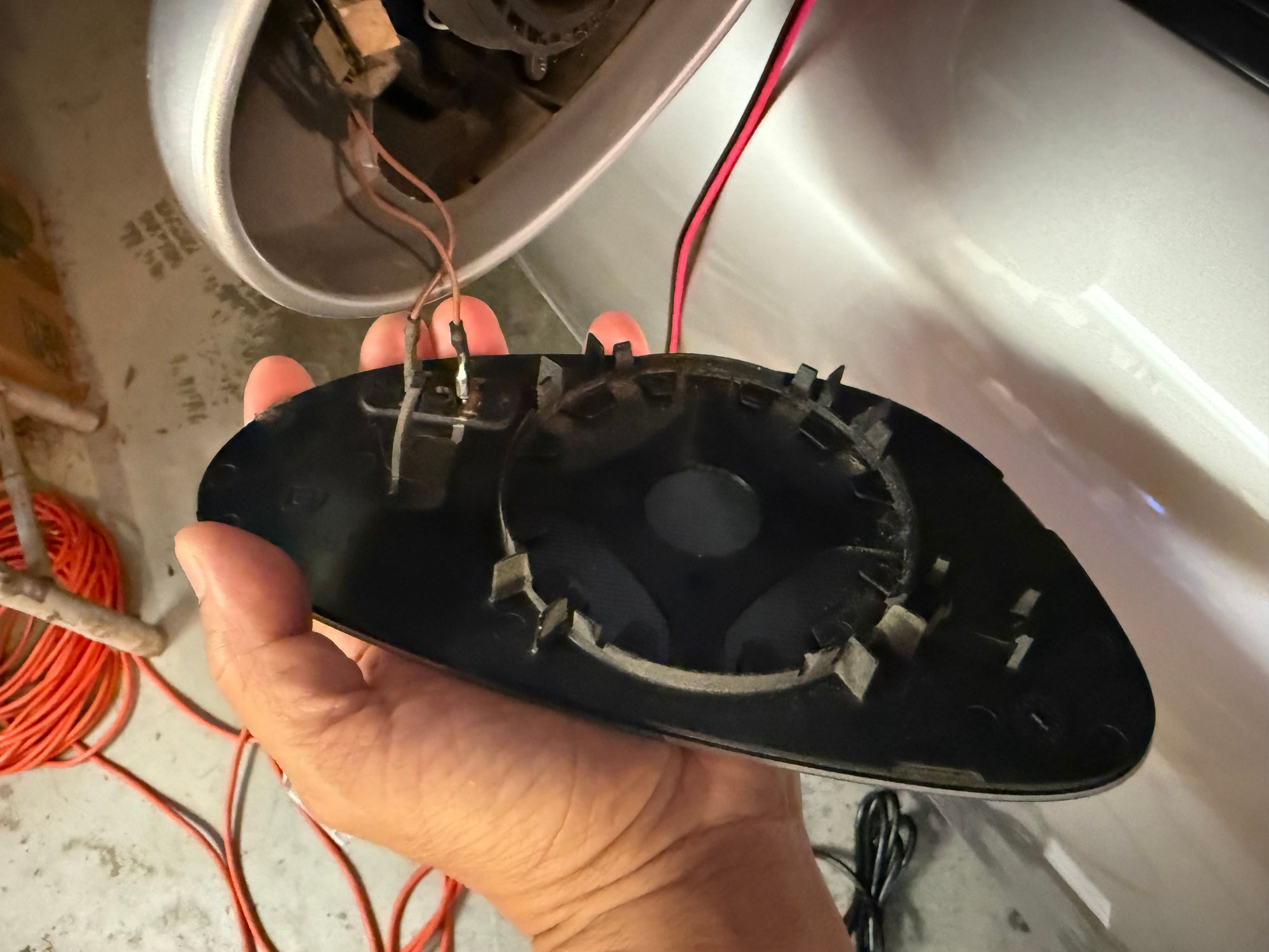

The girlfriend noticed the glass in the passenger side mirror was vibrating. Upon inspection, the glass was barely held on to the black plastic backing plate which is what then snaps into the motor assembly to hold things in the housing. It is a heated mirror. I can't see how this plate was attached to the back of the glass though. Maybe a spray-on adhesive?

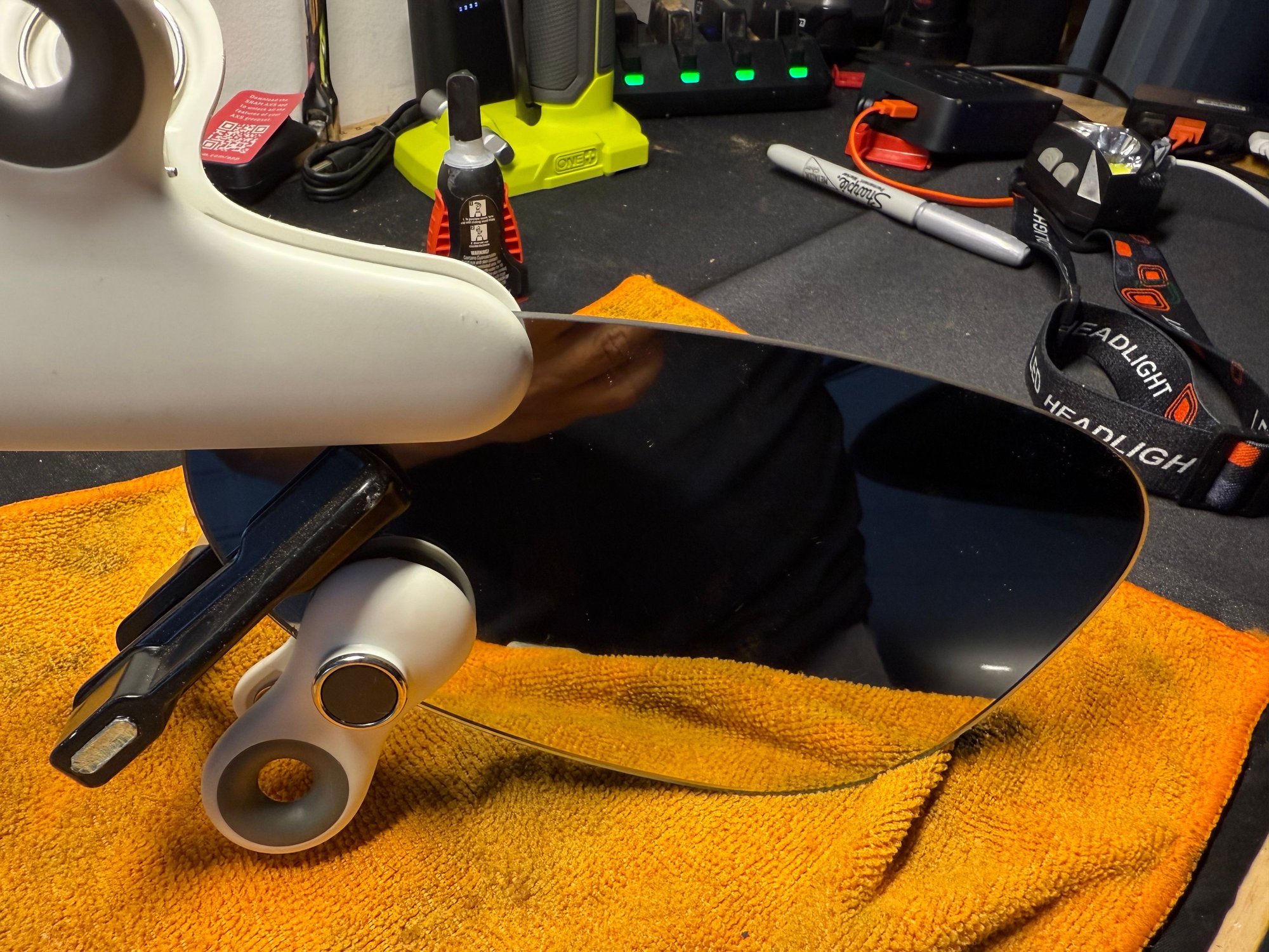

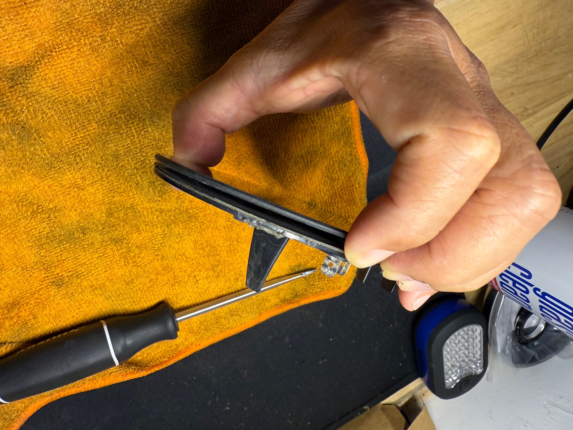

I am thinking about using a good adhesive like E6000 where I place dots of the adhesive around the perimeter of the glass and then a couple the center. I am afraid to apply much more than this for fear of the dots showing up through the mirror and for fear of somehow messing up the ability to heat the mirrors. Does anyone have experience doing this? If so, I would appreciate knowing any advice and pitfalls to avoid.

What did you use to glue it? How much glue did you apply and where/how did you apply it? All over the back of the glass or just in a few areas? As I wrote, I used strategically placed dots/globs of E6000 because I was worried it might show through the mirror. Now that things are dry, I haven't noticed anything showing through the glass or deterioration of the silvering. I would probably apply more knowing what I know now.
Great idea to use the clamps for a really tight bond. That will ensure the mirror heating in the backer transfers as much heat a possible.
