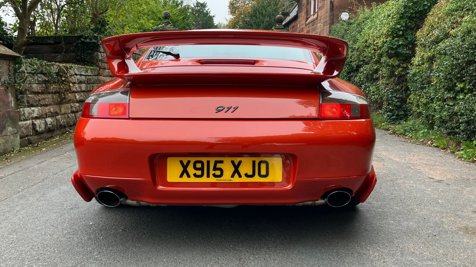

I've just done this very job without issue on my 2001 996.1

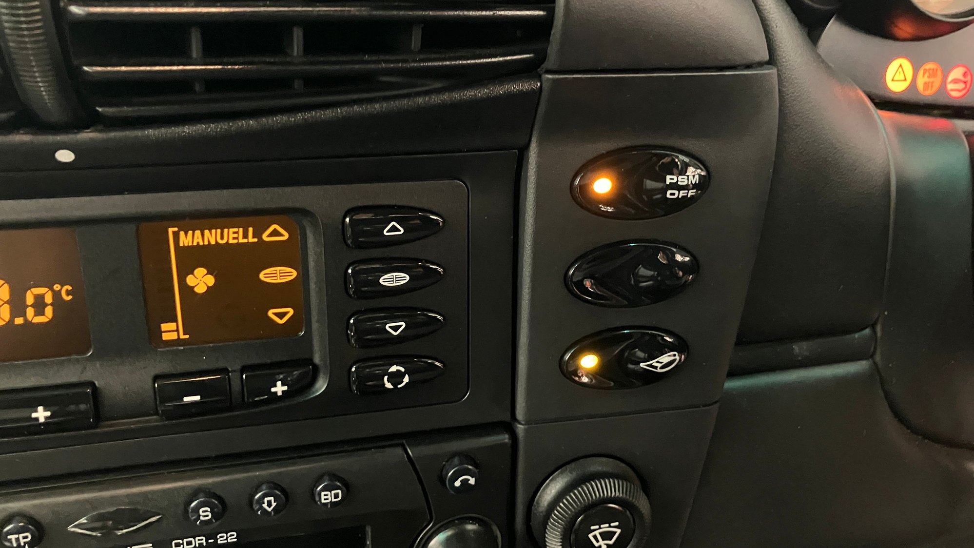

My car was originally equipped with PSE but I wanted to use the dash button as per the 996.2.
If you want to use the factory dash switch and have it operate exactly as per the 996.2, you'll need to purchase the correct relay which is scandalously expensive, but the only way to do the job properly.
One other thing to consider is that the wire that controls the switch backlight 'dim' signal (green/blue/brown) has to go to a spare relay slot on a jumper bridge within the relay board. All the instructions available on this state to find this in relay port 28, pin 5/2. This IS NOT correct, it is relay port 25, bottom row, third from the left. Having consulted the original factory wiring schematic for a 996.1, this was confirmed to be the case. Maybe the 996.2 has different wiring in this area, but if you're doing this on a 996.1, it is slot 25, not 28.
Here is a copy of the wiring schedule as per the Porsche retrofit dealer technical guide, but please note incorrect relay 28 reference as stated above.The first table is wiring to the relay, the second table is wiring to the switch. If your car is already PSE equipped as mine was, only the wiring to the switch is needed.

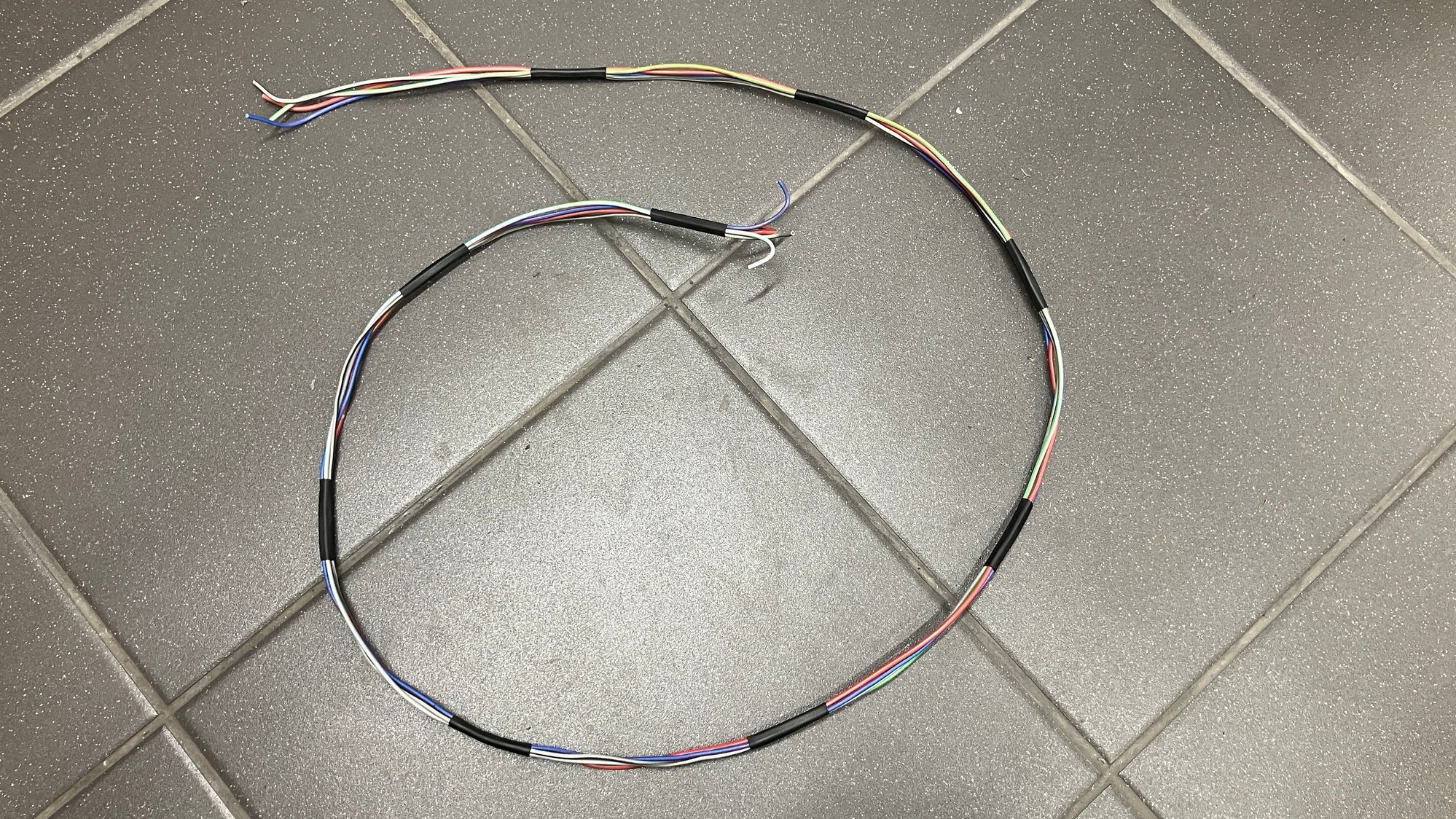

Here's the mini-loom I made up to run the switch to the relay and fuse boards. 24" should leave plenty of spare to enable neat and tidy routing.

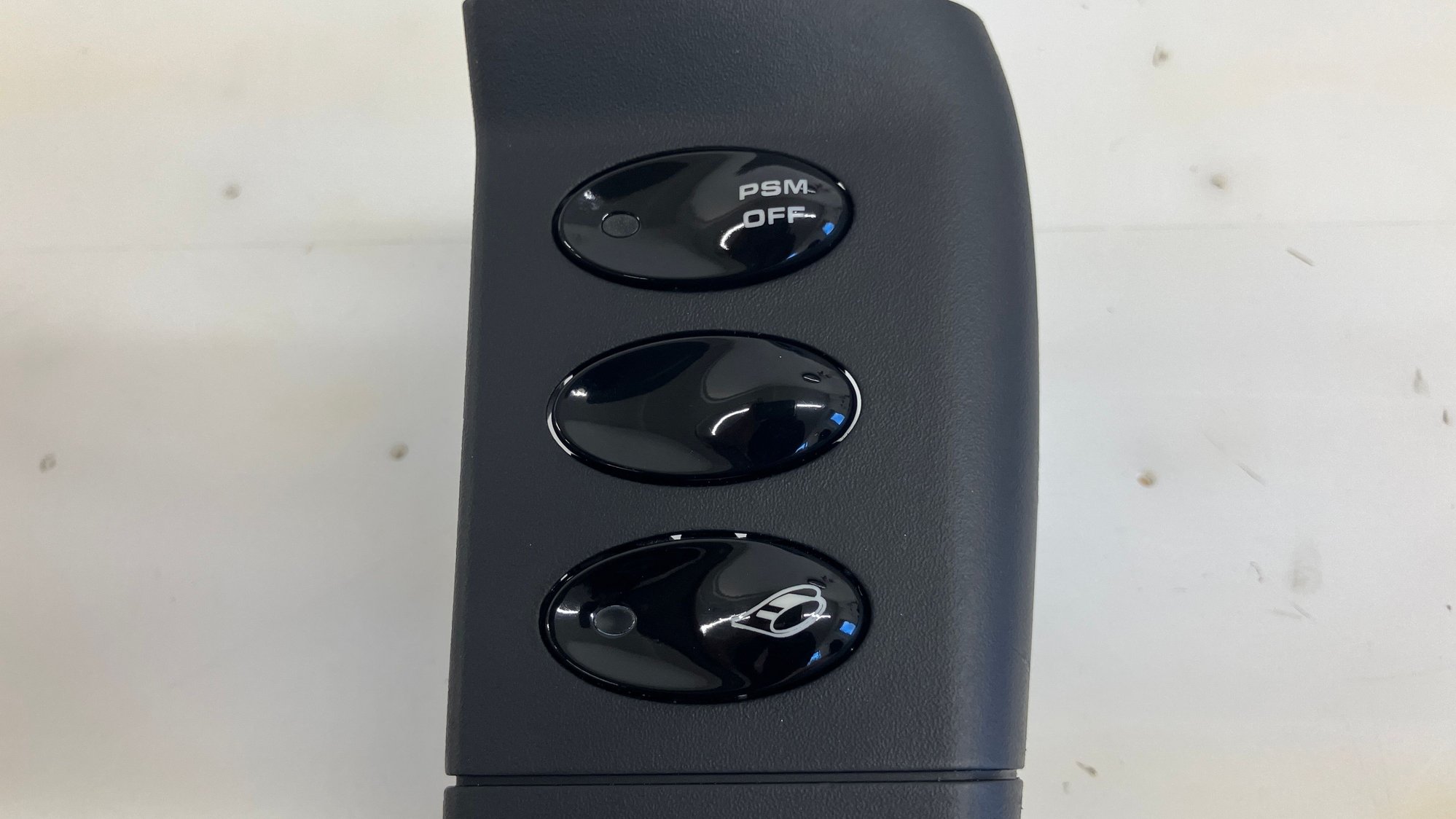

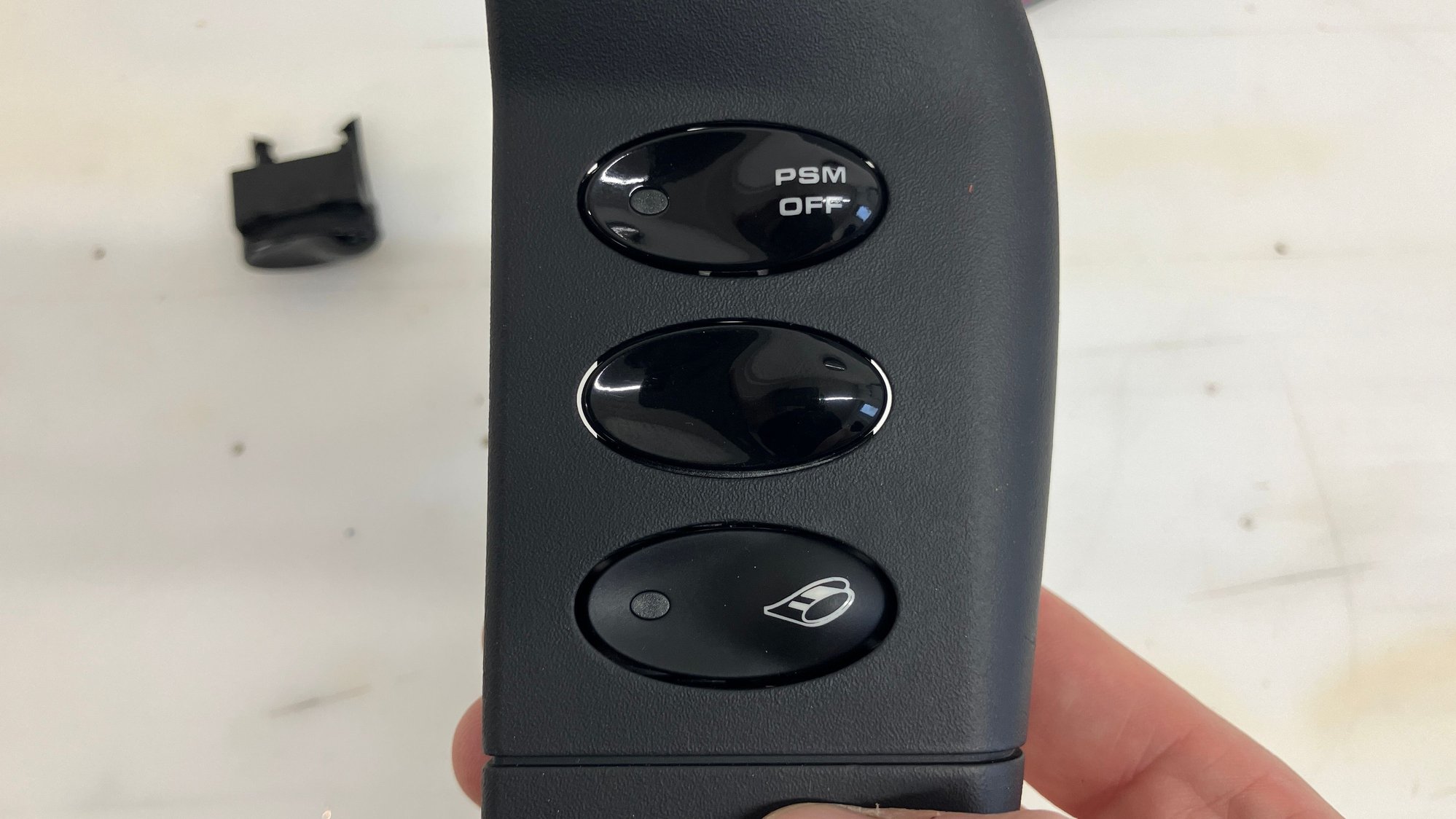

I didn't like the look of the matte finish switch in the early dash, so I airbrushed my with several light clear coats until I had enough to flat back and polish.
I labelled this picture I took before I reinstalled the carpet trim, in the hope that others find it useful.

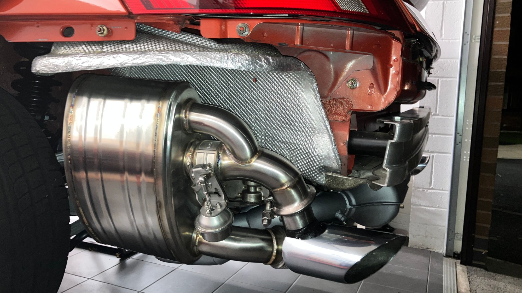

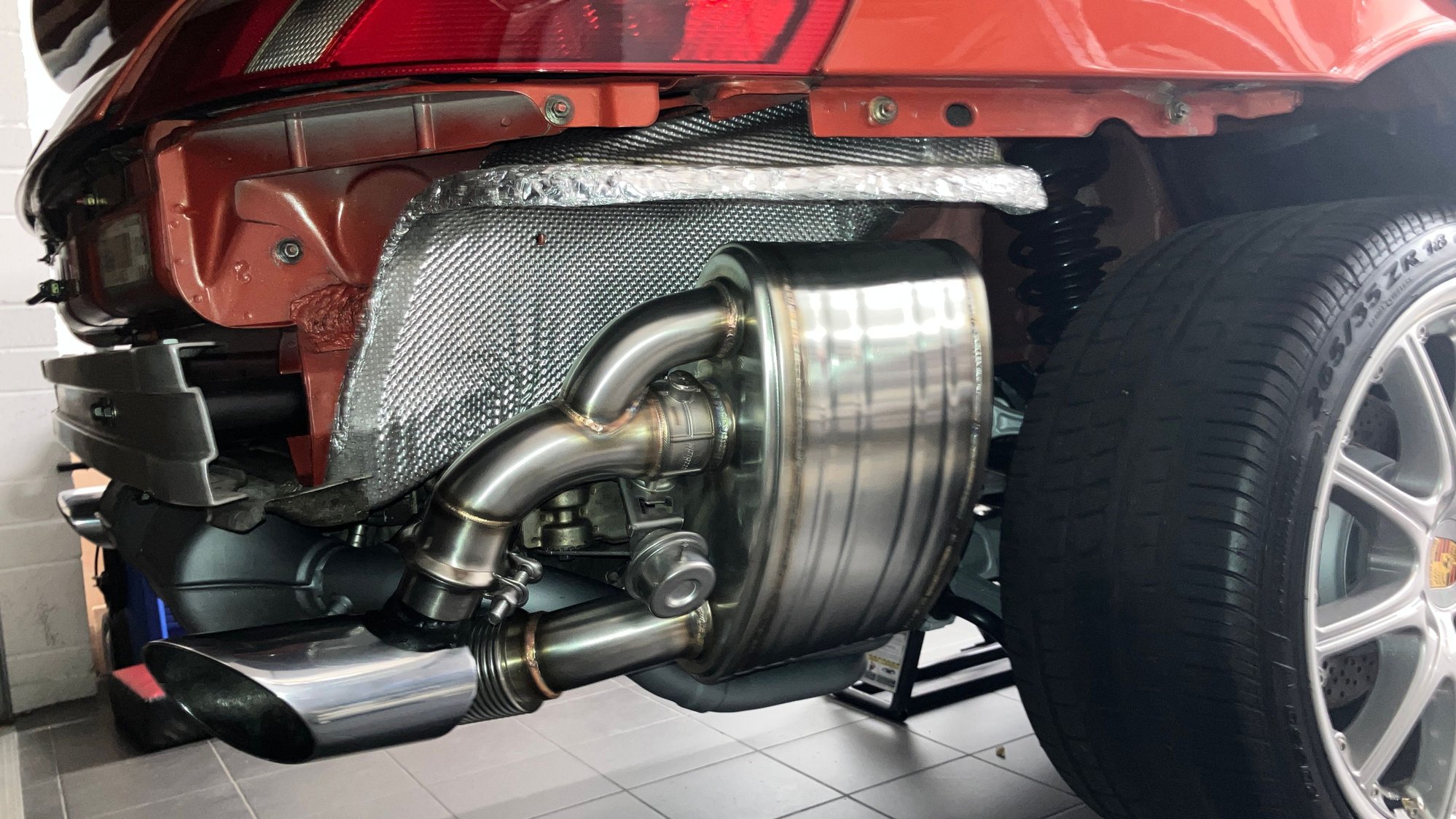

I replaced mine with the simply gorgeous Top Gear stainless items, however the fitment is the same. The silencers are interchangeable, as are the tips. The only difference is that due to the shape of the rear bumper on the 996.2, the tips protrude a slightly different amount, however the fitment and interchangeability is identical.
Remember to remove the pink and grey wire from the exhaust flap relay holder socket whilst you're in there, as this will disable the automated quiet mode between 30mph and 50mph.
