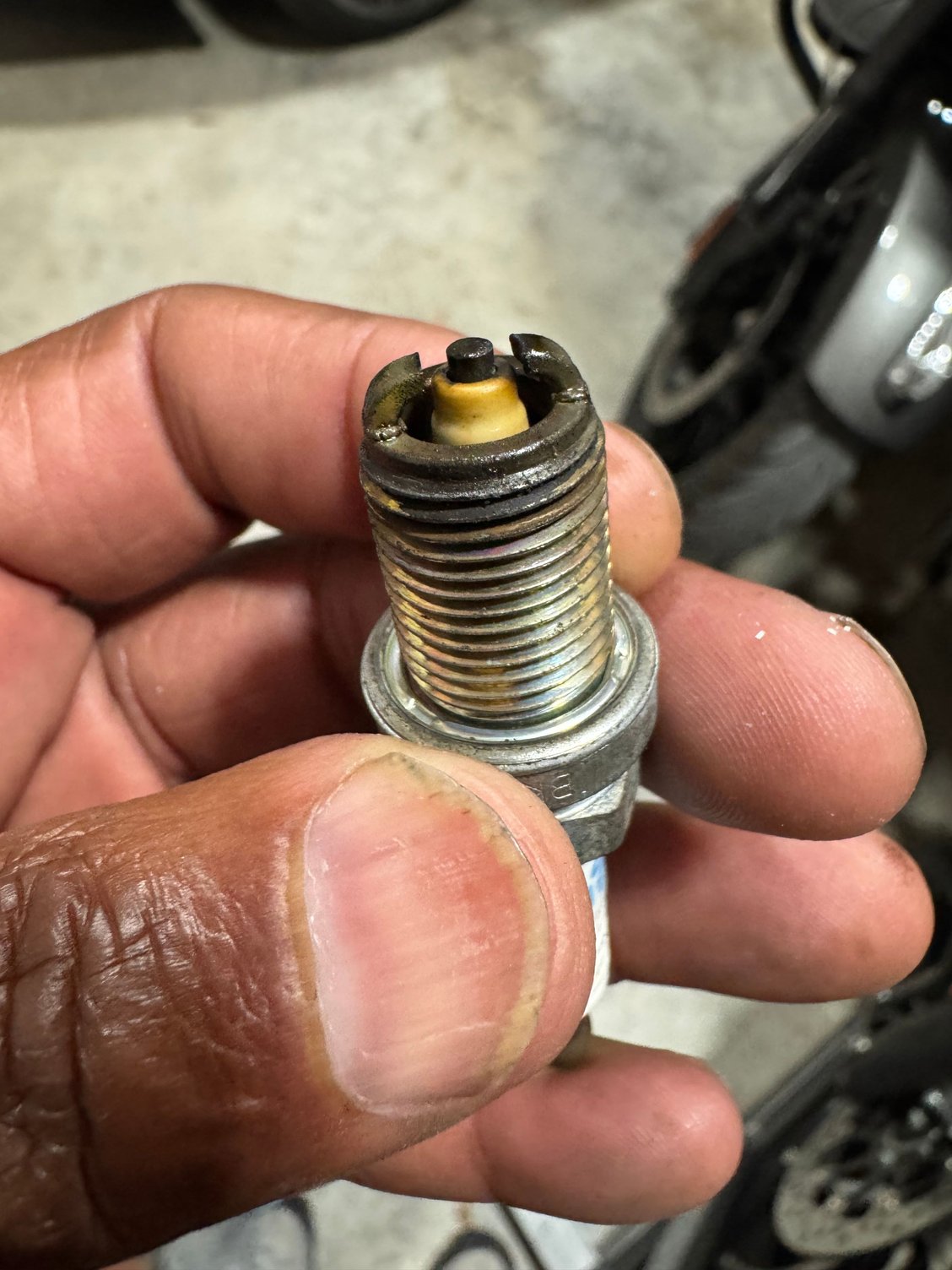

Originally Posted by 996love
Do you mind posting a photo of the spark plug you removed?
l will post it when I get home from work today.

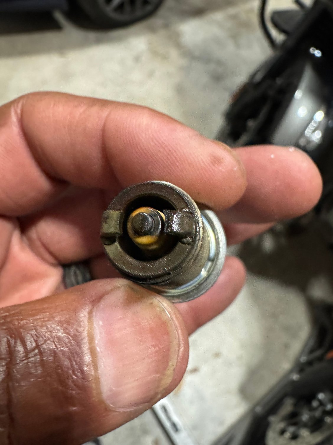

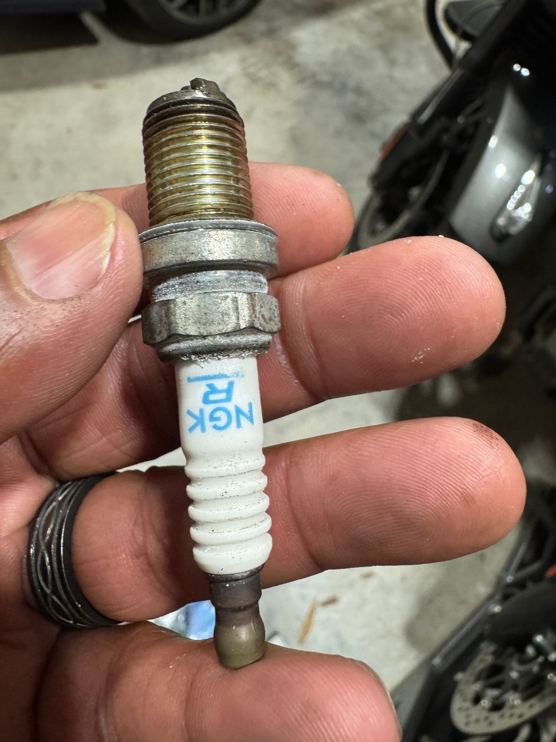

Thank you for the photographs! Before I condemn the injector, would you be willing to perform a compression test of the cylinder?
