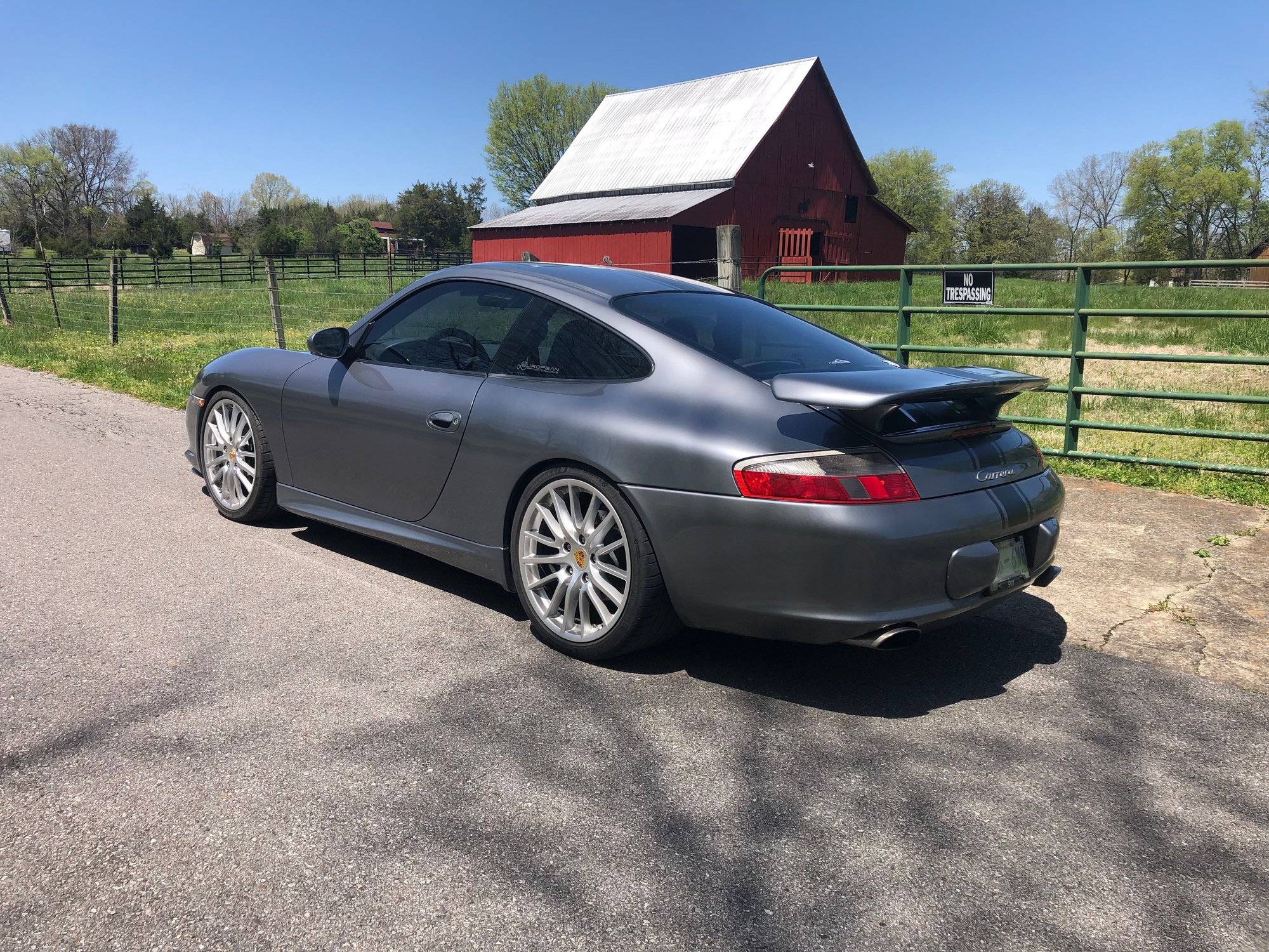

Still a new guy here and I did do some searches but nothing came up definitive for a fellow such as myself with extremely low intelligence.
Is there a guide for what trunks/engine covers/wings fit which models of 996 and how? I know the S's have the solid taillight....can a C2 or C4 be fitted with that? What about the cabrio's? Which wings/trunks will fit on that?
My specific Question is what options do I have to swap a different wing/trunk on my C4 cabrio. Can I buy a full turbo trunklid with power wing and bolt it on? If not, is there body differences, or can it be done with enough bolt on parts?
Thanks for any help, just trying to give my car a bit more flair. Gorgeous as is, I just always like something different.
Pic....because I wanted to make it more exciting. haha.

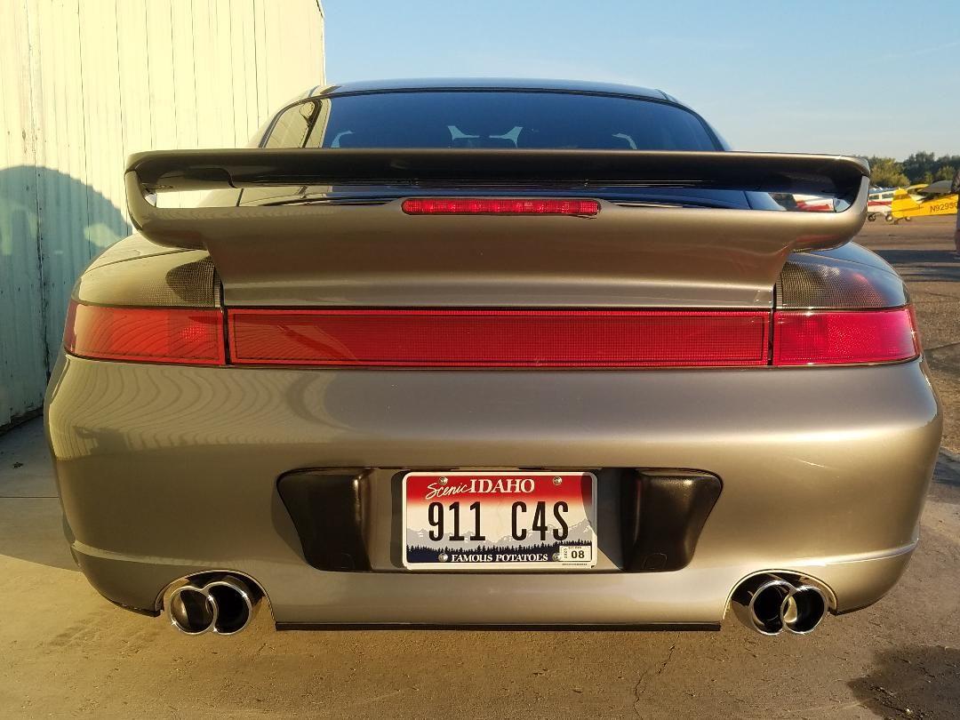

Just to be clear a C4S coupe rear lid is not the same dimensions as the Turbo. The Turbo lid is physically longer front to back and needs heavy modification to work on the C4S coupe. The Turbo lid will bolt right on to the C4S cab, but as been said air inlets are different.
That is my understanding as well that the C4S Coupe lids only fit C4S Coupes and nothing else. Thanks for clarifying the Turbo lid dimensions. It was my understanding that the lids were longer on the Turbos. I guess that Porsche decided to make the lids the same size on the Cabs and the Coupes.

The C4S cab and coupe are the only ones that are not interchangeable in the same model. I.E. C2, C4, GT3 all fit, not sure about Targa's. Turbo cab and coupe, fit each other. I went down this road a couple of years ago to upgrade my decklid. I really didn't like the fit of any aftermarket lids, so I went factory Aerokit. It took a couple of years to find a factory Aerokit decklid and I paid a lot for it, but it was worth it to me. I really need to get some better pictures.

This is not correct, turbo coupe decklid fits only turbo coupe. Turbo cab and C4S cab are interchangeable. C4S coupe fits only C4S.
Turbo coupe and C4S coupe have different size filler pieces under the rear window because turbo coupe does not have the center brake light there.
