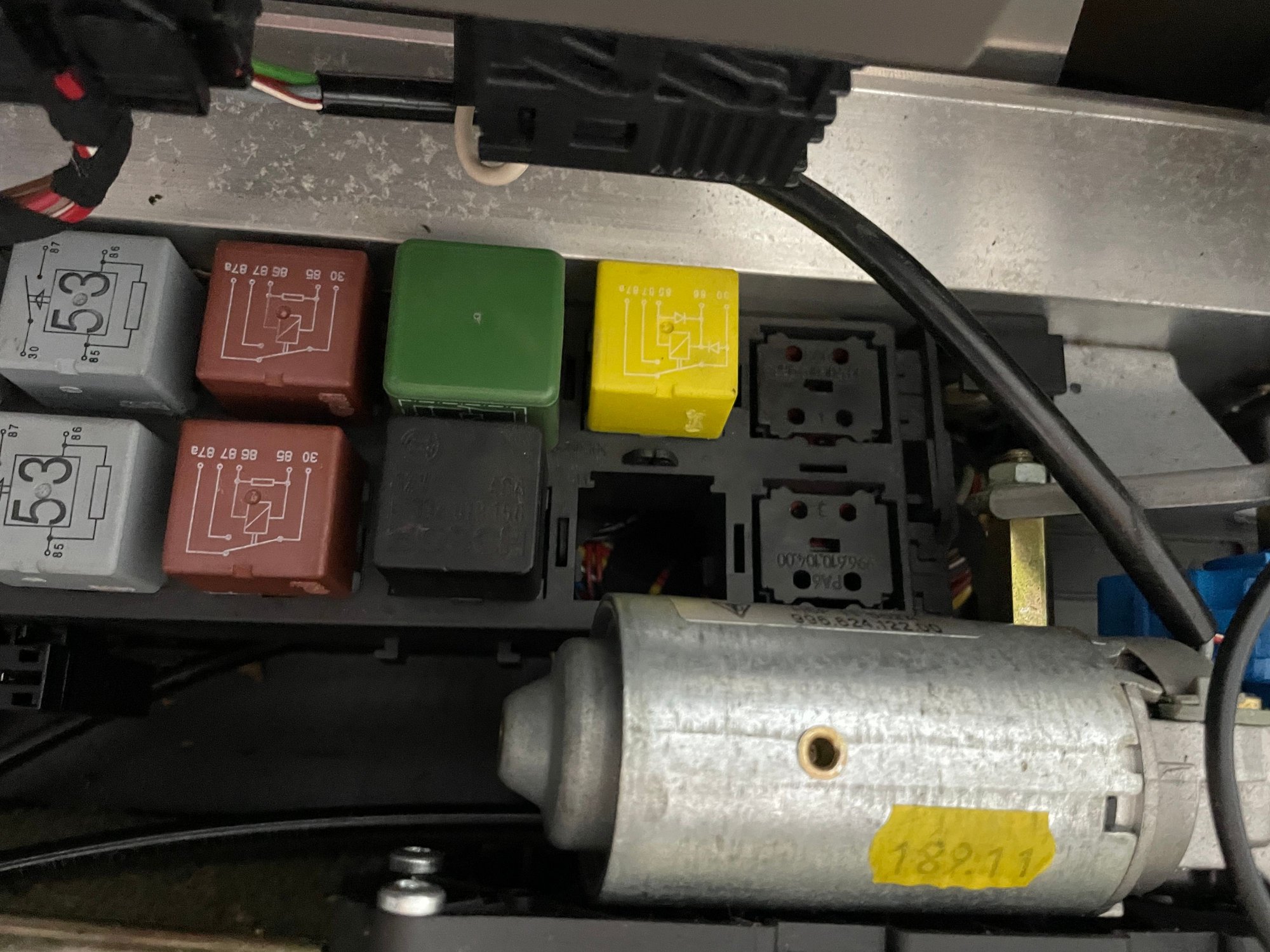

How do I access the “relay” in that top right location. How can I remove that cover thing?
I think I may have been probing the wrong location and I also want to give this relay jumper thing a good look.

Oh what fun. Had to get to the back of the relay panel to take a closer look. Which means moving the clamshell actuator and bracket out of the way.
2 busted knuckles later…. I’m actually not getting current to the relay location. I think my trans switch harness might need a closer look. Those contacts really seem to move around in that plug.

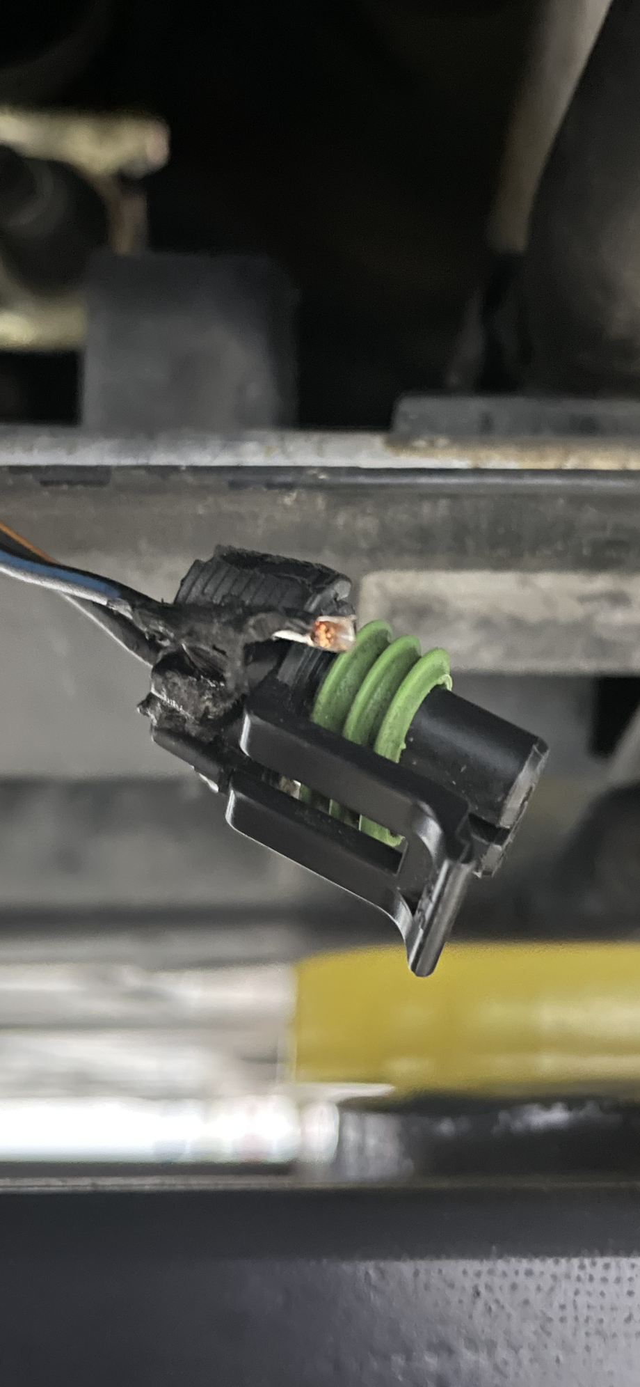

I have a broken contact/pin on the black with blue stripe wire at the transmission switch. which is the one that heads to the relay location.
Anyone know where I might find a new contact/pin to recrimp in this location?

It’s not really there anymore, but maybe you can tell from the back half of it?
I don’t want to pull the other one out because I’m worried it’s going to break too. I tried to pull it and it’s not really coming out easy. Surely there’s an extraction tool/method, but I don’t know what that is.

Thats a standard gm weatherpac connector. The can be usually be bought preassembled at any part store and u can just splice it in with some butt connectors
