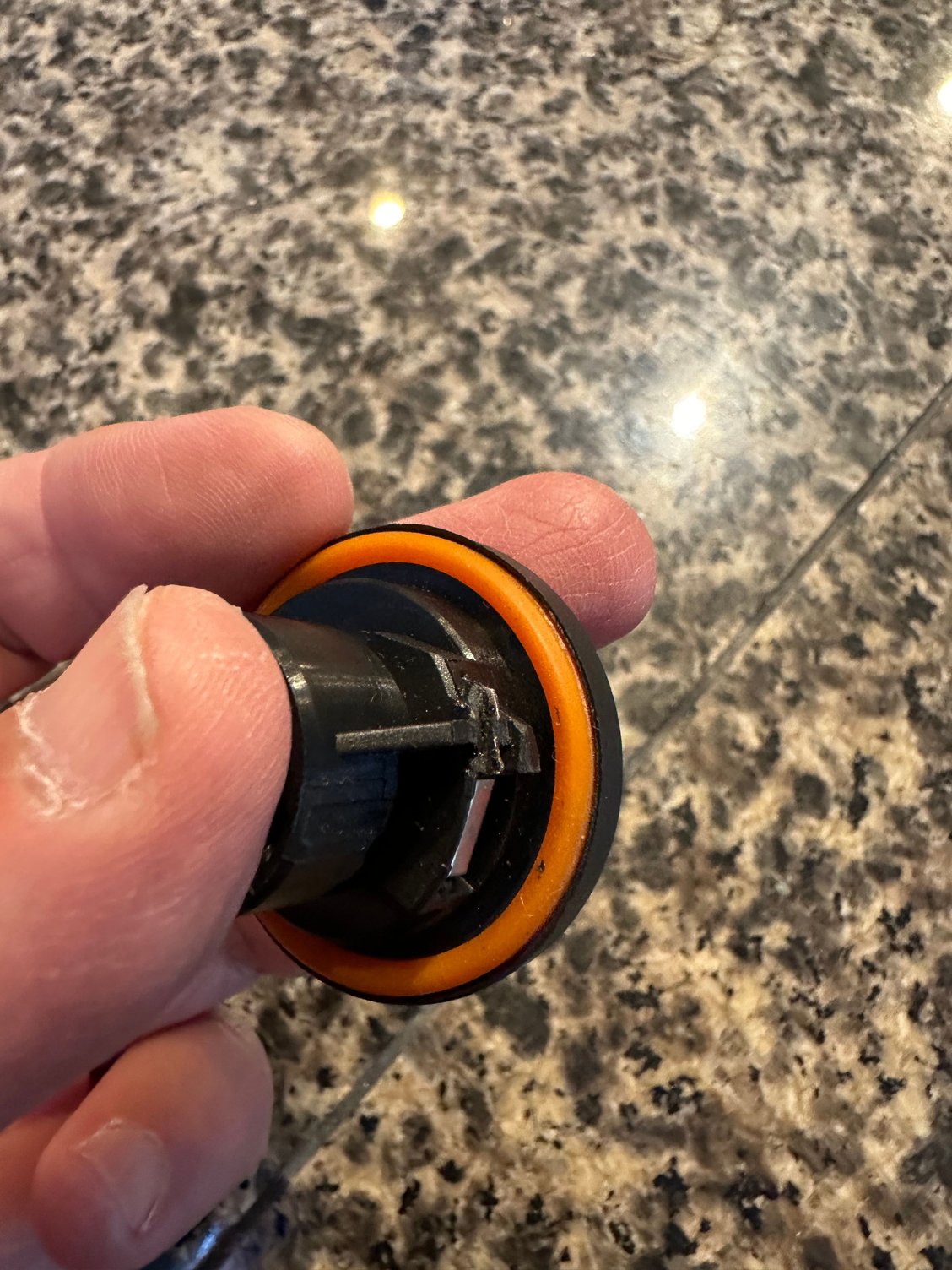

I know this is an old thread recently bumped, but I have been chasing this issue with my car. After some poking around with the volt meter, I found out that all of the wiring was fine, but the socket that the bulb sits in doesn't make great contact with the bulb. There is a metal flange in there that I had to bend out a bit to make it contact the bulb again, and that fixed the problem.

My passenger blinker had an issue when the bulb holder contact etched away a bit, and needed to be replaced….. perfect after that…..
