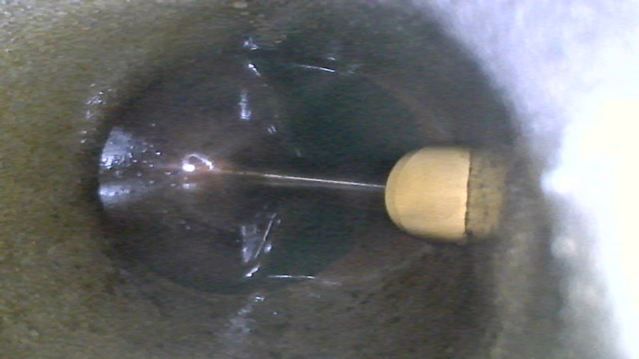

Why do you need an in intake valve cleaner?
Since our cars are port fuel injection, the injected fuel keeps the intake injectors pretty clean.
This is one of mine at 105k miles.
That said, I'm on the edge of my ignorance, so maybe I should be doing something else.

Jdbornem, your intakes look pretty clean. How many miles?
interesting to see your valves as i just scoped mine last week. 100k on the engine. Cylinder #2
Scoped at about 105k when I replaced the injectors. They all looked pretty much the same.
