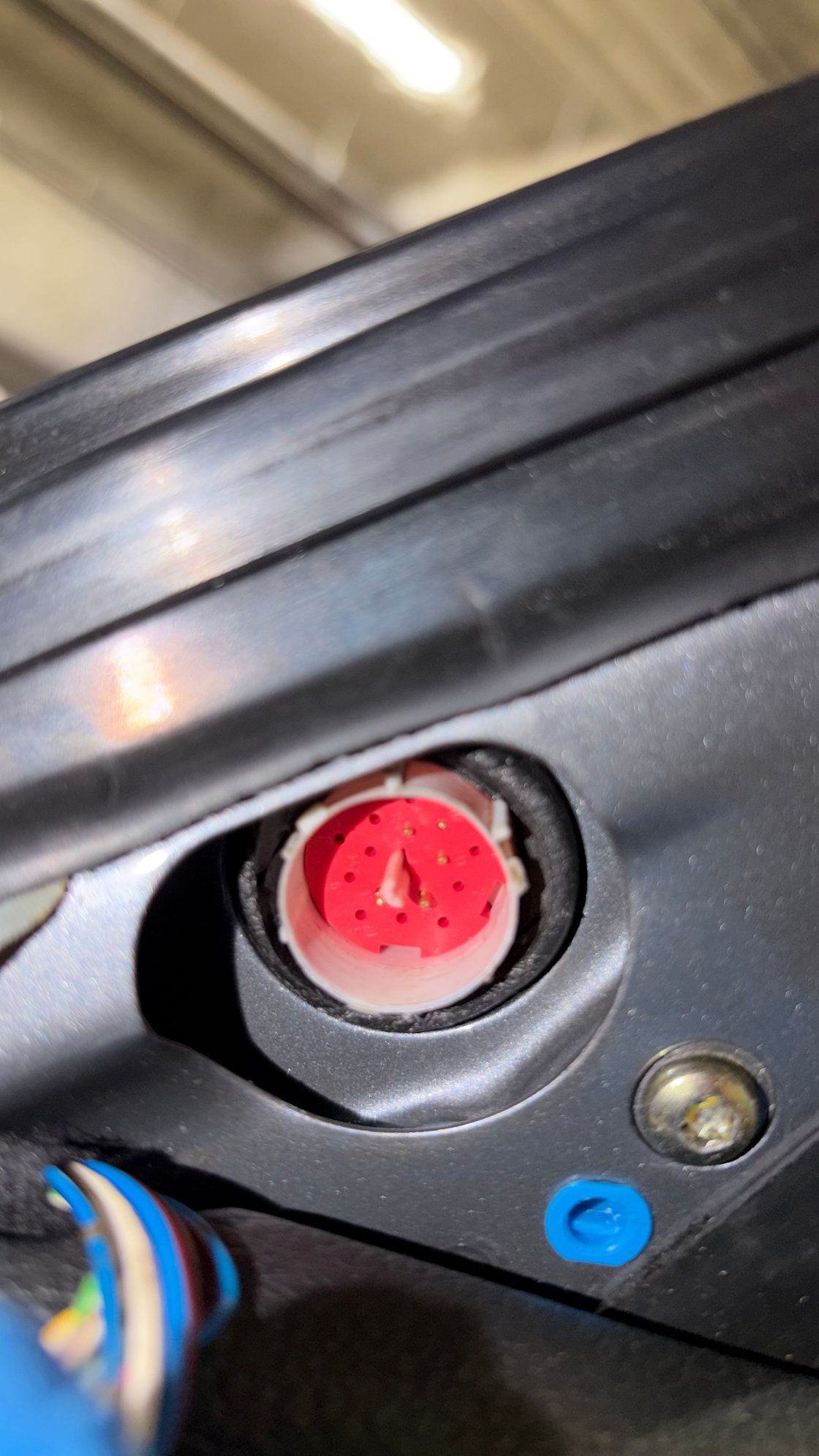

Hi, I just encountered this problem myself - passenger side mirror not moving at all.
I took off the interior 'triangle' trim and removed/replaced the cable. Then I got the mirror to work left/right, but not up/down. Do my pins look correct? The 3 on the upper right section seem a little 'recessed' into the socket.
If I need to replace either the male or female wiring, does anybody have the part numbers? How do you remove the mirror?
Thank you.
