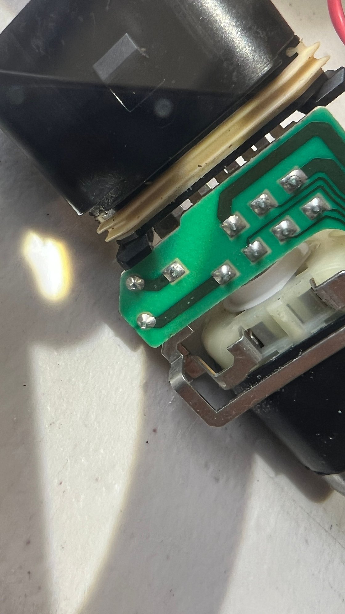

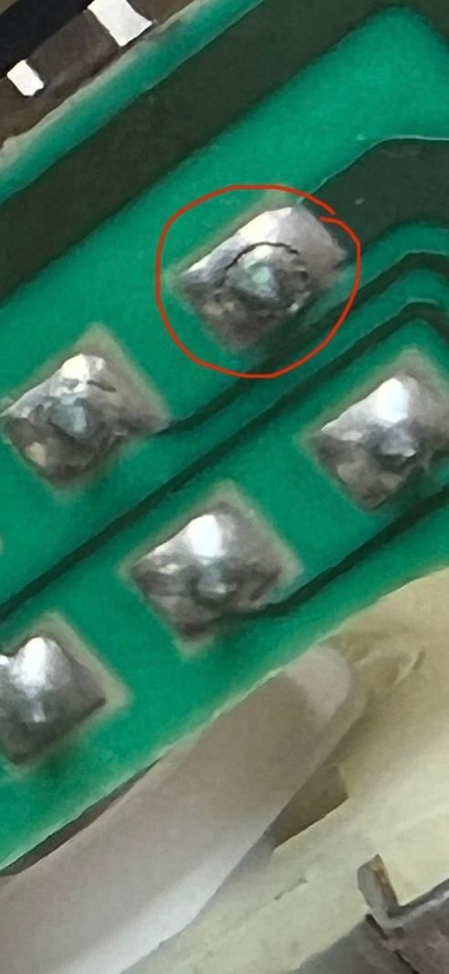

For those of us that like to “try it ourselves”. I took out the latch and found where the shirt was coming from.
if you look closely at the solder, you can see a hairline crack around it. Three of them were looking like this so I put some flux on it and it melted the solder puddle. Everything works as it should now.
