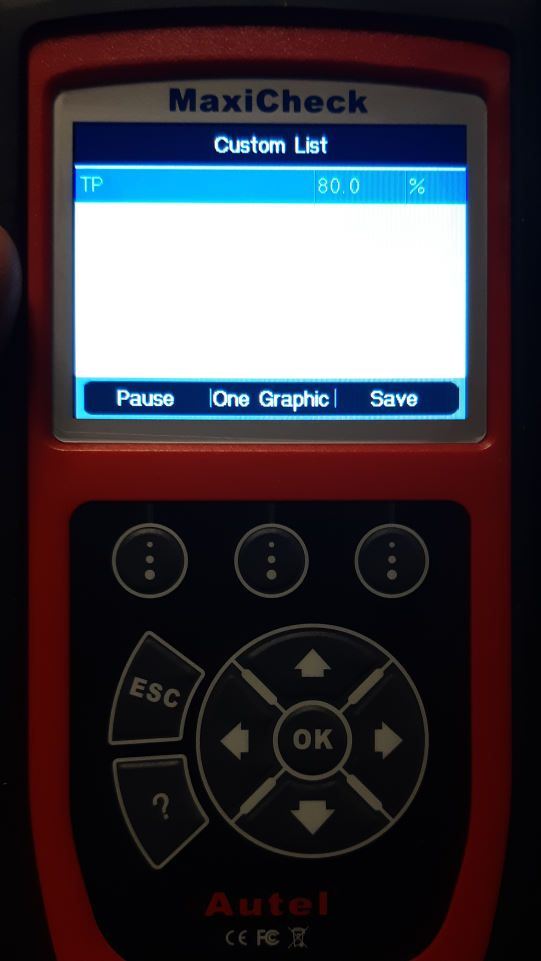

Socal, I tried my Autotel but didn't notice any camshaft position field, but I will try tomorrow with the engine running. I have a side question about my Throttle Position readings. Is it supposed to go from 0-100%? Mine only goes 0-80%, should I get excited and find I can replace TP sensor and get 20% more throttle? (Picture taken with accelerator to the floor) I will check this on the Durametric tomorrow also.
With the engine off and ignition on, the Foxwell read 'throttle plate angle' at 71% with the pedal to the floor. I'll check it again with the engine running.

It sounds like TP reading of 70-80% at full throttle (engine off) is correct.
I thought about seeing the TP% while the engine on, but then I thought against that.
(1) You don't want to trigger a stage 1 over rev event.
(2) You don't want to be driving and looking at the code reader.

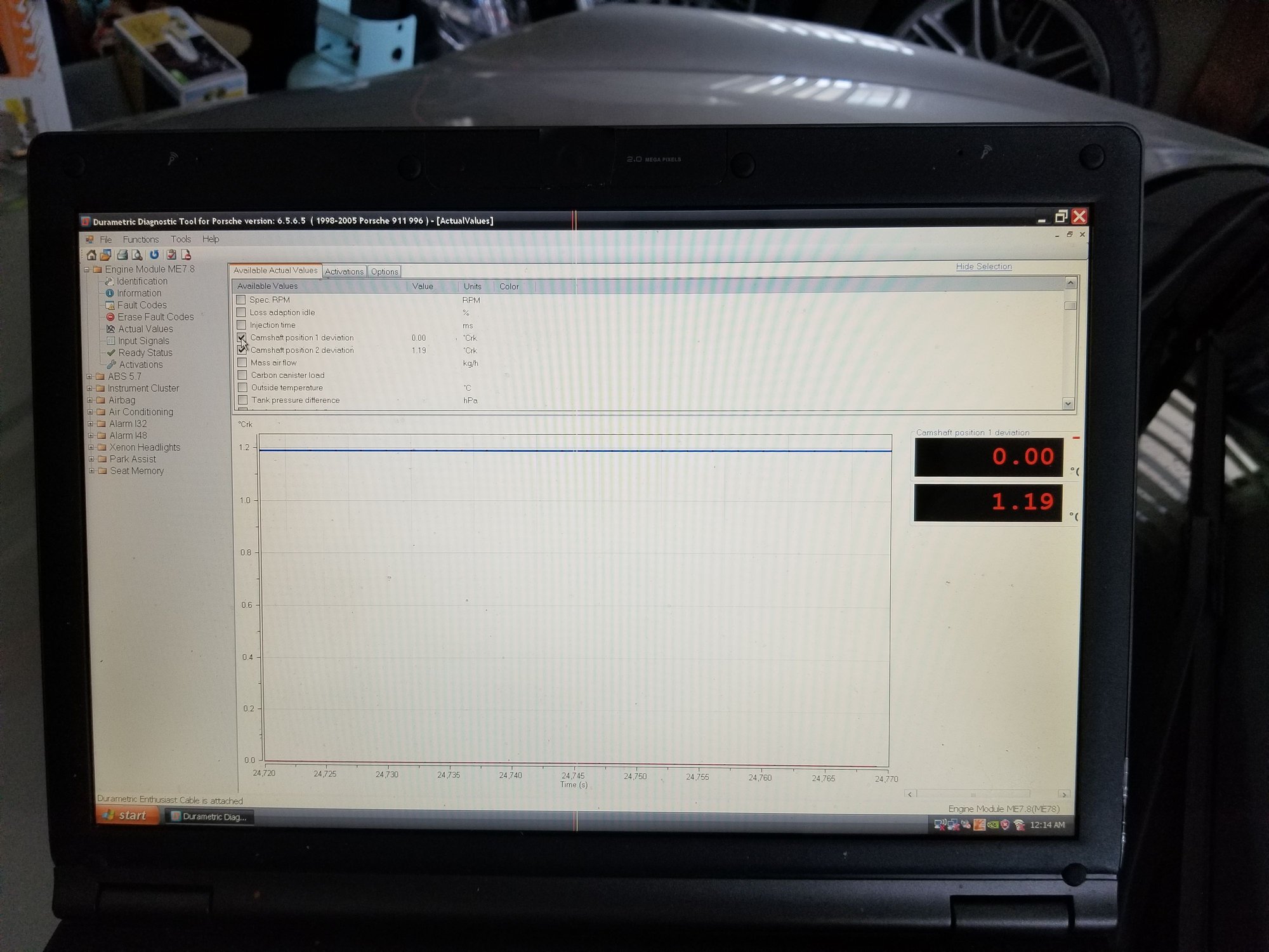

So I did the following to verify.
  • I checked with engine off.
  • I plugged my Durametric in.
  • I used a prybar to jam the accelerator pedal to the floor.
  • I placed my laptop on the car roof so I could see the screen while standing at the engine bay. The graph was plotting 81% constantly.
  • I used my finger at the throttle body to try and open it more but it would not open any further. The graph plot continued at 81%.

I have a weird problem. My Durametric appears not to be able to read camshaft deviation on bank 1. On Bank 2 the deviation is ~0.5 degrees on startup and then when the engine warms up it get to ~1.2 degree. The reading is steady irrespective of RPM, so I am guessing the reason it increases with temperature is because chain length may change a bit as the chain warms up. Either way, no issues on bank 2. However, bank 1 remaining at 0.00 suggests to me not a perfect timing, but that the software simply can't read bank 1 deviation. I have no camshaft position sensor issues and I can monitor Actual angle for inlet camshaft on bank 1 and 2. Anyone know why I can't read bank 1 camshaft deviation?
