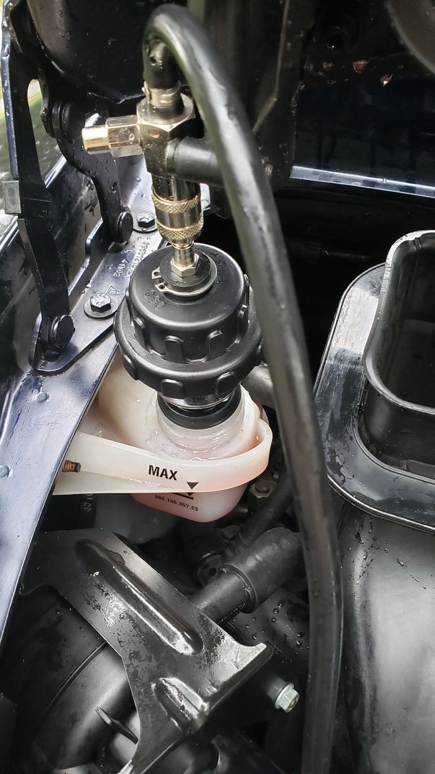

I borrowed this tool from NAPA today. Drove the car there and then it sat all day. When I pulled the cap off it still had a good bit of pressure that needed to be released. I would have preferred no pressure as it would point towards a leak.
I didn't attach the tool tight enough the first time & it popped off spraying coolant everywhere
Going to let this sit.
