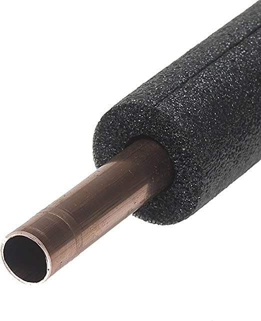

Originally Posted by jumpy chunky
Use tape on fender edge.
Pipe insulation foam works well too. The ones for 3/4" copper pipe seem to work best on the 996 fender lip.
It stays on pretty well by itself but you can use a little painters tape for extra insurance.
