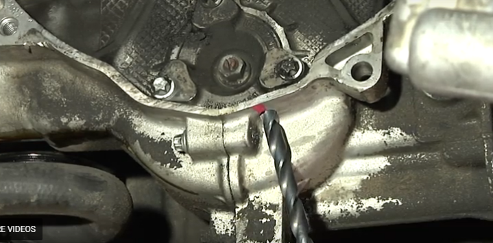

Installing the IMS Solution involves drilling the edge of the engine case for the oil feed line - it doesn't use an existing hole. You _could_ drill one yourself...
Originally Posted by DSC800
Interesting. Maybe no room to see the bearing cover straight on, but if LN can run an 3/8" oil feed line in to the bearing cover then certainly a scope camera half the diameter would easily fit.
