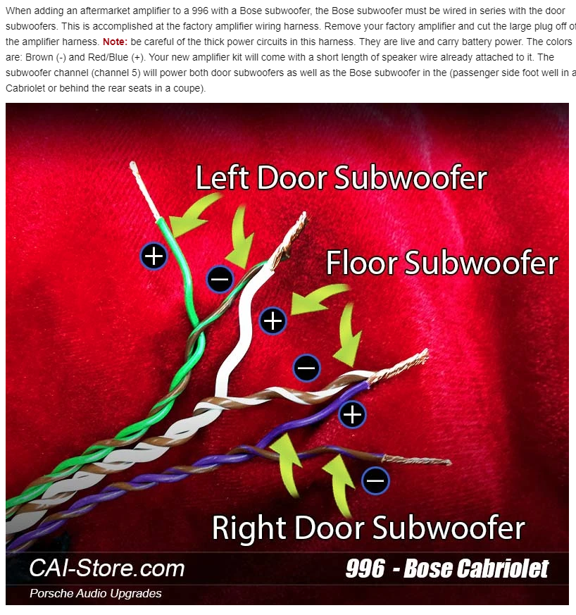

I'm thinking that I'm going to pull the trigger and just replace the amp. This will allow for me to get rid of the MOST connection issue and hopefully will also get rid of the alternator noise that is going through the speakers. I plan on using shielded RCA and speaker wire for this and getting a 5 channel amp. From what I've read, you can combine the cables for the door speakers and the sub which will allow the 5 channel to power all the speakers. These instructions are from the CAI-Store regarding this set up...
Anyone try this???
Anyone try this???
I don't think this is what I did. Not sure because of the reference to "floor" subwoofer, which sounds like something other than the Bose two 10" bandpass unit that comes as part of the Bose speaker package, that I have Someone with personal experience will likely check in, because that mod is not uncommon. The resistance issue is addressed there in a slightly different fashion, I believe. Regardless, you use a 5 channel amp. The tweeter/mid units in the top of the dashboard have their own crossovers, so you only need one channel for each. Strike my reference to needing "three pairs" for the front, in an earlier post. I wasn't crazy about the idea of sticking a sub either behind a front seat or in the passenger footwell, which seem to be the choices (and seem to be what is shown above, wiring-wise). Plus, I needed to be persuaded that the "stock" Bose rear unit is incapable of producing acceptable bass tones, given the right signal, before I got rid of it. AS previously mentioned, that unit works just fine for me. One more slightly technical point. If my assumptions are correct, the ported front door speakers described above must share a sub-woofer signal with a sub located somewhere in the car. Sub signals have very limited frequency ranges, and aren't stereo, IINM. My front door speakers have their own, stereo signals, EQ'd for low and mid-range sounds.
Old Feb 19, 2020 | 04:23 PM

Because I couldn't recall the specifics of my switch (almost 4 years ago), I pulled out the file, which includes some stuff from the internet related to the project, and I want to confirm/correct some items. First, I was really surprised to see that the power amp is apparently a Bose product, according to two items from the internet. I guess this makes sense, given that the woofers (only one for a convertible, apparently) run on one ohm of resistance. This is very unusual and one of the challenges in converting. The photo above maybe was from an installation in a convertible? The two sub drivers in a coupe are 5 1/4", FWIW.

The floor sub is in the Cab,, Not the Coupe.. They are different.
Whatever you do make sure the amp is a HIGH current amp,, Rated for low resistance speakers.
Bose speakers use current to pump the woofers. they are great IF you get enough power to them.
The 2003 is a one hit wonder, From what I can find you need the Cayenne adapter for the 2003.

^ What he said. The Porsche drivers are very low resistance; you need a 2-ohm-stable amp. I used an Alpine PDX-5 to drive the factory speakers in my 986.
