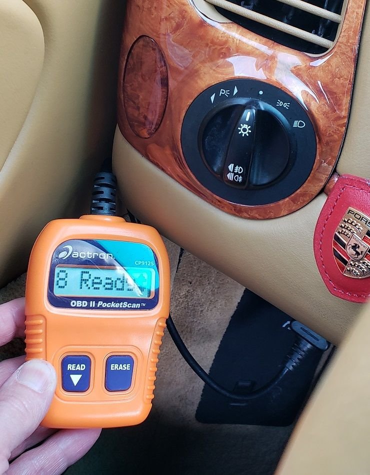

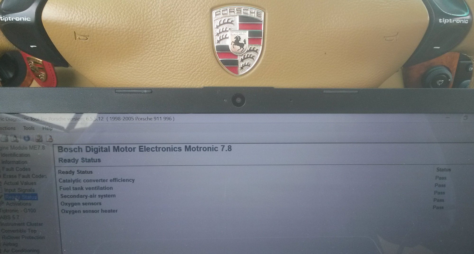

Durametric shows 5 readiness monitors, Actron 8. Don't know if Actron displays some not needed for smog check, if Dura missing a few, or if Dura has them and must look on another page. They use different terminology, and wish had checked NT530 before sent back to help determine if Dura missing some monitors.
Actron - - - - - - Durametric
Catalyst - - - - - Catalytic converter efficiency
Sec Air - - - - - - Secondary Air System
O2 Snsr - - - - - Oxygen Sensor
O2 HTR - - - - - Oxygen Sensor heater
Evap - - - - - - - Fuel tank ventilation (this Dura reading might match with "Fuel" Actron)
Misfire - - - - - - ???
Fuel - - - - - - - ???
Comp - - - - - - ???
Readiness monitors used to determine if pass or fail a smog check, not to show individual values such as number of misfires.
Difference in number of monitors between these two tools again shows none seem to perform all functions, and unfortunately owners must purchase two or more.
