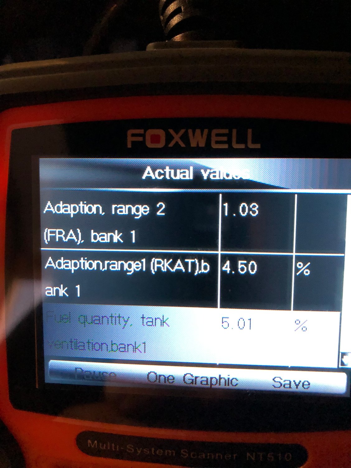

That's a good question that I don't have an answer to. I've been using my Foxwell scanner since it is more convenient than dragging out the computer.
The Foxwell shows it as adaptation, range 1 or 2 with FRA and RKAT in parentheses:
