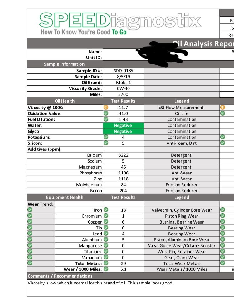

5700 miles after IMSB retrofit/RMS replacement. Plan on oil changes every 6 months or 5k miles with UOA each time. No complaints with this report.
