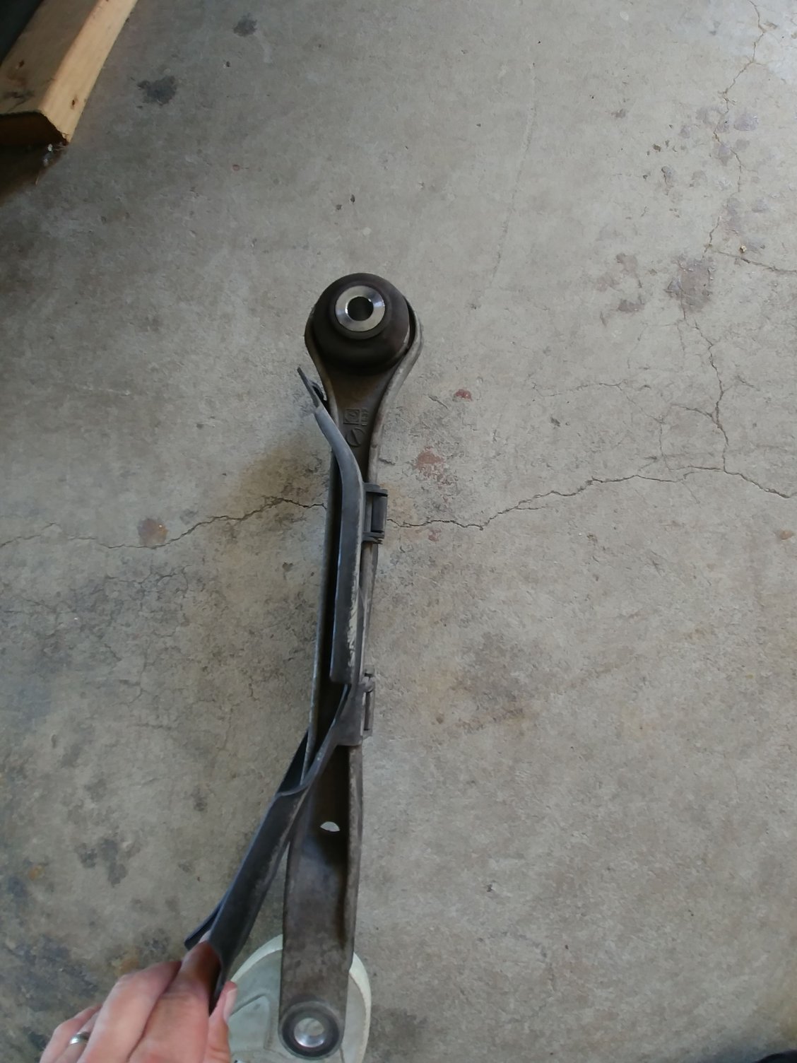

I'm chasing the source of my front end clunk going over bumps at any speed. The tie rods appear to be good. Just replaced wheel bearings, strut assemblies, sway bar links, and main control arms. I suspect these diagonal control arms. I removed the driver side arm. The rubber is very malleable and dry. Question is how malleable is it supposed to be? Car has 73,500 miles.

So, I have a better understanding of how these work. The rubber just protects the ball joint inside. I placed the joint in my vice and applied hand pressure to the joint. It did not move axially. Do I dare say it's good?

At 73k and ~15 years it's a good bet it's shot. I'd replace. Any play in that ball joint will translate to nasty clunks in the car. BTDT. 1/32" is enough to sound terrible.

You are probably right. I should just replace them. I have since buttoned everything back up, and I went out for a test drive. I can sometimes feel the movement under my feet through the floorboard.

Just be aware that those parts are fundamentally different than the stock parts. Stock is a ball joint; those EPS parts are an elastomer bushing. So they change the effective spring rate of the car, and put stresses on things differently than the original design. Not necessarily good or bad, but something to think about before changing.

. The unfortunate reality is that there doesn't seem to be a replacement part available for just the portion that fails.

I had a front end “clunk” in my 2003 cab also (76,000 miles). Replacing both those arms fixed it.
